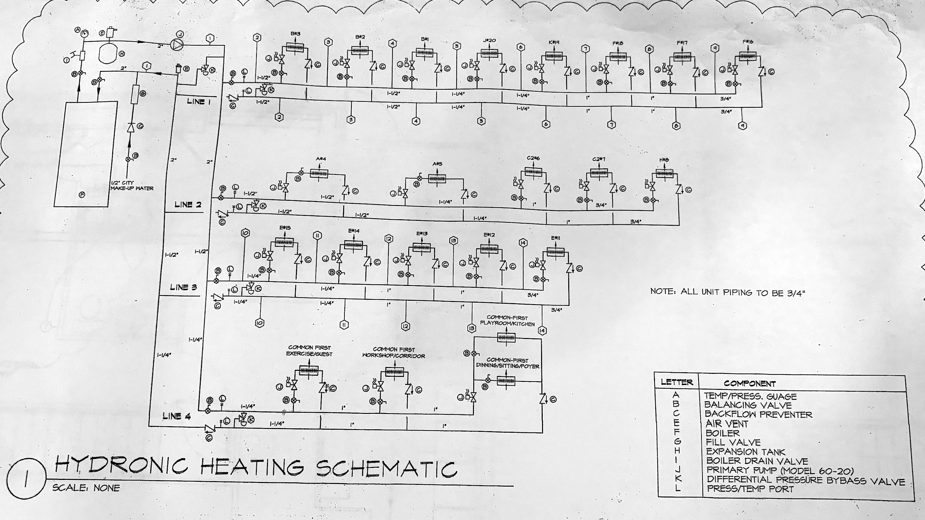

I'm part of a 20-unit multifamily building with a hydronic system built in 2000, and I'm trying to figure out how to reduce our gas bills. For example, we spent $3300 for 1050 therms for space heating between Jan 15 and Feb 15, despite having well-insulated townhouse-style homes that get a fair bit of solar gain and mild weather (rarely colder than 40F). Interested in thoughts on my wacky researched-it-myself ideas before I try to find somebody who might be willing to work with me on implementing them.
Context: We have a conventional gas boiler (SuperHot AAE-960), a fixed-speed circulator that runs continuously, and 23 zones. We have a Tekmar 256 outdoor reset controller configured to provide a permanent demand to the boiler, set to minimum boiler temperature 140F (minimum necessary for conventional boiler), on auto-differential.
The system seems to have an inefficient concept of operations: the controller has no knowledge about whether any zones are calling for heat. If the weather is below the warm-weather shutdown temperature, the Tekmar tells the boiler to keep the water at least at 140F, whether or not anyone needs it. So the circulator keeps circulating the water, the water cools along the way, and the boiler reheats it, just in case anyone needs heat. Maybe nobody does!
Unfortunately, it does not seem feasible to wire all the zone valves to connect them to a boiler controller - too much distance, too many walls and floors. It'd probably help to replace the circulator with a variable-speed one, but this one is only 2.5 years old, so we're hoping to get more years out of it before we replace it. Interested in other options in the meantime.
I'm planning to add a timer switch (Tekmar 033 or equivalent) to enable the Tekmar 256 to at least have "unoccupied" setback temperatures at hours that typically have low demand, such as 2-4 am and 2-4 pm.
Here's my question: could it make sense to try to find somebody to put in a flow switch that triggers based on whether zone valves are open, configured so that the boiler only turns on if at least one zone valve is open? I haven't seen examples of systems like this, so I'm wondering if I'm missing something in my research or if this is a bad idea. Thank you!

    One circulator! Attached a diagram for you. Fun fact: line 4 is never used, because the common spaces have sufficient solar gain to warm them up.
    This is in the San Francisco Bay Area with a mild Mediterranean climate. My unit rarely needs more than an hour of heat even on cold days.
    I agree that it's wasteful to circulate water when not needed, but I'm not sure there's a better option until we can replace the circulator with something more modern. For example, we had a power outage the other day, so I went and switched off the boiler and circulator so that I could monitor restart. When I switched the circulator back on, it had some weird chk chk chk type noises along with the usual noises for a while. It's a big circulator. Seems less risky to just let it run.

    With the 5 Differential Pressure Bypass Valves (item "K" on the drawing) seeing flow changes in the boiler room may be difficult.

    That main circ is probably about 1.5kW running 24/7. I think replacing that with an ECM unit is an easy cost save that is not intrusive.
    The boiler is definitely short cycling, a buffer tank would help just not sure if it would save enough money to justify the work.

    You could put a flow switch on each heating loop branch after the differential bypass valve (marked K on the drawing). The flow switch would only now activate if there is a zone on that branch is calling for heat. This would get you a demand signal.
    The other option is to use the return water temp as a demand signal. You can generate this by puting an aquastat and delay timer on the return water. The idea here is to set the aquastat a bit above the temperature you expect when there are zones calling for heat. If the zones shut off, the return temperature rises triggering the aquastat. This now starts a timer that keeps the boiler off for say 2h. This is pretty simple to install and set up and should see pretty quick return.
    The nice part about this is that it will force the zones to synchronize as more zones will eventually be calling during the off period but since there is no heat, they will stay on together. This extra load at the same time will also reduce the short cycling during the shoulder season. Thinking about this, you might want to have a programmed off period even in the winter just to do this.
    If your emitters are also as oversized as the boiler you can also adjust the reset curve. There is no reason to make 180F water when cold if 150F will heat the place.

    In summary, here's what I'm thinking for boiler control - curious if I misinterpreted anything.
    Low investment, low reliability: use return temperature as demand signal
    Seems like this could be done with non-invasive methods that would be easy to undo if not working as expected, so I could probably roll my own:
    1. Configure the Tekmar "unoccupied" setback as low as it can go.
    2. Set up a pipe-mounted temperature controller on the return pipe.
    3. Determine the return temperature when all the zone valves are closed (nobody is calling for heat), and determine the return temperature when at least one unit has a zone valve open and is absorbing some heat. (Not necessarily easy, would need some monitoring and adjustment.)
    4. When the return temperature is above the threshold, the temperature controller would activate a timer relay, which would then activate the "unoccupied" setback state on the Tekmar for a certain amount of time (try 1 hour, see if we can extend that without compromising comfort).
    5. When the setback expires, the boiler heats up to check for demand. If no demand, the process activates again.
    Higher investment, higher reliability: separate the supply temp from the boiler temp
    This would be a longer-term plan that requires professional analysis and installation, probably suitable to consider when we're ready to replace the circulator. Currently the boiler has to heat water to 140F or more and send it to the radiators, even if 120F could do the job. So we could look at separating that primary circuit (which has to stay at 140F+) from a secondary circuit capable of providing a lower temperature to the radiators, and configure outdoor reset on the secondary circuit. Could do this with the help of a mixing valve and a Tekmar 360, possibly with a hydraulic separator between the circuits.
    I think your assumption that you need no heat is incorrect, i think that most of the time the load is so low that the piping essentially acts as radiant heating to heat the building. i suspect the bottom of your odr curve is far lower than 120.
    with no rwt protection on the boiler you have to fire the boiler enough to heat it and the water enough to keep it above the condensation point. when you are heating the mass of all the water in the system to that point you are adding more heat than you need to the system and it overshoots. i think it is very likely the system and boiler are very oversized.
    your first option is essentially a complicated way of adding a delay timer that requires a certain off time to reduce short cycling. it may work or it may cause temp swings that are too great when it is colder out. the rw temp will fall over time regardless of if there is any heat calls or not, it will just fall faster if there are heat calls so unless you control does calculus measuring the rwt won't tell you anything other than you need to fire the boiler to keep the system hot.
