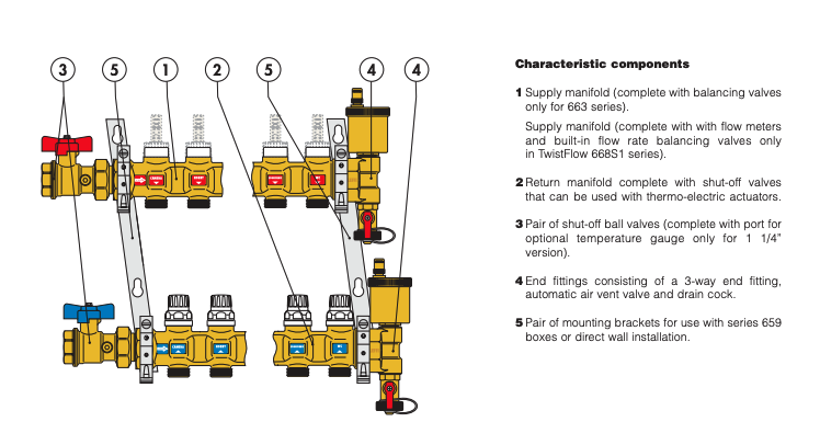

I am building new with in slab pex, staple up, and an air handler for those few weeks of air conditioning. The air handler can also supplement the radiant heating.
The heat source is a GSHP from horizontal loops.
I have looked at several options for manifolds and loop valving and the Caleffi twistflow manifolds with the standard thermoelectric actuators seem to be a solid product.
Are there any other suggestions for that part of the hardware?

  • Ironman
    Ironman Member Posts: 7,713
    You find any better than Caleffi and that’s reflected in the cost.
    We have used the Watts/Rehau for several years as well as Uponor with good results.
    Bob Boan

    Caleffi has radiant manifolds with an included pump; the price is very competitive. Maybe one of these for your staple-up.

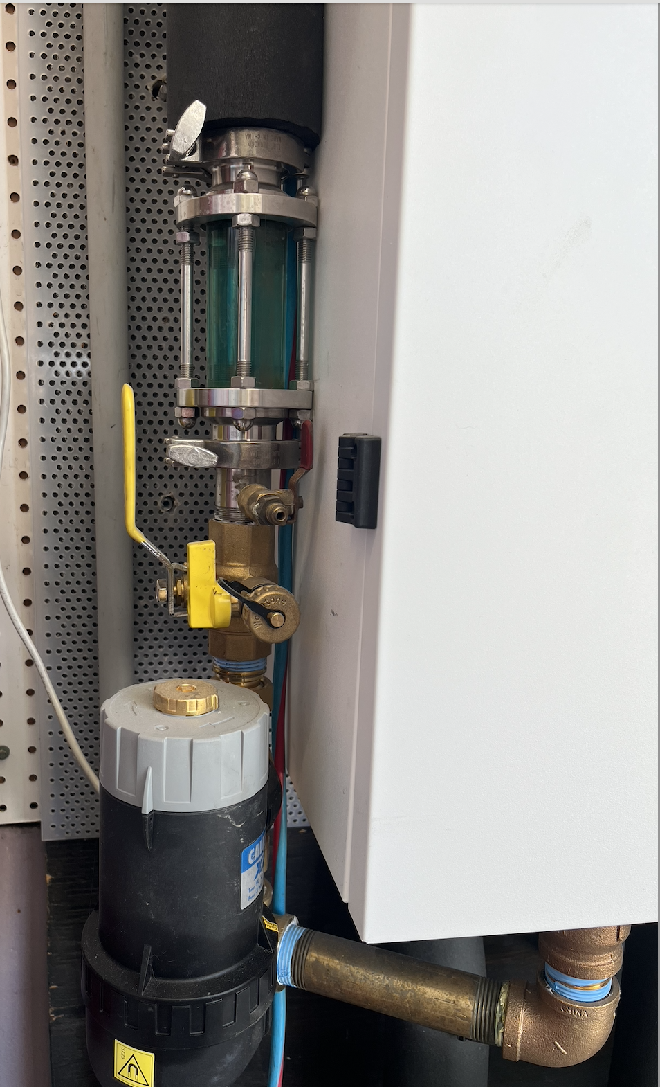

    hot_rod Member Posts: 24,935
    Pretty much any manifold that accepts actuators and also has flow meters give you two way to shut off, or balance flow.
    On the actuator side you can adjust with the white plastic knob. Also on the flow indicators you twist them to adjust flow.
    If you keep the fluid clear you can observe flow in the clear plastic indicators.
    Some pics of the cut away to see those valves.
    Screenshot 2025-04-18 at 4.29.01 PM.png Screenshot 2025-04-18 at 4.29.22 PM.png

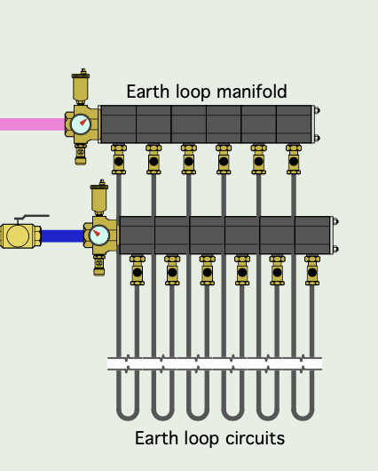

    Screenshot 2025-04-21 at 11.44.15 AM.png Screenshot 2025-04-21 at 11.44.57 AM.png Screenshot 2025-04-21 at 11.45.08 AM.png
    ethicalpaulskyking1

    what about another air sep at that 2nd floor manifold? That way I am not trying to push air down 15' of head change.
    mattmia2 Member Posts: 12,497
    The air should be mostly small bubbles that flow with the fluid after you purge it. The microbubble separator if applied at the highest temp and lowest pressure point will deaerate the water so that it will tend to absorb air from larger pockets when they cool and bring it back to the air separator at the heat source where it will tend to come out of solution and be removed by the air separator.
    Since the valve in the air separator tends to eventually get dirt in it or wear and leak, it is better to have it at the boiler where that will be noticed and it can be repaired or replaced.
    skyking1

    A manifold on the 2nd floor will make bleeding much easier especially if the manifold is above the heat loop it serves. Try to get something with auto air vents as it will take a while to get all the air out. I have an air separator on my 3rd floor manifold and don't find that it does enough. The air still collects in the manifolds (which is fine with the auto air vents).
    Sketch up the system diagram you are looking at including some of the rough flow rates you calculate. 1" pex can move a lot of BTU, unlikely you will need that much for the 2nd floor.
    Think about which areas you actually need control on and which areas can be always on. For example, my bath and kitchen floor heat plus towel warmers are always on. No thermostat, just the outdoor reset of the heat pump.
    When using water for cooling, you want to minimize the amount of piping that will run chilled water. I would try to place the FCU right on the primary loop. If it is big enough you don't even need to plumb it onto the buffer tank as it should be enough load on its own. You might need a 3 way valve to select it and disconnect the reset of the heat during the cooling season.
    I would not try to run the FCU for supplemental heat unless it has a heat strip. Dual temp setup with heat pumps is never efficient, if you do run the FCU, it should take in whatever water your floor heat uses and boost it up to a reasonable temp with the strip heater.

    With a two pipe buffer, single temperature system you should only need a boiler pump, and the distribution pump. A 3rd if you run an indirect. With a zoned system an ECM delta P circ is my suggestion.
    Screenshot 2025-04-22 at 11.23.22 AM.png Screenshot 2025-04-22 at 11.14.49 AM.png
    skyking1
  • skyking1
    skyking1 Member Posts: 37
    "ODR and constrained ∆ are at odds with one another"
    I was seeing that developing. Thank you Bob.
    If I plan on closing that upstairs manifold when not needed, The Pressure regulated secondary is the ticket?
    I may do that with the basement loops as well, just stopping them for a big chunk of the year and making that first floor the only hydronics going.
