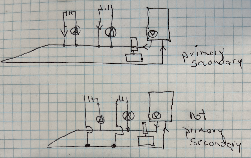

Just curious about this set up since it seems very different in the way it's configured compared to what may of the pros on here have drawn or guided people to do in many posts on here. I've never seen the supply and returns joined together on the ends like that and the pumps and pump returns being divided between both manifolds before so I was wondering if:
since the 5 pumps are drawing from both the supply and the return sides and the loop and the end of the manifolds is closed in with the 2 90's doesn't that loop exceed the amount of circulation coming from the pump inside of the combi unit if all 5 pumps were running? I would imagine that the water is doing some weird stuff in the black manifold pipes and barely making it back into the boiler to get up to temp. Isn't it unusual to have the pumps and returns arranged like that?
again just my own curiosity since its so different set up this way.
Thanks
Pete
You are correct there are a numer of ways to pipe P/S. I put the 4 most common on the one slide.
The single slide shows the P/S with the boiler IN the loop. But with series P/S you need to account for the temperature drop each set of tees contributes. Math included on the slide. This is how I see the OP piping?
One small issue with the OP headers is the close tees, and the distance between the sets, it is not textbook. I suspect those are boiler pump headers not specific P/S headers as the tees look equal distance? It will work, a small potential to ghost the secondaries as the spacing between the "close tees" widens
But the golden rule of P/S is closely spaced tees. If you don't have properly piped closely spaced tees you don't have hydraulic separation/ P/S.
A hydraulic separator, properly constructed is a version of closely spaced tees. The spacing can be wider due to the large barrel dimension, 1:3 ratio. Velocity in the barrel is 1/9 of the branches. If it is built to the correct proportions. Not all are :)

I can see what you are saying in the bottom system example that you attached above. I was not thinking of the return being right along side of the pump, I had it pictured in my head that it was kind of alternating front to back instead of going left to right around the headers. I see it clearer now in the drawing you supplied. I was over complicating it in my head.

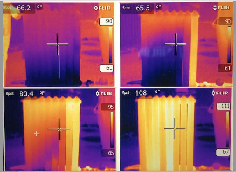

Baseboard in basement but upstairs ci radiators.
As you know the heat delivery will be much different with those two types of emitters. If you are watching S&R delta T, the CI will take much longer from a cold start to warm.
If the CI rads are the last loops off the P/S piping they will be seeing a low temperature, further slowing the feeling of heat. The rads can be taking a lot of the gpm with the low pressure drop. If the rads are piped with 1" and a 007, they are taking a lot of your gpm, I'd choke the flow down to those. The ball valve at the circ is fine for some basic balance.
I ran this IR test at 2,4 and 8 gpm flow rates. No question the higher flows = quicker warm up higher btu transfer rate..
