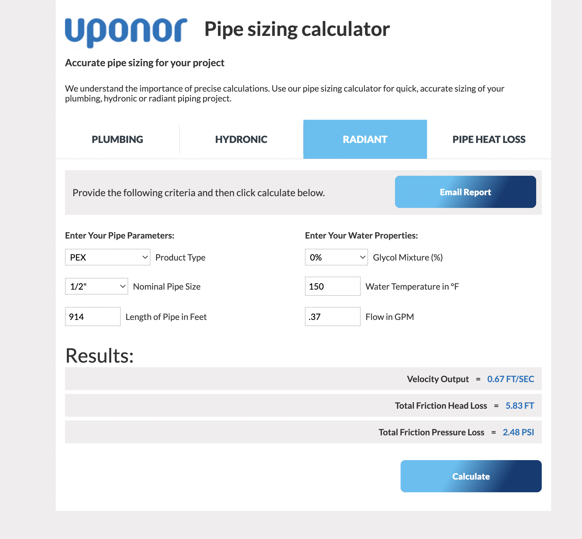

Do I simply divide the GPM rate….6.7 GPM by 18 (the number of ports) which would give me a flow rate of .37 GPM at each radiator (assuming the system is balanced)? If I enter that into the Uponor pipe sizing calculator on the Radiant tab using AWT of 150 for roughly 914 feet of 1/2" Pex I get a Total Friction Head Loss of 5.83 Ft. (I have attached a screenshot). Am I even in the ballpark as to how I am calculating this?

    Fundamental problem in your head loss/flow calculation. It appears that you are using the total length of pipe in your entire system for the length of pipe — to get the 914 feet. Unless this place is immense…
    For the head loss which you need to pump against, it is the flow for and the length of the longest loop that you are interested in, not the total length of all the loops. Flows add. Lengths don't.
    Now your calculation of about 6.7 gpm total flow is about right.

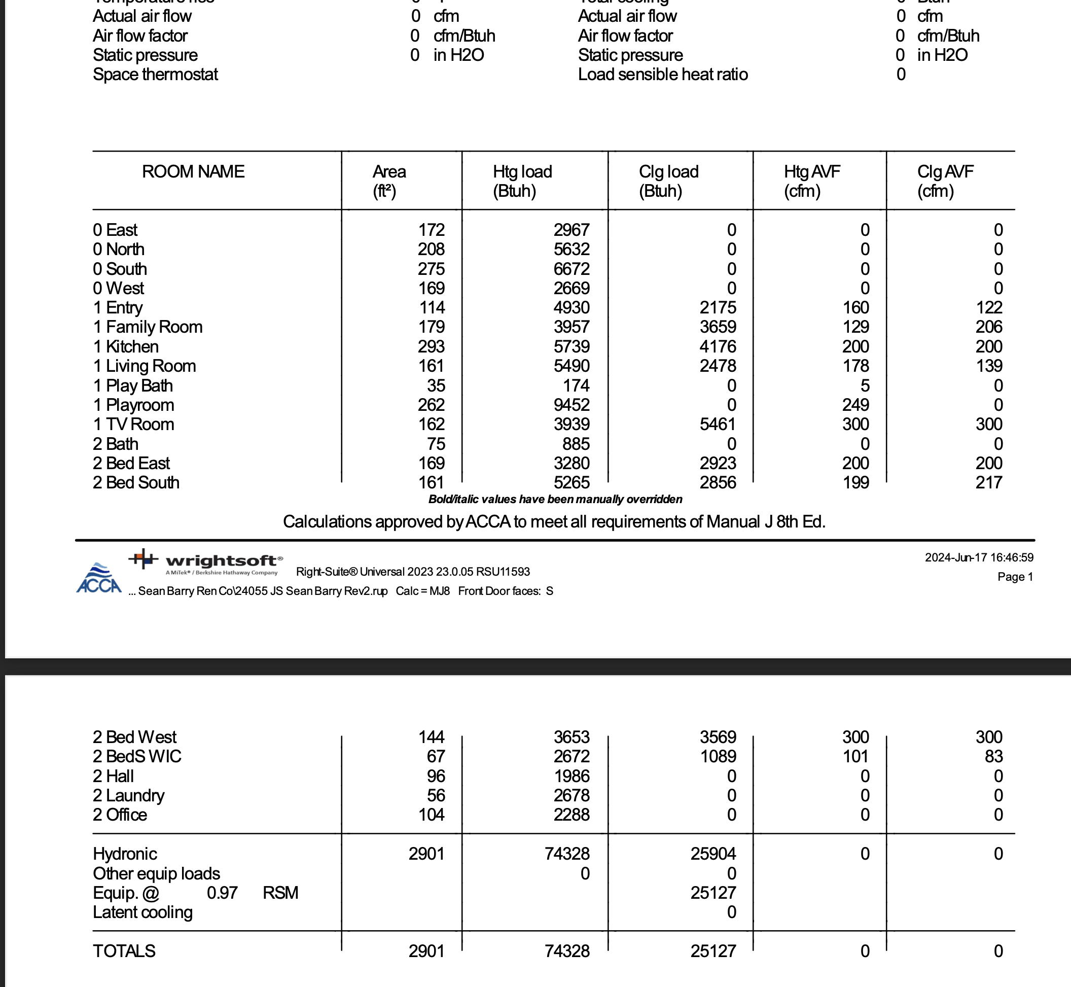

    I have matched the panel radiators to the heating load calc I had done. I oversized the radiators that were rated at 180T because they will be supplied by 150AWT with design of 160SWT and 140 return. I used Runtal's multiplier of .67 to make sure the radiators fairly closely matched the individual room heat load with the lower AWT.
    Not loving the sound of you saying you are "hoping that's not right". I am including a summary of the room by room heat loads. I reduced the total load from 74K to 67K as I was planning on leaving some radiators out of the unfinished basement..
    Well… hmm. Looks like you do have perhaps 18 radiators or thereabouts. In which case, if each one is a home run, you need a total of 36 ports. However, there may be better ways of piping the system so that some groups of spaces with similar loads can be run off one pair of ports. Provided the radiators are then piped in parallel within that group, and using TRVs on them as you seem to plan you cold simplify things quite a bit…
