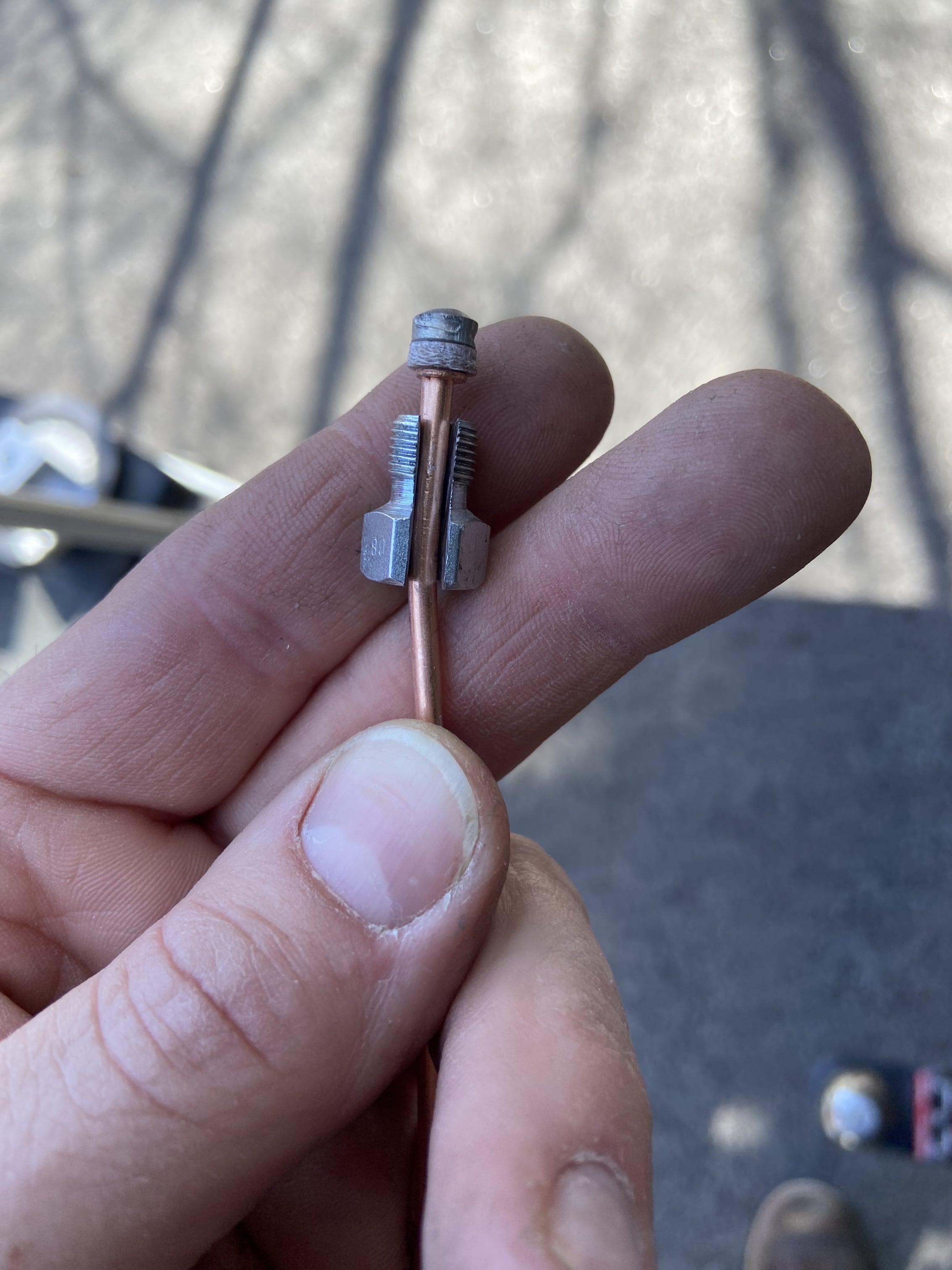

American water heater LH thread thermocouple
Anyone ever seen it or had to get one?

    Yes. I have not done one in a few years. But if you call the manufacturer I believe they will ship one to you. At least as of a few years ago

    Tried this method someone posted somewhere… Dremeled a slot on old LH bushing and put on new TC. Worked great.

  • I've sold a few american hot water heaters, I used to stock the left hand thermal couple. The reason they used to left hand thermal couple is because the thermal safety switch for the FVIR water heater was part of the thermalcouple. The thermal switch would overheat if the flame arrester became blocked.
    This was the only safety on these early flame arrestor units. If you have reused to bushing or used one of the adapters sold on Amazon to install a normal thermal couple you're eliminating the only safety on this burner.
