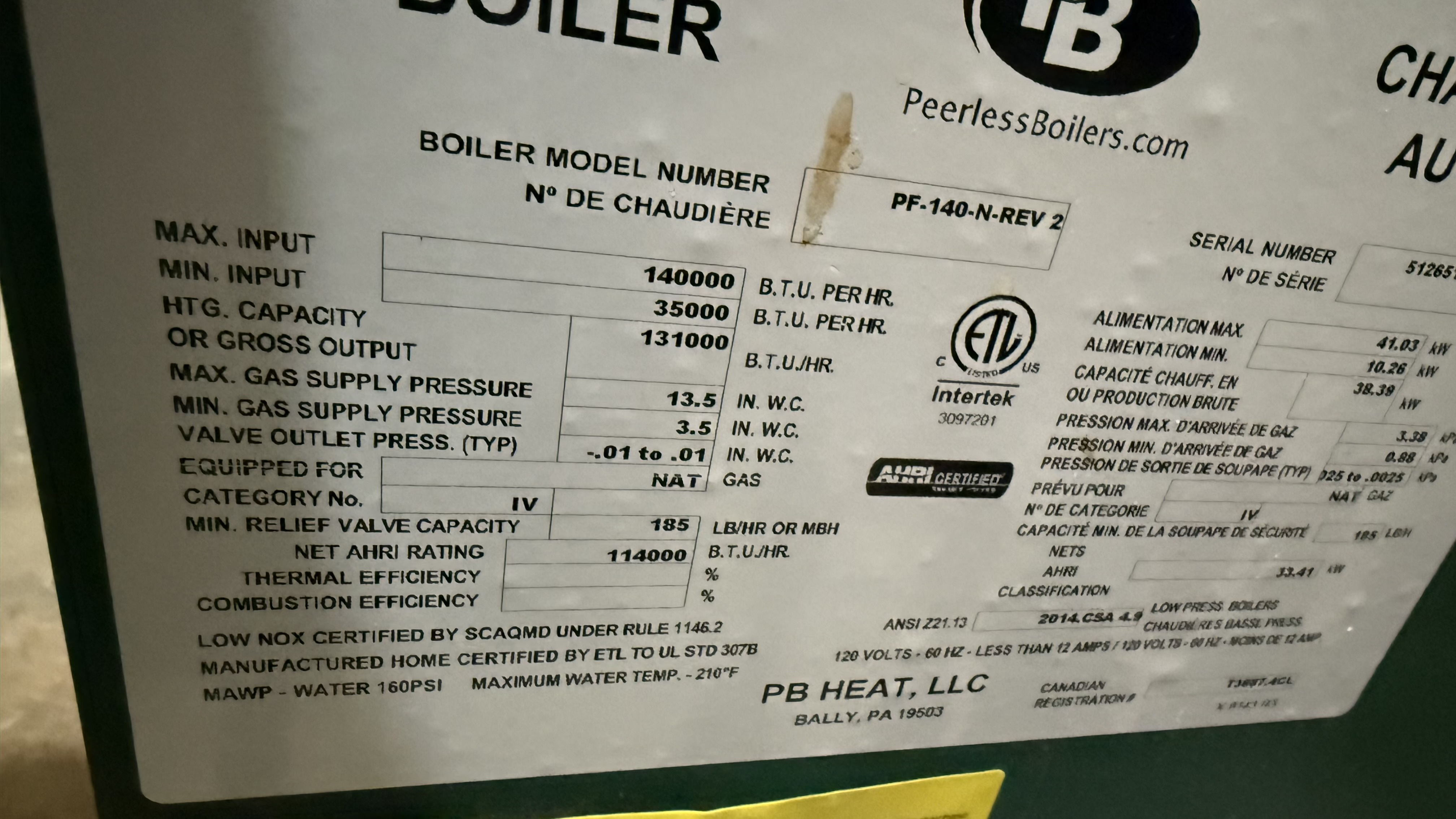

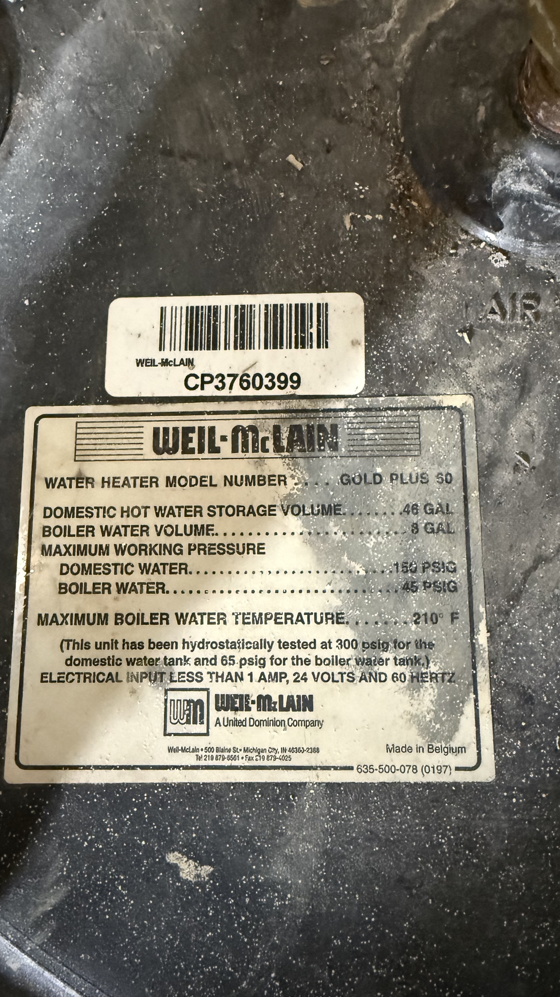

I own a house built in 2002 and it has a peerless PF140-N rev 2 boiler paired with a Weil McLain 50 gallon gold plus indirect fire water tank.
im replacing both the boiler and the water tank. Long story short, I run out of hot water constantly, and the peerless unit has been a royal pain in the butt since we moved in less than 2 years ago.

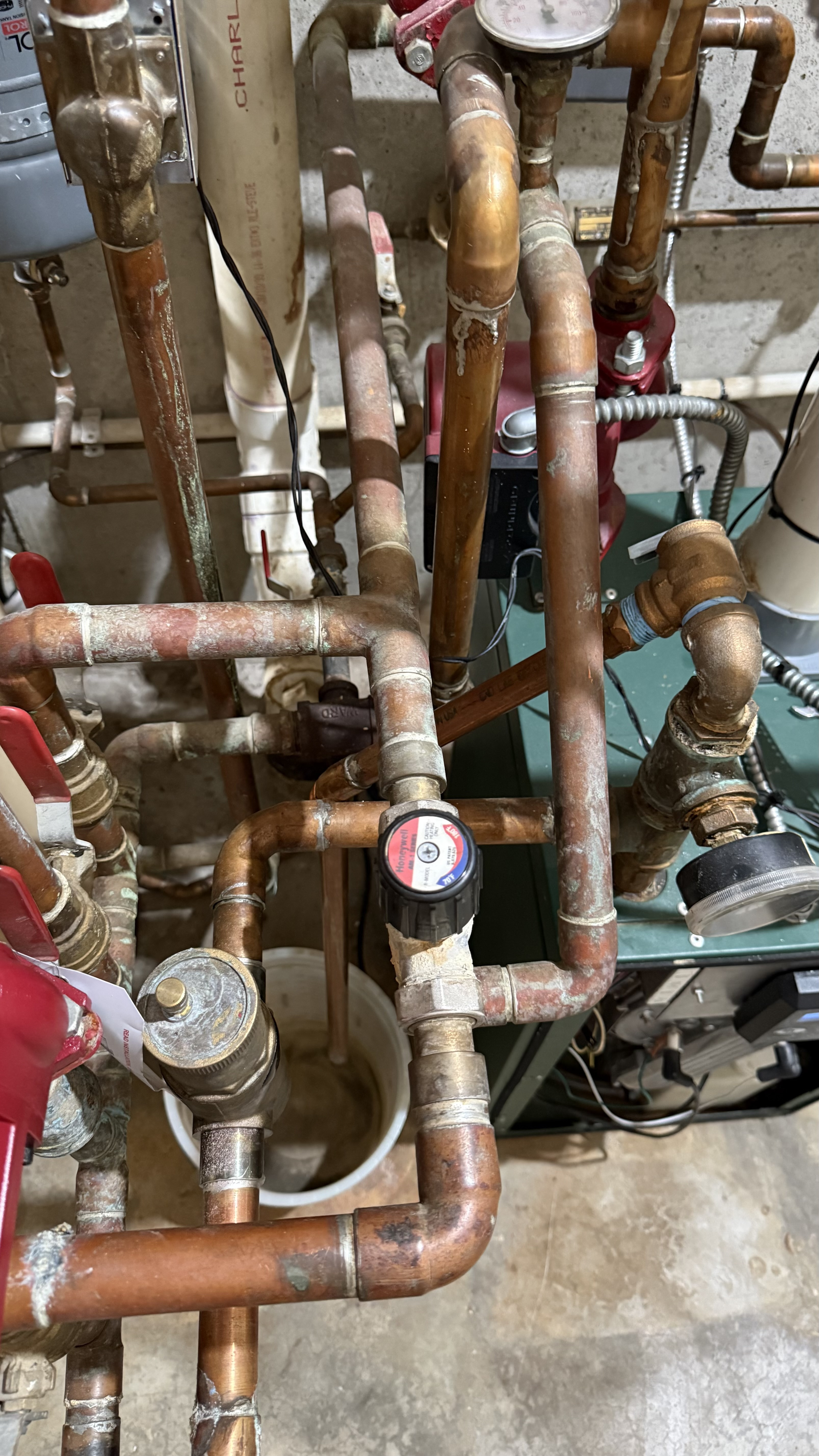

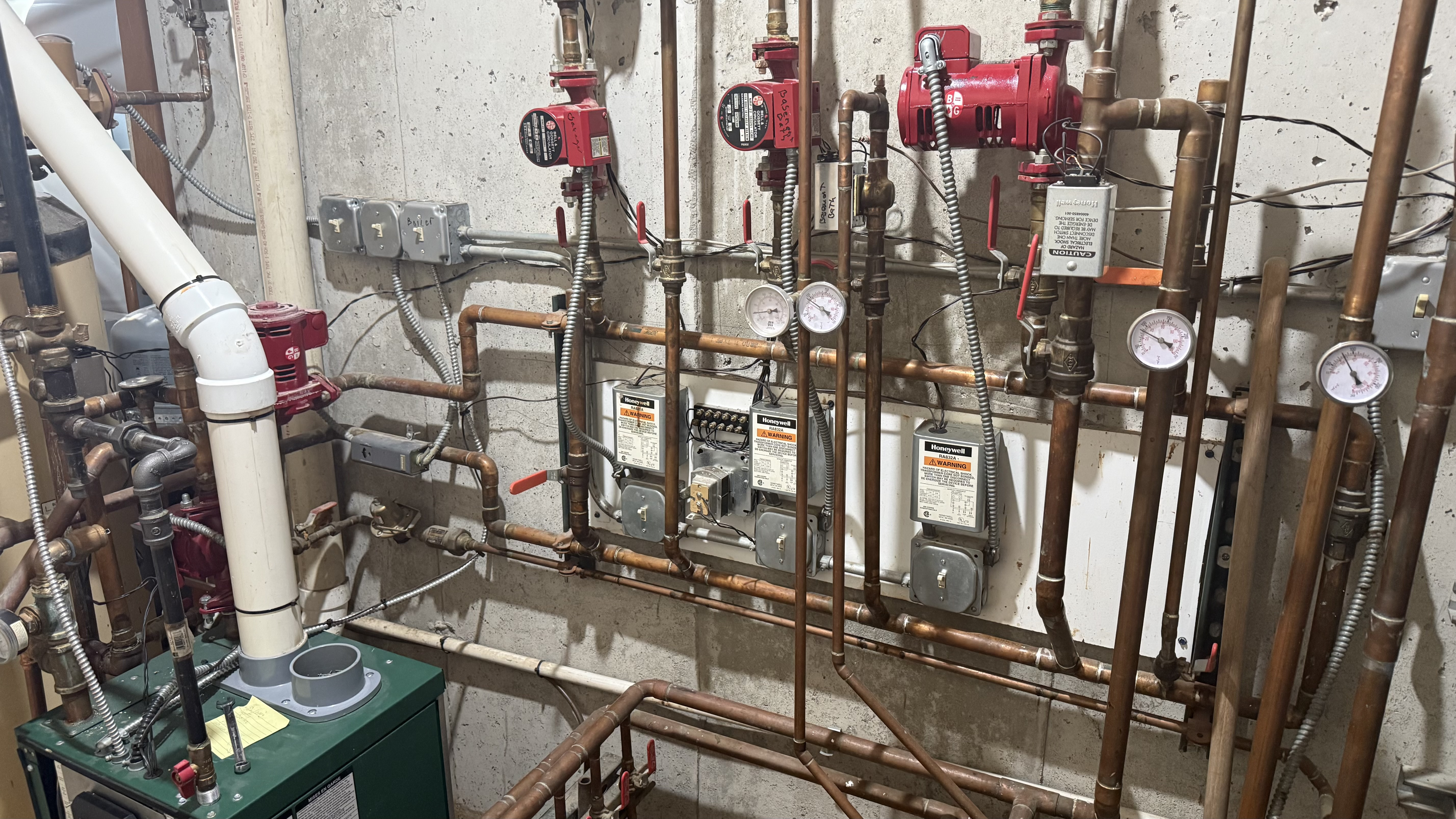

  4. Based on the photos, some of the quotes I’ve received, I’m being told that the piping, pump, switch setup I have is not ideal. Is it worth modifying? I can supply more photos on request.

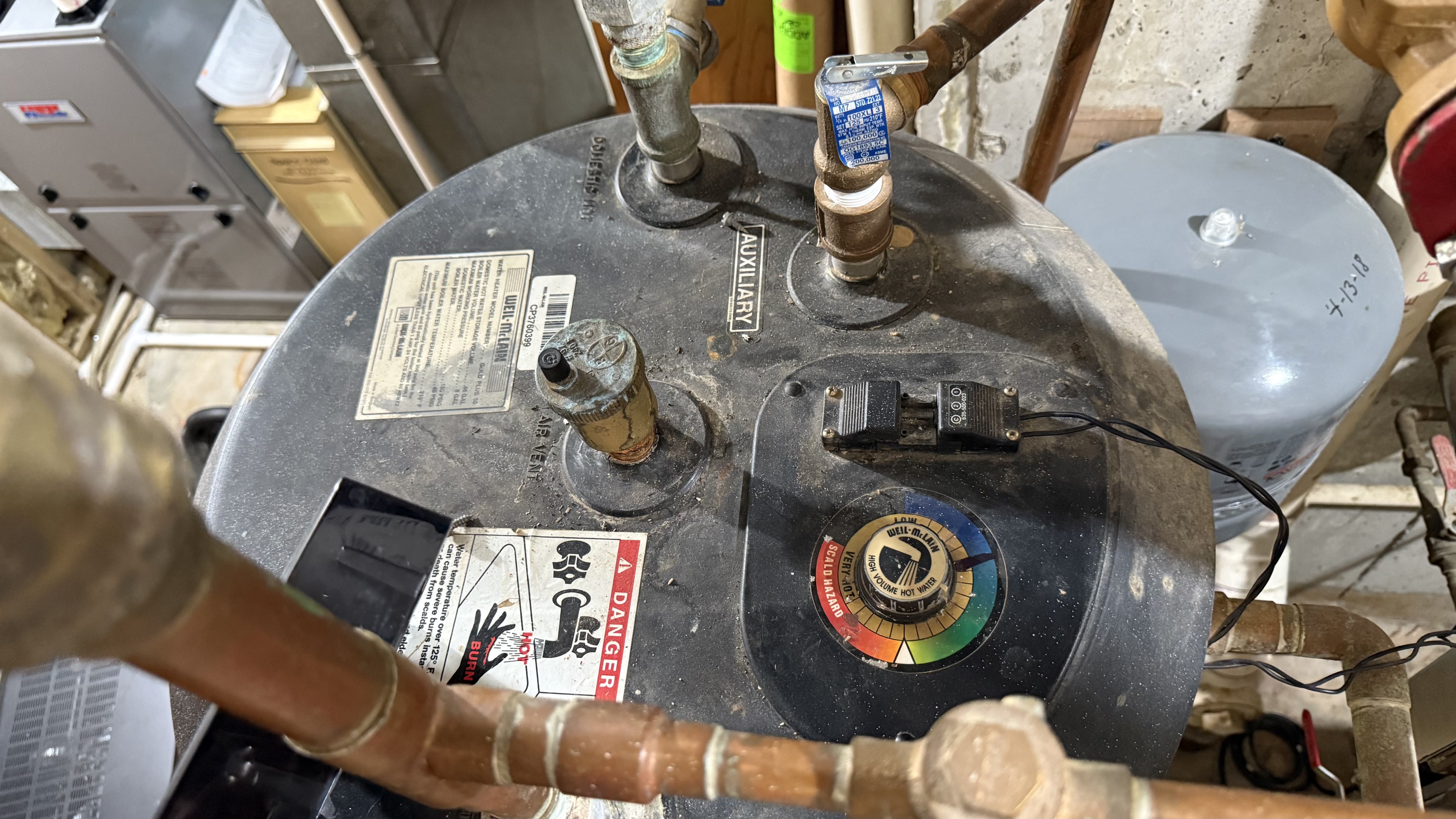

    Assuming all plumbed properly and the indirect on priority, most likely your indirect has a busted dip tube. When this happens, cold water is mixed with the hot near the top and capacity is reduced. The original installer could have also mixed up the cold and hot water feeds to the indirect, would cause similar issues. I would check this first before spending money on replacement/alternative.

    Another option would be a much bigger indirect. I would estimate you need around 160 gallons. If you could find one…

    No. You need at least a 200,000 BTUh boiler in that scenario, if you are keeping the 50 gallon indirect — assuming that the indirect can handle that much power. I haven't looked that up.
    And that boiler is almost twice as big as what you need for your heating load, which will lead to problems and inefficiencies on the heat side…

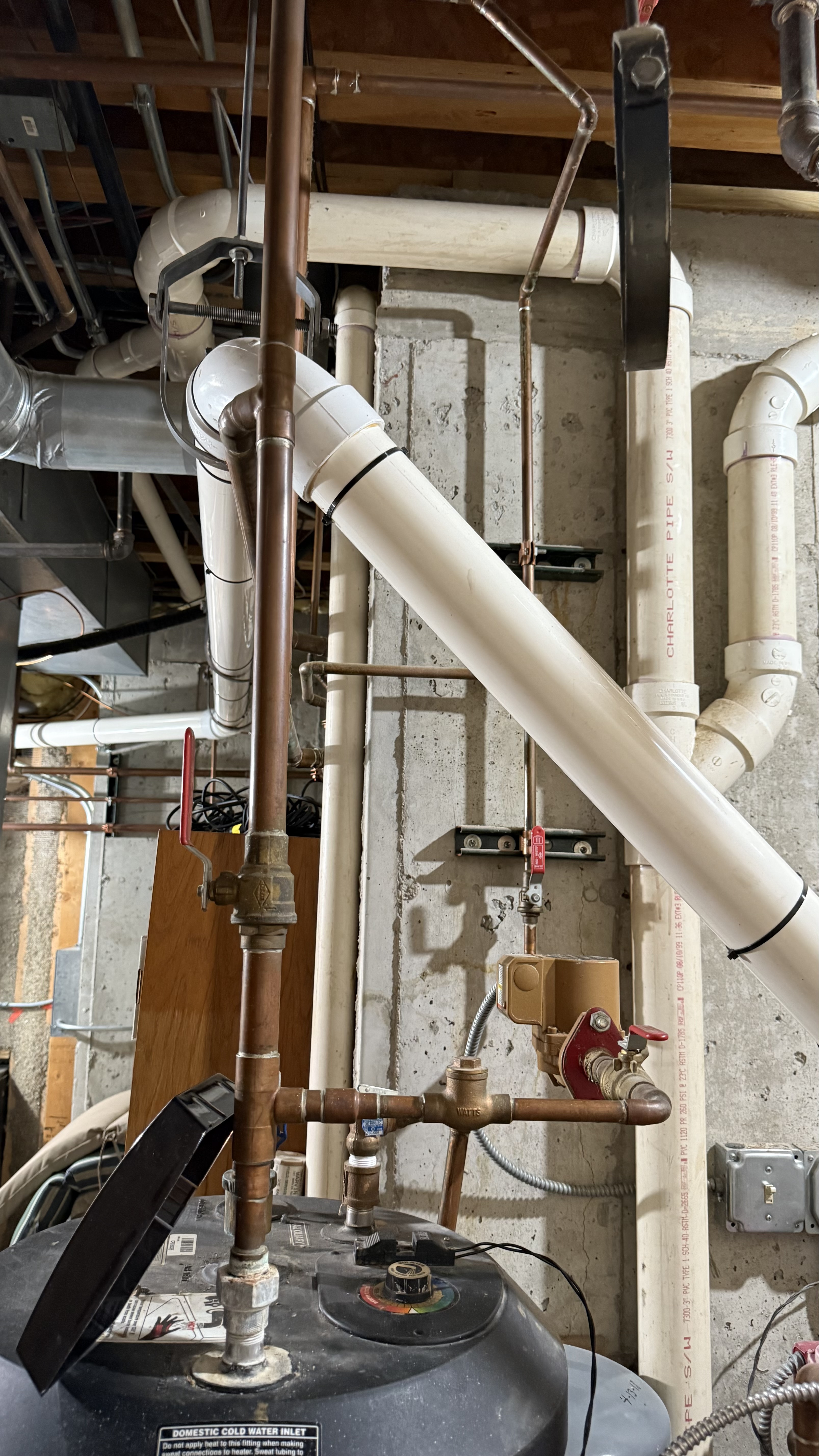

    Can you show us a picture of the dhw piping to the indirect? it should have a thermostatic mixing valve and be stored at a higher temp in the tank. This only gives you maybe 10%-20% more capacity but it allows the temp in the tank to fall as the thermostat makes a heat call and the boiler heats up which all takes several minutes before the boiler starts heating the tank. the thermostatic valve keeps the hot water temp constant as the temp in the tank falls.

    Is that mixing valve in the 3rd pic for the dhw or making the low temp water for the radiant? It looks like it is in the heating loop.

    mattmia2 the mixing valve in question is only for the radiant heating.

  • The thermostats on those tanks are known to fail, especially if they get wet. It doesn't appear that there has been any water dripping on it, but besides the dip tube, that would be a hot button item to check.
