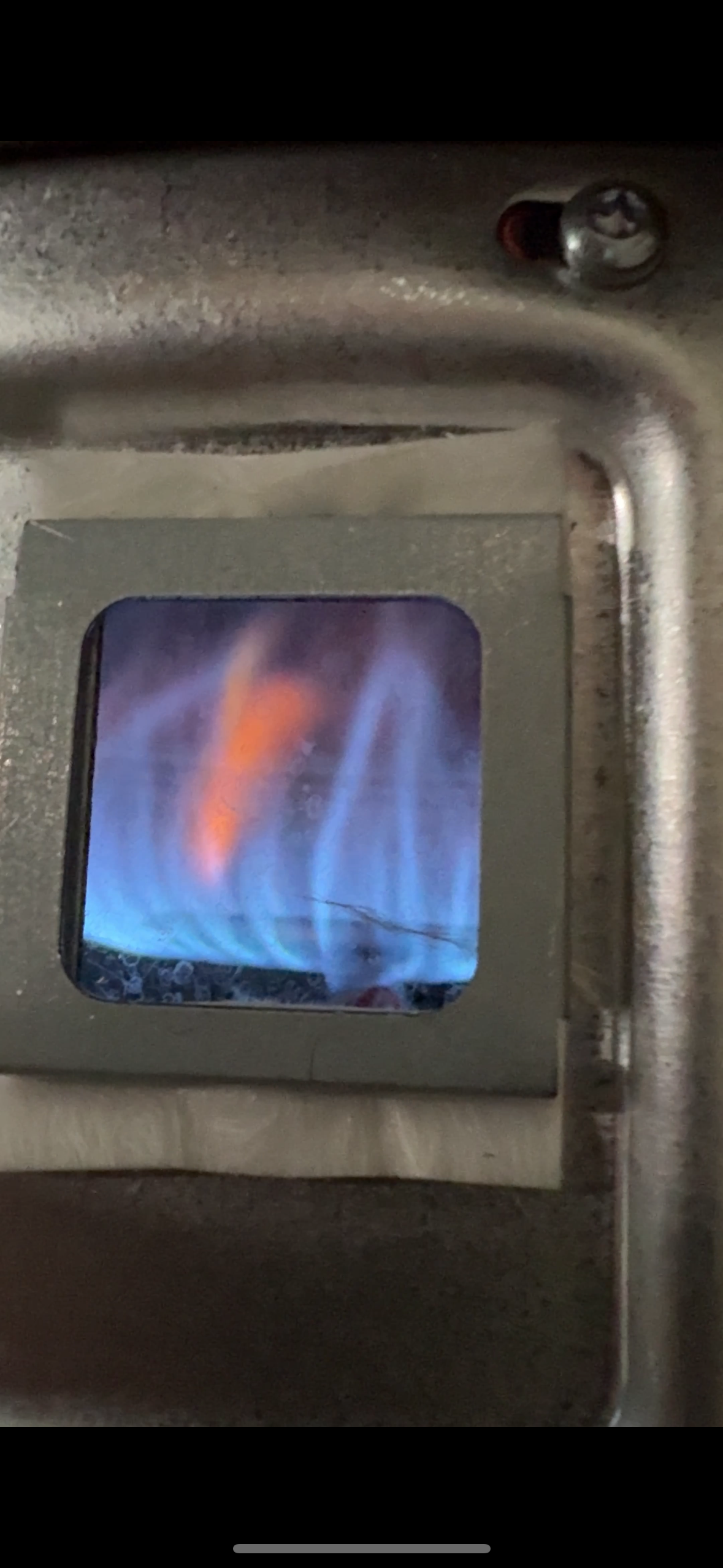

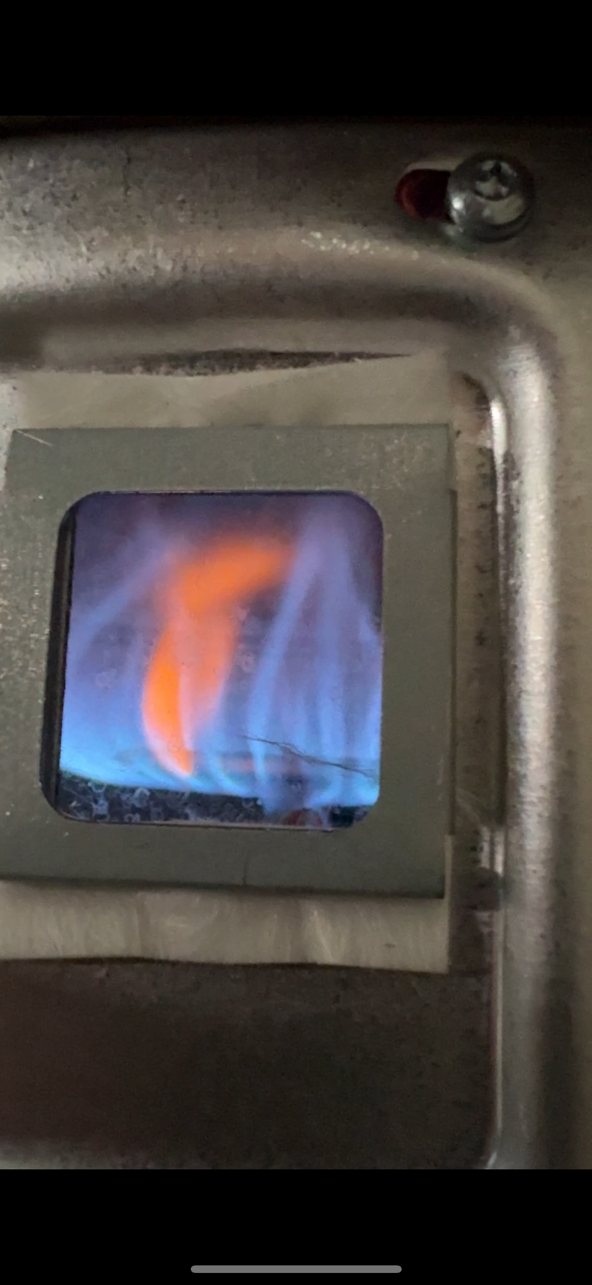

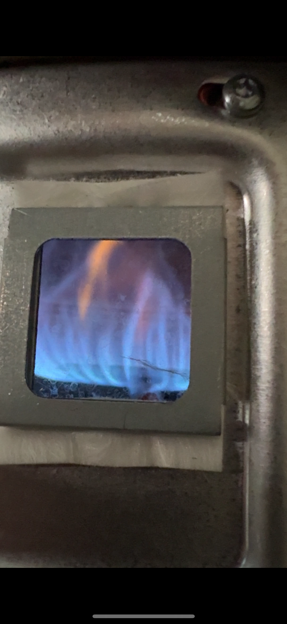

Water Heater Burner Flame
    as much as anyone can tell without test equipment. the orange is from sodium either in the air or on the surfaces
  • Hi, It's not normal. I think I'd start with removing and cleaning the burner. See what improvement that gives. I suspect "gunk" has built up on the burner and is impeding gas/air flow.
    Yours, Larry
    Flame looks long and lazy to me. I would also check the flue pipe and chimney.
  • mick04u
    mick04u Posts: 17
    It’s a new water heater
    Intplm.
    Intplm. Posts: 3,160
    You should have the water heaters gas pressure tested and serviced.
    Is this a water heater that was purchased at a big box store? If so thats ok, but one brand (I don't remember which one) had a run of bad gas valves. Get it looked at. Its probably covered in warranty.
  • pedmec
    pedmec Posts: 1,488
    It looks lazy but it's also a picture. Try and post a video
  • mick04u
    mick04u Posts: 17
    It’s a Rheem from HD. I’m unable to post a .mov video file.
    I think thats the one. Get in touch with HD. It will most likely be a warranty covered new burner and gas valve replacement.
  • Tim McElwain
    Tim McElwain Posts: 4,660
    Have someone from a gas company that does service take a look at it. It is really hard to tell if you have a problem as the videos of the flame are not conclusive with out some combustion testing. Do not jump to conclusions get it tested!
