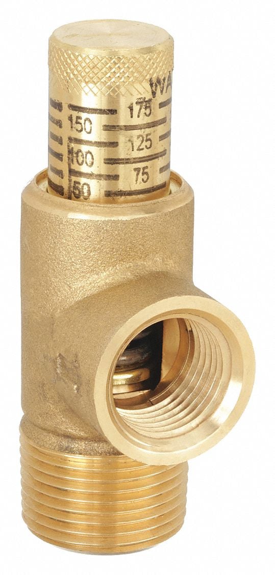

I have a hot water coil on my oil burner. There is a adjustable pressure relive vale that is leaking. It is located where the cold water pipe enters the coil. I would like to replace it but I am not sure what the pressure should be. Any help would be appreciated.
    If it is on the domestic hot water side it can be replaced with a standard fixed t&p valve. Are you sure it is a relief valve and not something else? Can you show us a picture of it?

    This is the valve.

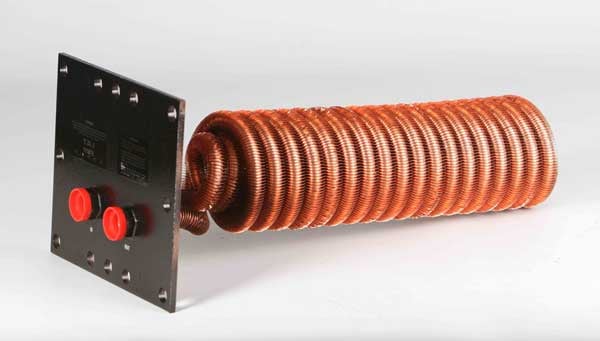

    No backflow preventer. And the installer added a vertical length of copper pipe to the system to act as a expansion tank. This is the type of coil I am talking about.
  • Hi, Does your valve look something like this? It might have been used so there is no temperature sensitive part. I'd measure the static water pressure and then set the valve about 20 psi higher. It would be good to use a pressure gauge that has the red "lazy hand" so you know what the highest pressure has been over, say a 24 hour period. If you have a pressure reducer or back-flow preventer, you may get pressure spikes when the water heater fires. In no case do you want the system exposed to pressure over 80 psi.

    oh, because in a steam boiler it could get hot enough for the temp part of a regular t & p valve to operate
    EBEBRATT-Ed Posts: 21,328
    Not a T & P just pressure only. Usually a 15-175 lb valve.

    That's a Watts 530C. Set it to 125 or 150. The 100XL T&P (non adjustable) comes either 125 or 150 psi.

    You can get fixed pressure only relief valves set for several points between 100 and 150 psi from someplace like supplyhouse.com too. I would rather see a fixed relief value so that someone that doesn't know what they are doing can't adjust it.

    We have all seen tankless coils installed without a PRv and they have been fine for years. The coil only holds a small amount of water so there is not much expansion which is taken up by the H & C cold water piping and as long as there are no check valves or pressure reducing valve it can back up into the street.
