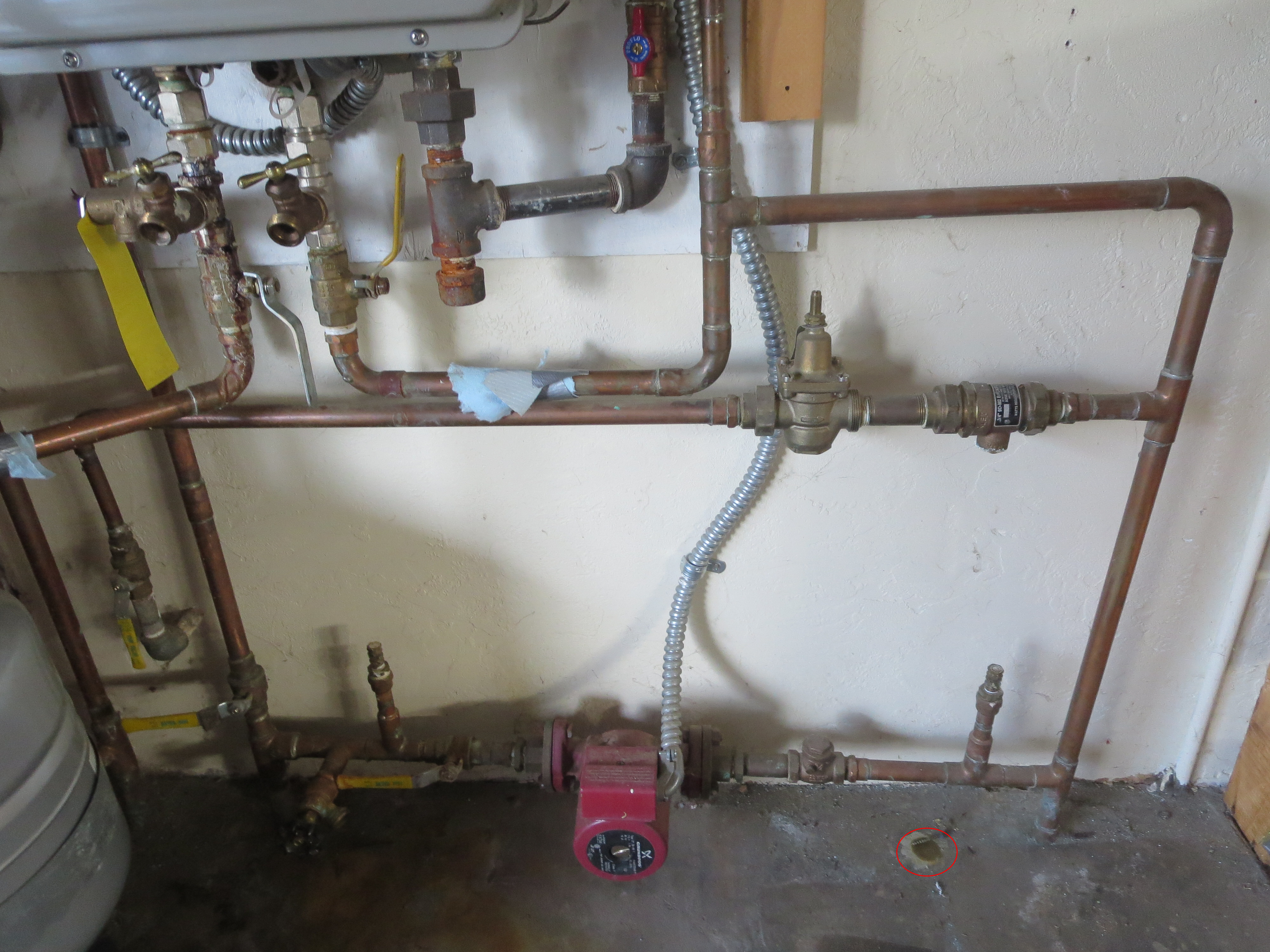

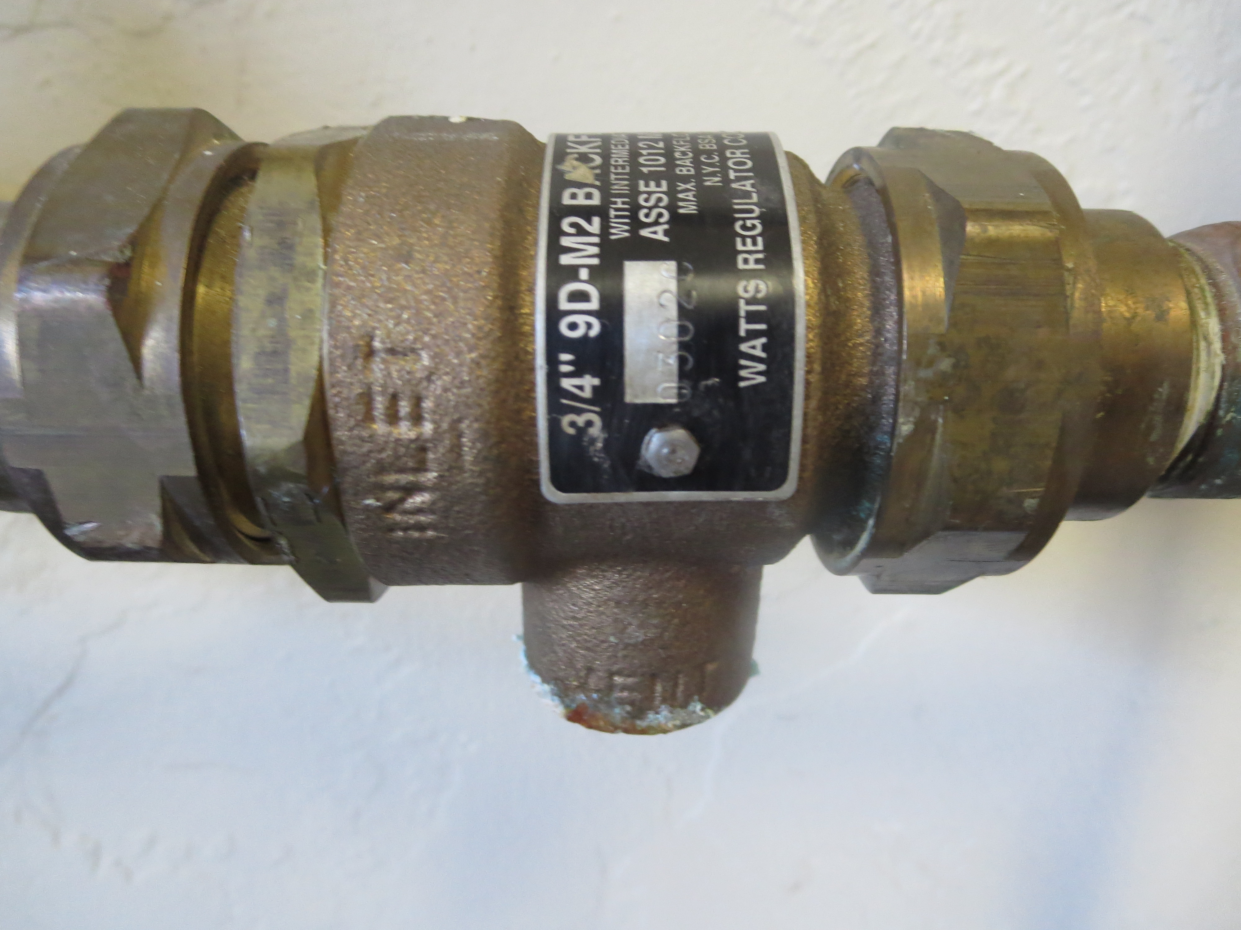

Why does backflow preventor have an outlet?
What does it mean if it is dripping.
Is in a 12 yr old hydronic baseboard sys.
    EBEBRATT-Ed Member Posts: 20,238
    It means the backflow preventer needs replacement. You can probably get a rebuild kit for it if you think it is worth it.
    Intplm. Member Posts: 3,034
    As @EBEBRATT-Ed says above, absolutely rebuild the thing. If the money is about the same you can purchase the same one for direct replacement if you prefer.
  • "Why does backflow preventor have an outlet?"
    A check valve will stop backflow without venting, but it can become fouled and allow seepage back into the potable system.
    That Watts 9D is a step up from a check valve and will dump any water trying to get back.
