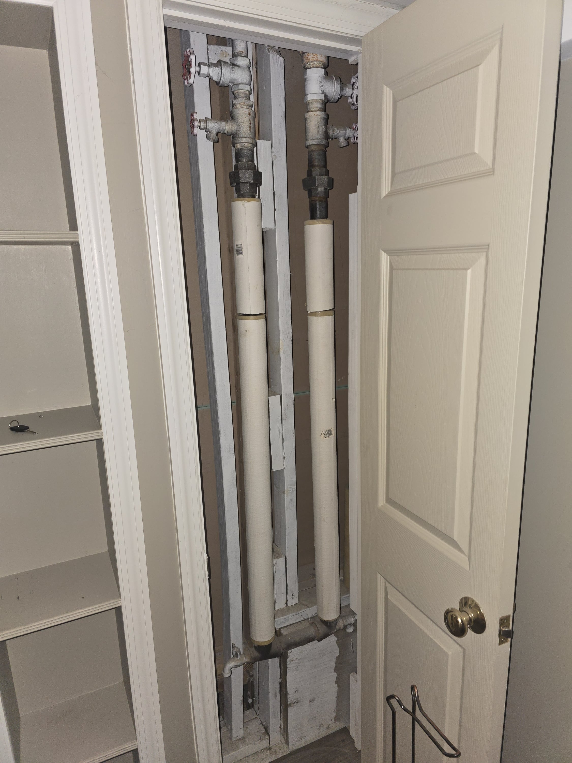

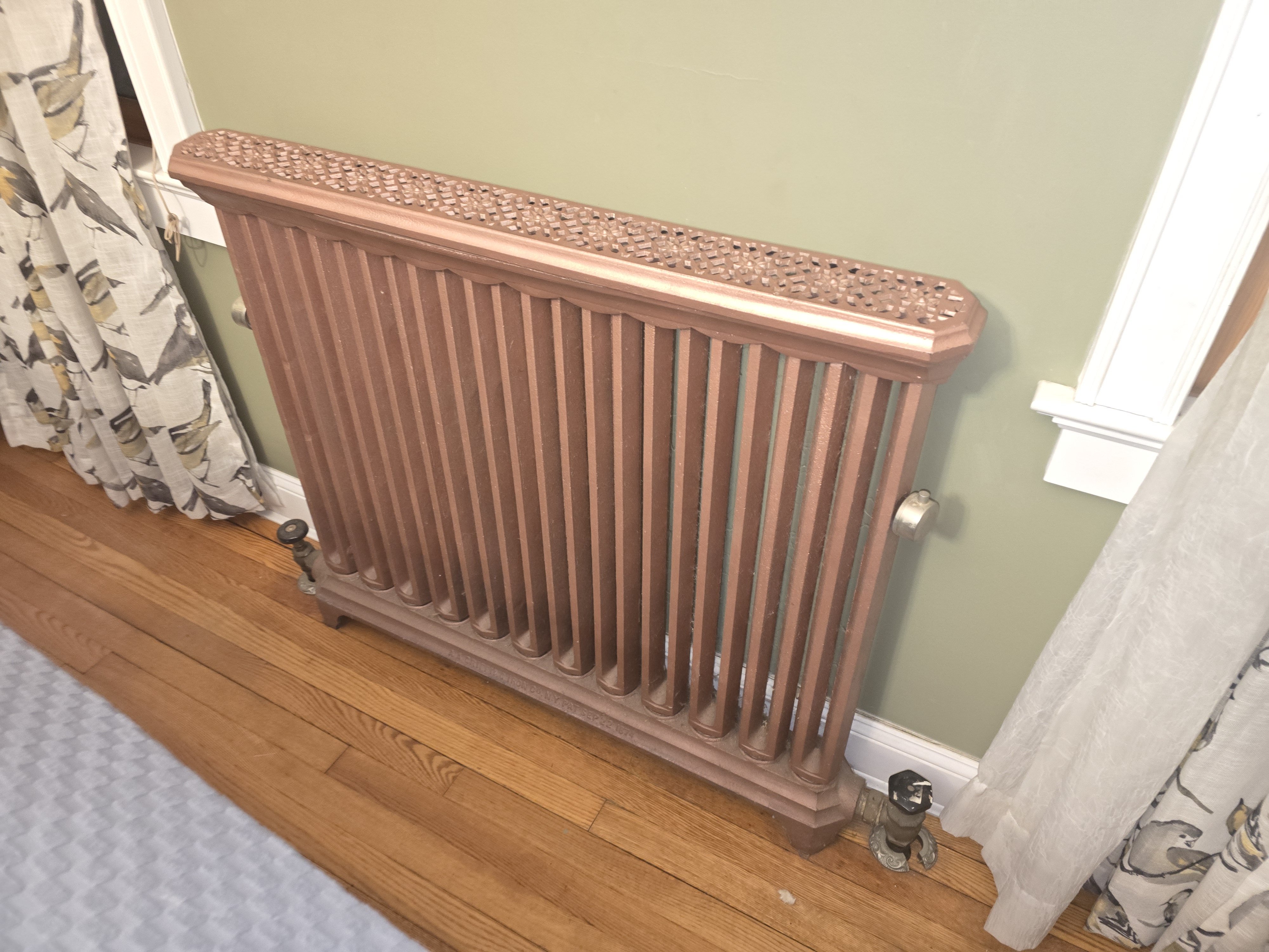

For the 1874 AA Griffith's two pipe radiator in our parlor, I made a loop seal below in the basement because I wanted to keep my New (2001) Vapor system extremely simple , no traps to confuse some guy many years from now. I will post a picture. Mad Dog
Very Nice! The top sillcocks are for flushing? How often do you need to do that? @Mad Dog_2

Nah Ed…a loop seal is a basic plumbing P Trap..very obvious what it does even to the dopiest plumba...I've seen countless very good plumbers having no clue what a steam trap actually does. Mad Dog
1 -
Ever need to flush it?

2 pipe air vent with loop seals on the rads.
Site is on the top.
Trying to squeeze the best out of a Weil-McLain JB-5 running a 1912 1 pipe system.0 -
Wet return doesn't stay wet? Odd.
Installed on my Vapor system around 2002. Radiator outlet enters loop seal on the left...Mad Dog
