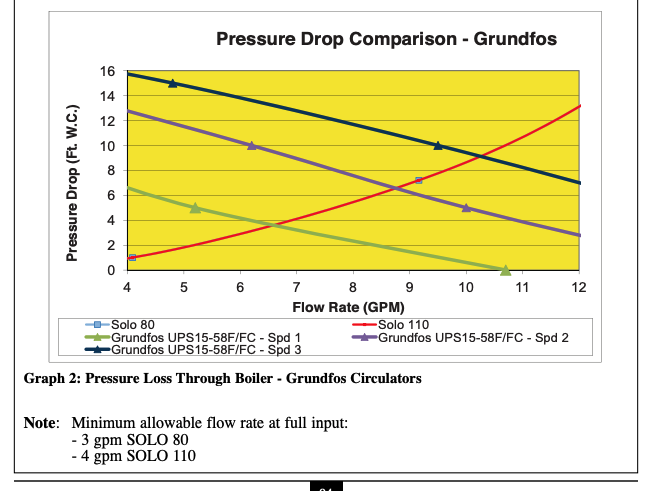

You need at least 6 gpm for that many loops. If the pump can provide that and the boilers minimum flow, P/S may not be required. The installation manual would give you that piping option information.

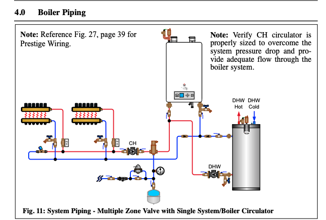

The manual suggest primary secondary, however they do show an option to pipe it exactly like you have. The flow required is based on which model boiler you have? Here is the example for the small 86,000. And I think your system and piping piping would meet the minimum they ask for.
If it has been running for awhile and not going into a lock out error on the screen, you are probably okay fine. Maybe others here have experience with that specific boiler.
That looks like a side connection expansion tank. It has a threaded union connection so pex could be adapted right there and pipe the tank wherever you prefer it. Or a more involved change would require re piping copper tube. I'm not sure if these changes are something you want to attempt?
