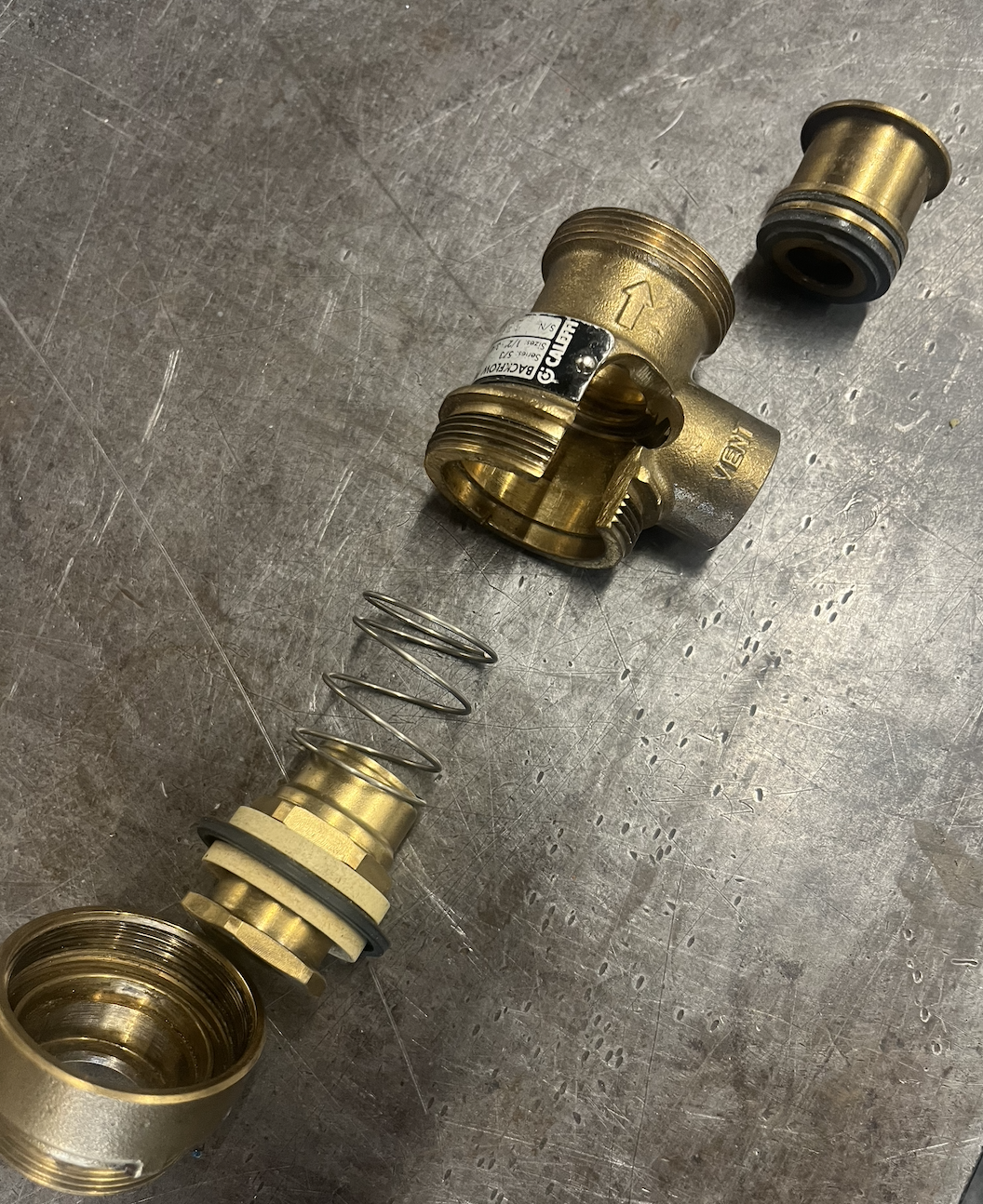

Or should I say, FLOW preventer? Here's the story: I ordered a backflow preventer from Supply House and installed it over the summer. It seemed to work at the time, but when I went to fill the boiler in the fall, I couldn't get water through the autofeeder or the bypass because the backflow preventer was stuck shut. Under pressure, the vent closes, but the outlet doesn't open.

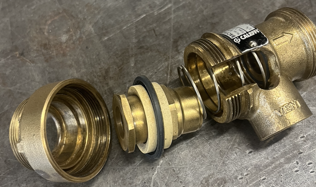

I removed the BFP and took the screen off the inlet to look inside.
It looks like there's some limescale or corrosion in there, but it shouldn't be enough to keep it from working. It was only installed for about four months. I'd really like to take the thing apart and either fix it, if possible, or at least understand why it failed. I really don't want to throw money at a new one only to have it suffer the same fate. Has anyone had any luck getting these things apart? There appears to be a parting line between the flats and the vent port, but, try as I might, I can't unscrew it.
I tried putting it in a vise and screwing a length of ½" pipe into the vent and pulling about as hard as I could without breaking off the pipe, but no joy, so I thought I'd ask for help.
I don't see anything that looks like threadlocker or sealant. I haven't tried applying heat, which is risky with brass and would probably ruin the rubber seals, but if I have to I'll try it.
They wouldn't have used a left-hand thread now would they? Because that would make me mad.
    I had that happen to the check ball on the outlet of a Claeffi PRV, there is a check built in to the valve for markets where a double check isn't required. The scale attached the plastic ball to the brass seat such that it wouldn't flow water. I strongly suspect it is the additives that our treatment pant adds to keep the water from leaching lead and copper from the piping.

    as for fixing it, just soak it in some citric acid.

    You might go to the manufacturers website to see if they show an exploded view.
    Typically that assembly seam goes against a rubber seal, I doubt it would be Loctite-ed together.
    The second check generally comes out the other discharge end, you should not need to split it open if the second check is stuck? Push a wood dowel against the first check if it is stuck, without splitting it open.
    Warm the large nut with a hair dryer to expand it, it doesn't need to get red hot to losen it.

    I'm tempted to get rid of mine too. I soaked it in vinegar and got it working again, but am I going to have to do this every 4 months?
