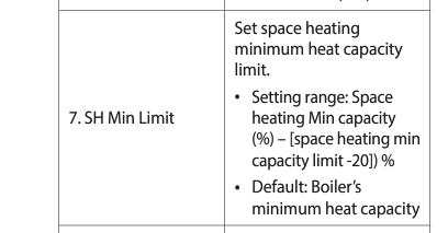

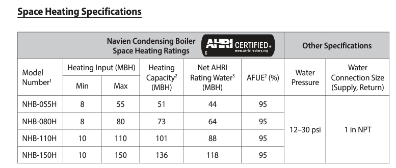

    The boiler has a 15-1 turndown, down to 10,000.
    Also you can limit its SH firing down to 20% so it should not be oversized. Essentially you can make that a 27,000 BTU/hr boiler.
    On the coldest day, set the SH down as low as it can go and maintain the temperatures you desire in all zones.,

    Your boiler running for only a minute is not ideal. The space heating min capacity must be set as low as it goes. I would set the "Burner off differential" to 12* or more. Set the "low burning time" to approx 3 minutes. Set the Acceleration time to maybe 8. See what that does.
  • Thanks. I have set most of the parameters and will report back.

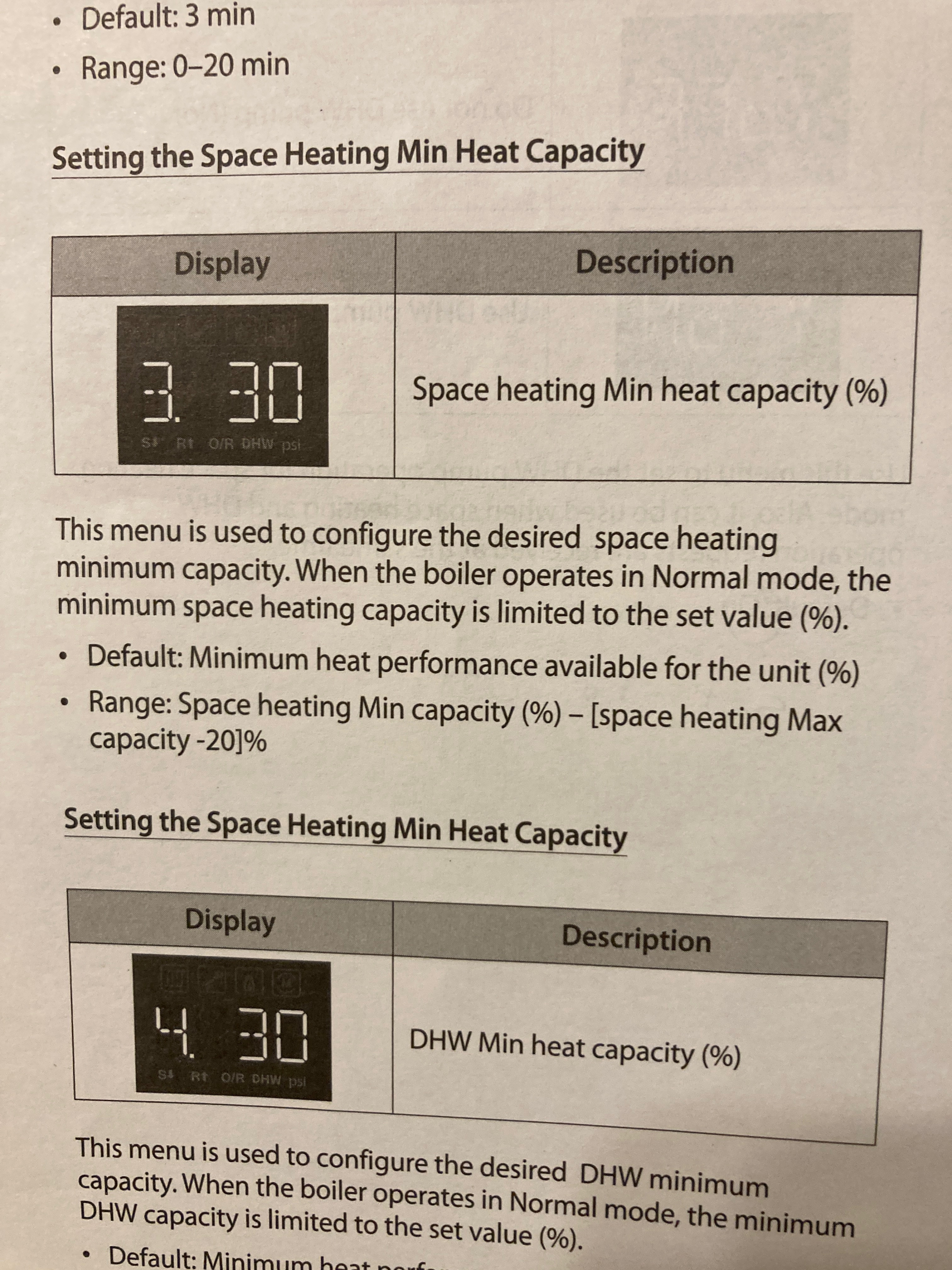

  • Here are the options that were set.
    Burner off Differential (option L) - default 4 degrees set to 12 degrees
    Low burning time(option 1) - default 1min set to 3 min
    Acceleration (option 2) - default 3 min set to 8 min
    Space heating min heat capacity % (option 3) - default 30 set to 7
    ADDITIONAL Parameter Set
    DHW Space heating min heat capacity % (Option 4) - default 30 set to 7

    Is there an item I can monitor to understand with the space heating minimum capacity (I guess this is connected to turn down function) that I can check to see if the new space heating minimum is working?
    Any options you will like to change or other options to change.
