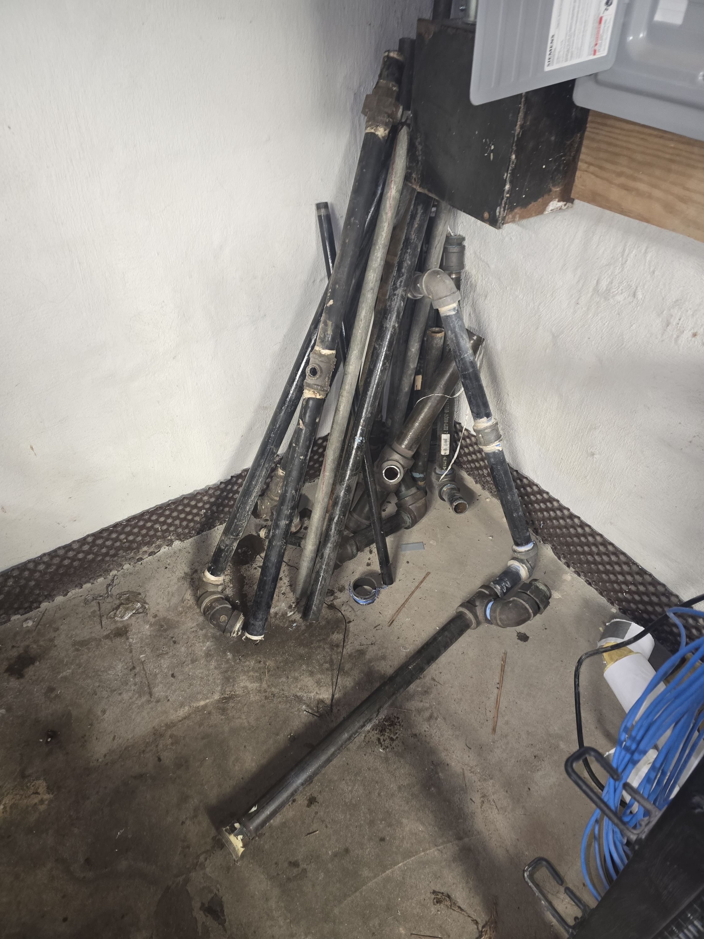

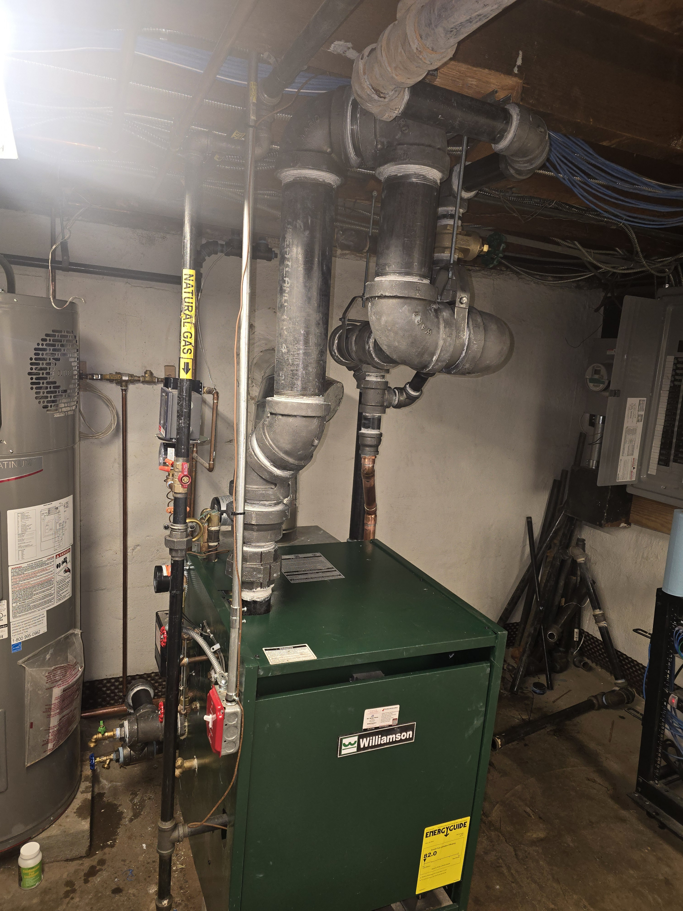

One year old boiler repiped
All 1 1/4" For header & N.B.P....Building heating on 10 ounces of Steam Vapor...Mad Dog
Wanted to use other tapping as well and keep it all 3" but was going to do more damage backing it out. Mad Dog
1 -

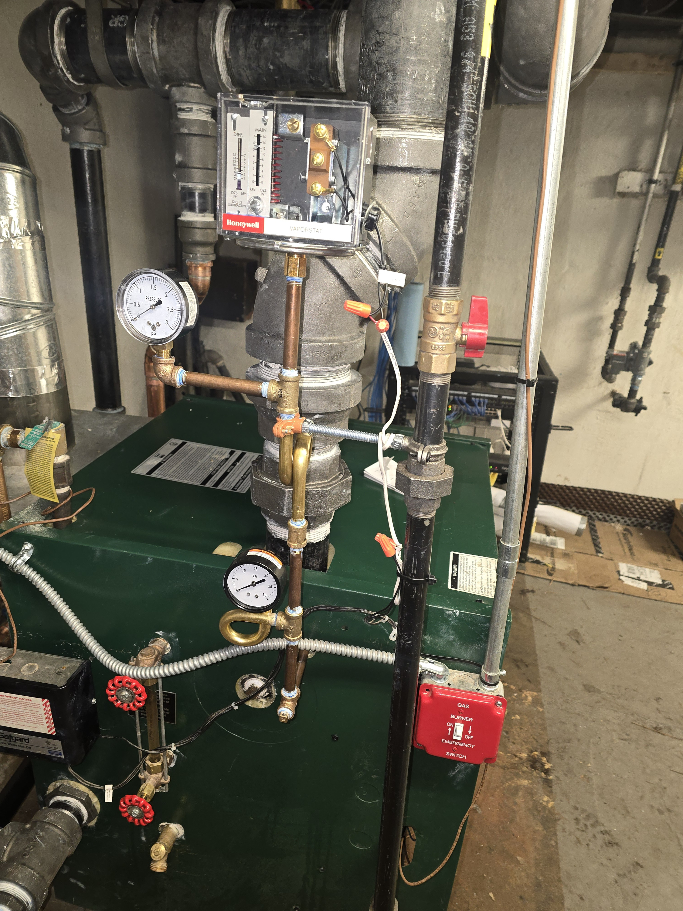

that's an interesting way to do a drop header.
is "williamson" a weil painted green?
Yes...Unlike most installers, I like to do every boiler a little different. When I have a system with a lot of banging & Wet Steam, I go as HIGH as possible to roll it around & dry it out. Mad Dog
5 -
Yes..it is made by WM...vg boiler with 3" Tappings which is nice. Mad Dog

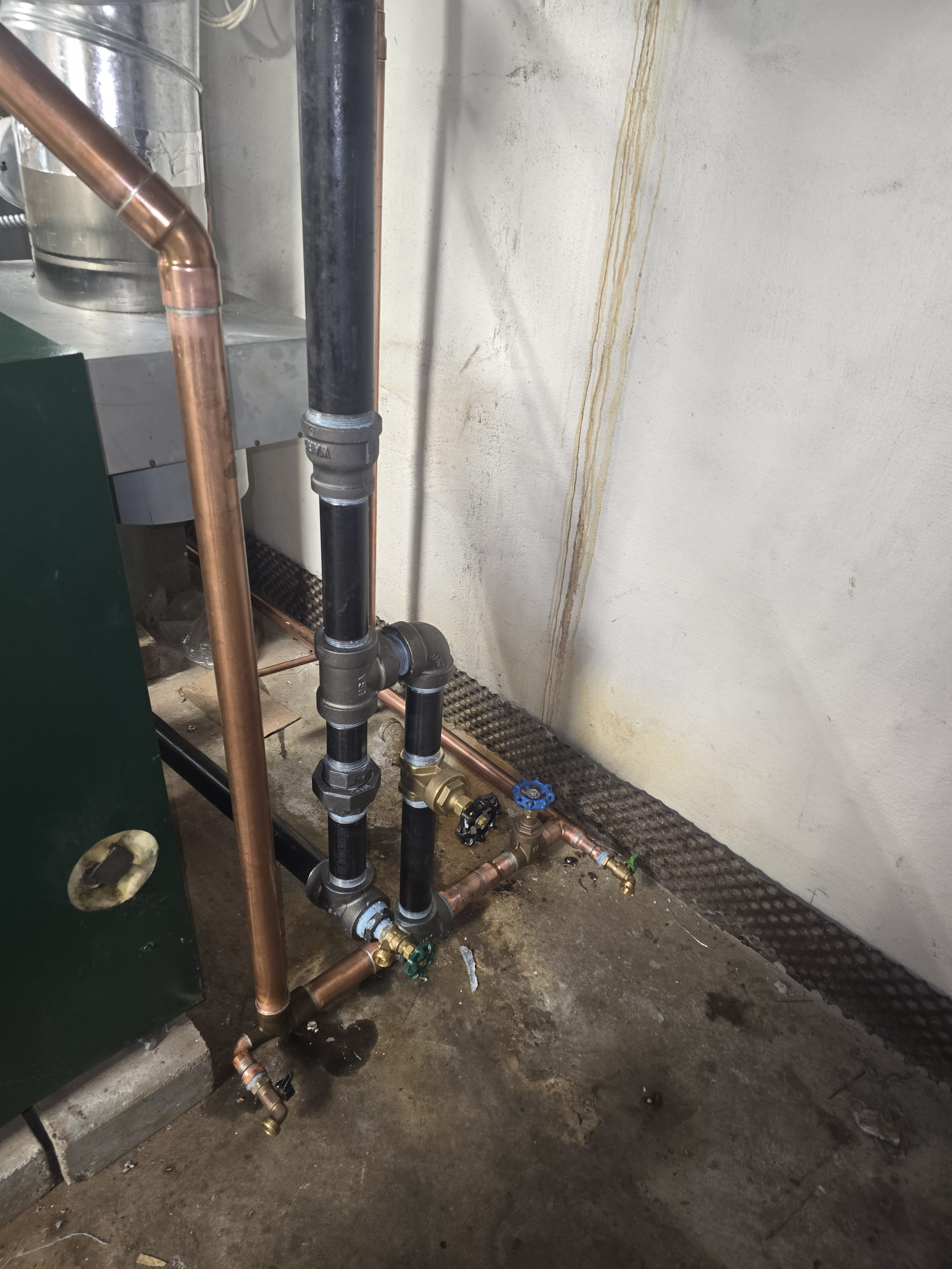

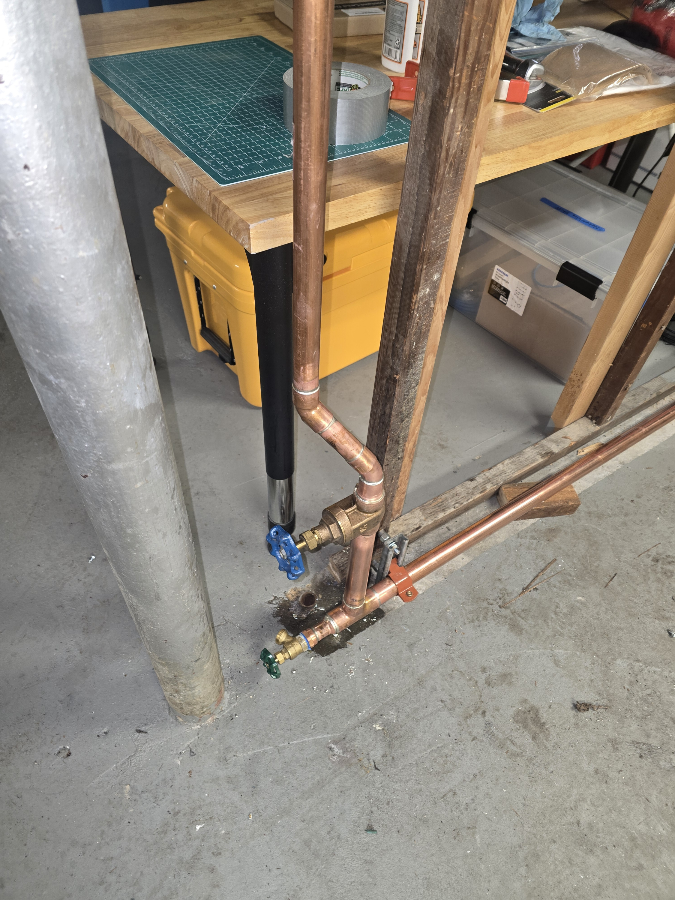

@Mad Dog_2 Why the extra drip off the header?
Trying to squeeze the best out of a Weil-McLain JB-5 running a 1912 1 pipe system.1 -
Its hard to see, but there is an 1 1/4" counter flow radiator branch that disappears in to a bad corner. I didn't want issues with it, so I dripped it. Mad Dog
