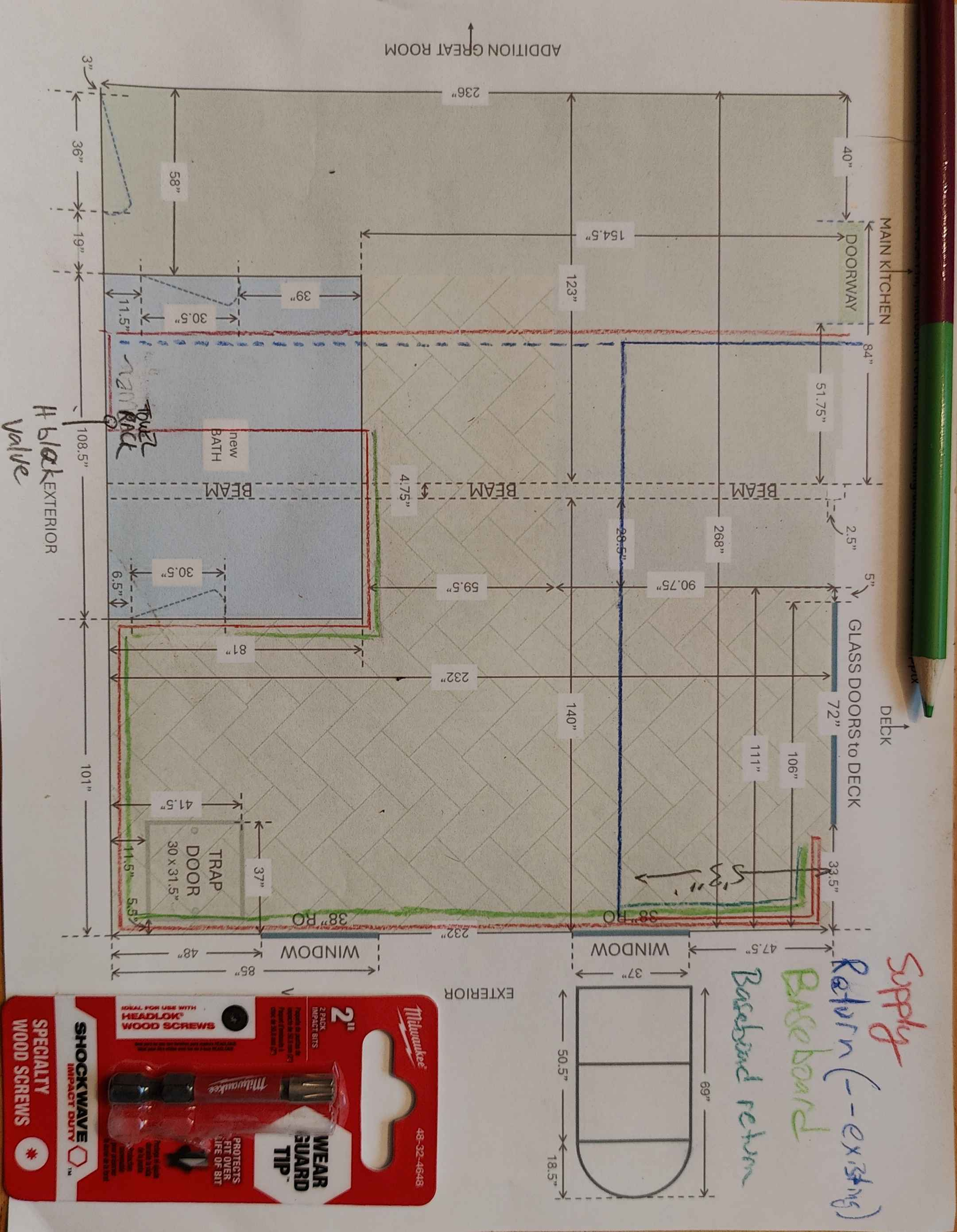

I installed a Hudson Reed towel rack with their H-block TRV in a new bathroom. I had been under the erroneous assumption that there was a built-in bypass in the TRV. As of right now, it's the only thing on this heating loop until more progress is made on this remodel, but eventually there will be downstream baseboard heat so I need to bypass this radiator when the TRV is closed.
Apparently that's what the slides in this thread depict, but In looking around for a valve sold for the US market, I've had little luck finding something designed for this (as opposed to zone control or low-water boilers). And most seem to be angled while a straight valve would be vastly preferable. Also, compared to what I found on Amazon UK, they're an order of magnitude more expensive here.
For the the ca. $25 to have the UK item shipped here, I'm inclined to roll the dice on it and see if the 22 mm fitting will seal on 3/4 in CTS copper (225 μm / 0.00886 in larger) and if the quality is acceptable.
Finally, I can't figure out if I want an auto valve or a differential valve.
It's a one pipe system. The supply and return pipes are next to each other.
This drawing is what I plan to do… The presently-removed green baseboard along the outside walls formerly connected to where the supply and return lines met the exterior wall prior to adding the bathroom. I want to add some baseboard to the outside of the bathroom (interior walls) and the bypass would basically go there from the towel warmer before it went to the old baseboard around the outside walls.

    Well, for one, it's going to be a nightmare to take it apart again. I plumed it with 3/4 in black iron going through the floor above the crawl space and I pro-pressed the last fittings together so… I really do not want to take it back apart.
    For another, I would think it would absolutely be preferable to be able to control the heat in the bathroom.
    That Danfoss presentation in the other Heating Help thread specifically suggests doing this for baseboards so I don't know that I'm really concerned about affecting the flow in the rest of the loop… either the TRV is open and it goes through the bathroom or it skips it and hits the interior baseboards first when the bypass is open, no?

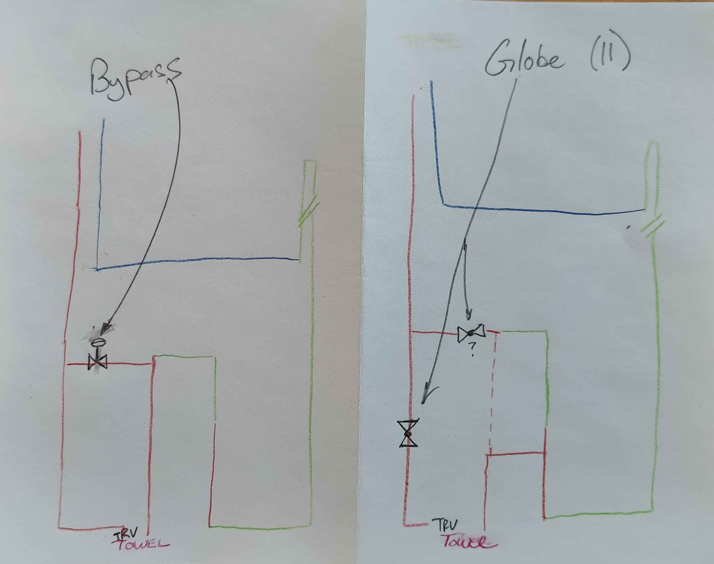

    Is there any hope — despite having gotten ahead of yourself — why you can't pipe it in parallel with the rest of the loop, rather than in series? Believe me, you will thank yourself if you can…
    mattmia2PC7060
  • iconoclasthero
    iconoclasthero Member Posts: 27
    edited February 2025
    Correct me if i'm wrong, but isn't that what I'm aiming to do, just with a bypass valve in it? But the short answer is, I cannot see any reason I can't if I understand what I'd need to do… there's lots I have room for in that crawl space.
    Jamie Hall Member Posts: 27,600
    In a sense it is — but the parallel arrangement won't need a valve.
    Put a T on the supply line to the rest of that baseboard circuit. Run a pipe to the TRV on the towel warmer. Then from the return on the towel warmer run a line to a T on the return from the first baseboard in the rest of the series loop.
    That will steal heat from that first baseboard when the towel warmer is active, but if that is a problem (it won't take all of the heat) put a balancing valve — a simple cheap globe will do — on the line to the towel warmer and fiddle with it until you are happy with the overall balance.

    So if I have this correct in my head, my original idea had been to put a purpose-built differential or automatic bypass valve into this loop as on the left. Jamie's suggestion was to run in parallel, ||, with a globe valve as shown on the right. I'm unclear as to whether the second globe valve (pictured with "?") would be helpful to make sure the bath is getting as much heat as needed.
    I'm fairly sure that I could revert back to my original idea by switching the "?" valve to a bypass and plumbing in the dashed red line (though I'd probably need to cut a shutoff in on the return branch from the towel) so that leaves me options.

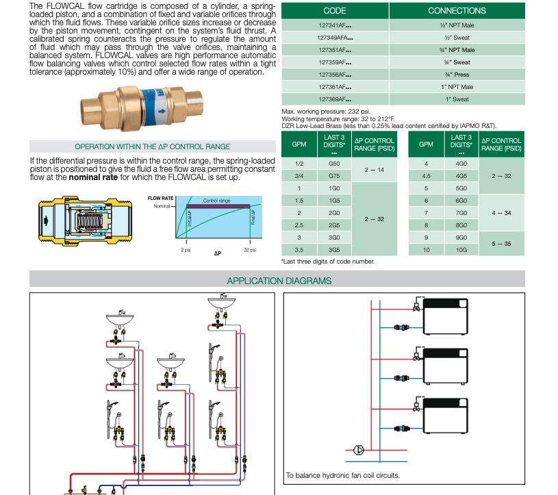

    There are other way to balance a emitter like that. If you know the desired flow you select the valve with that cartridge, a PIV pressure independent balance valve.

    With any TRV or balance valve a y strainer is a good addition to protect the small passageways.

    In case someone finds this later and is curious, I did end up plumbing it in parallel and plumbing in a regular globe valve on both legs to allow for manual adjustment once, presumably in a couple weeks.
