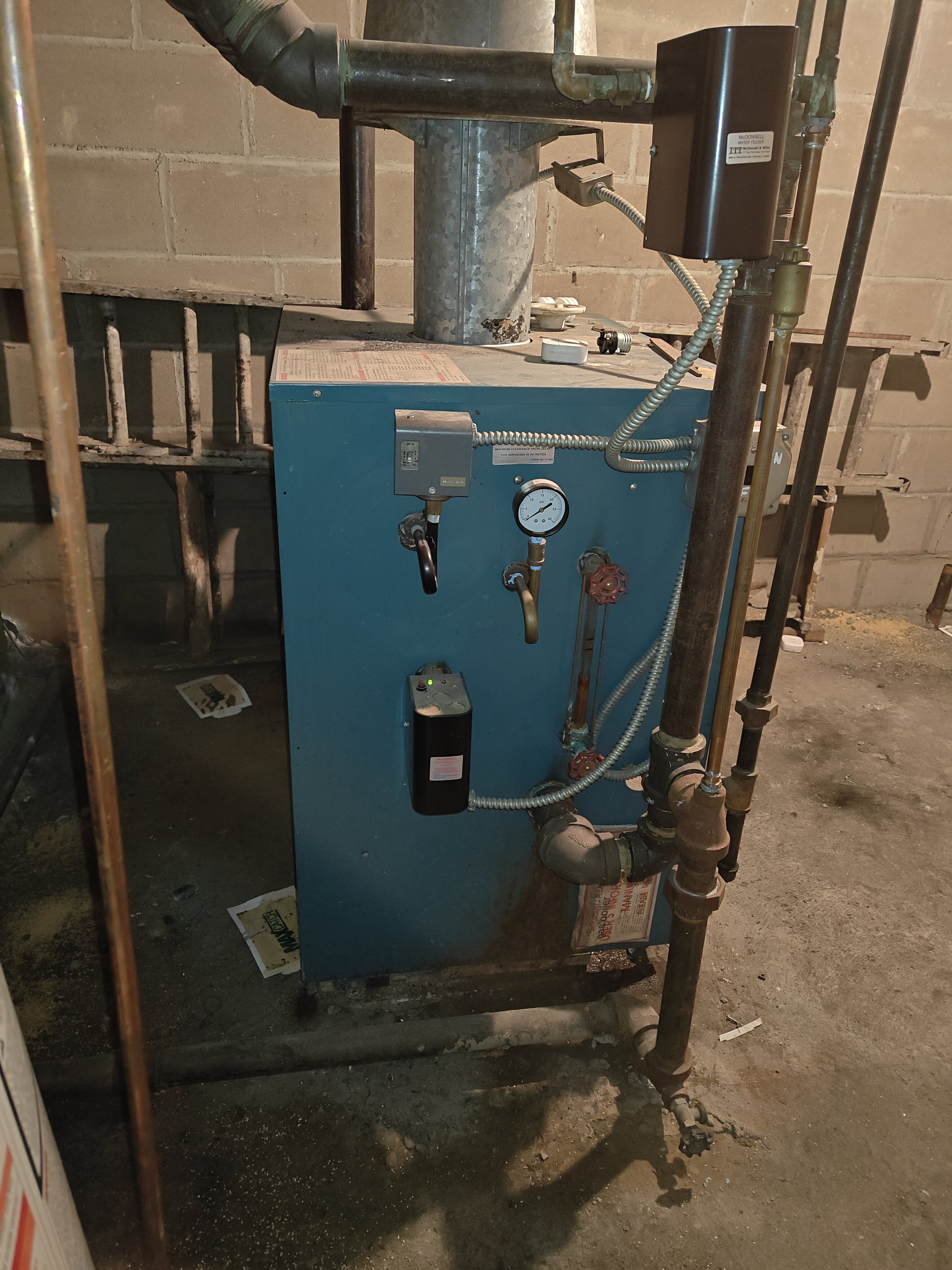

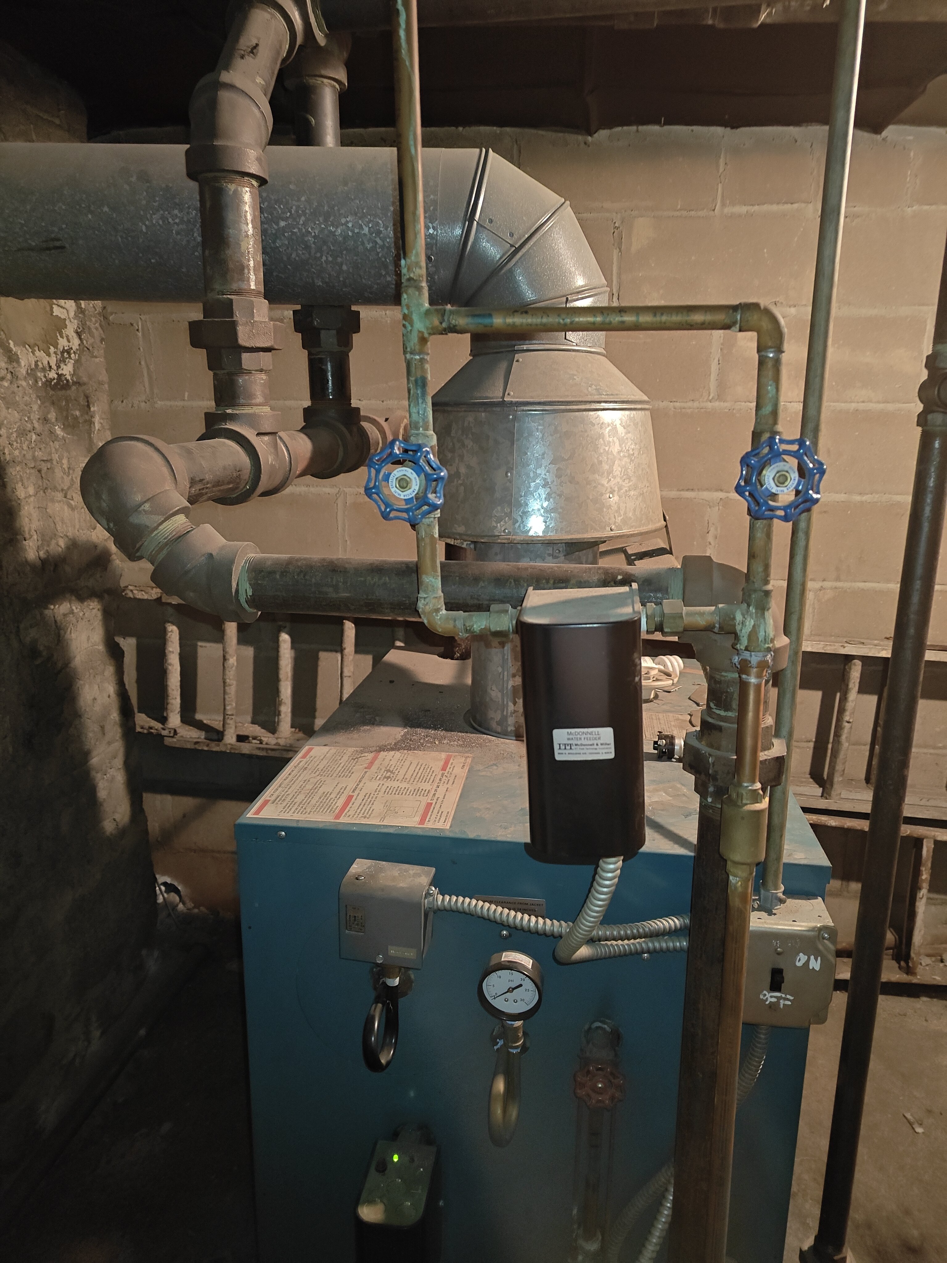

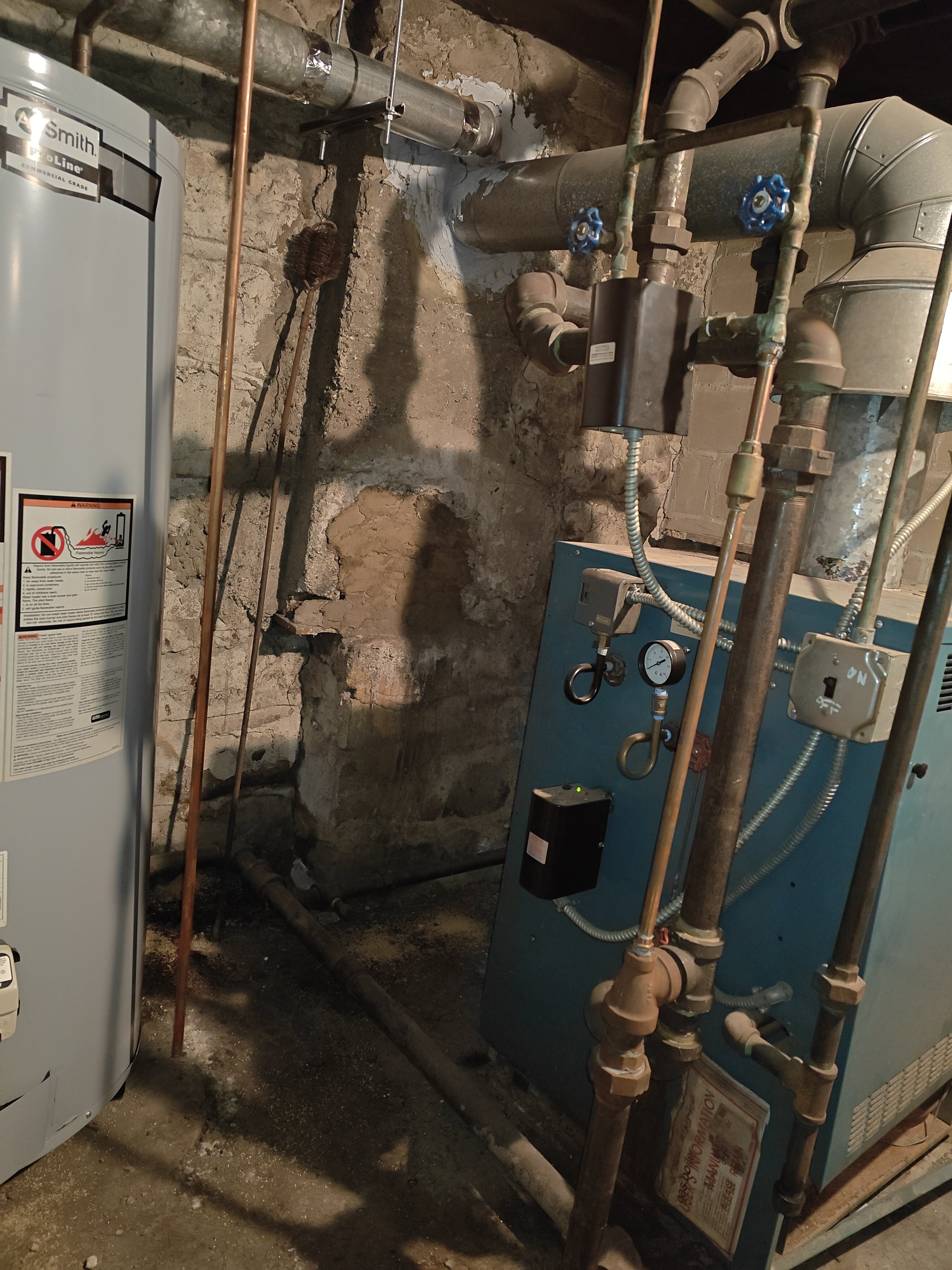

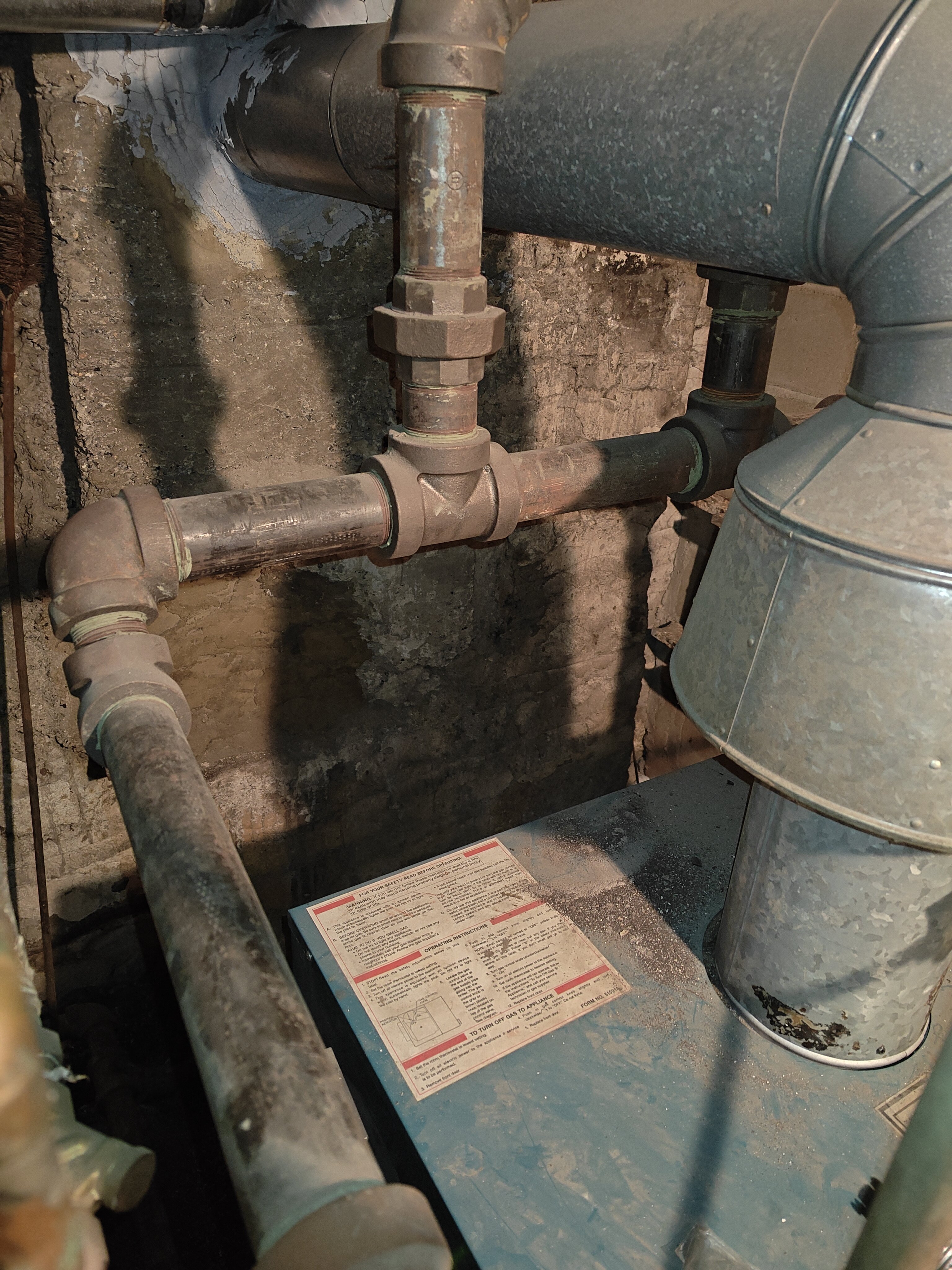

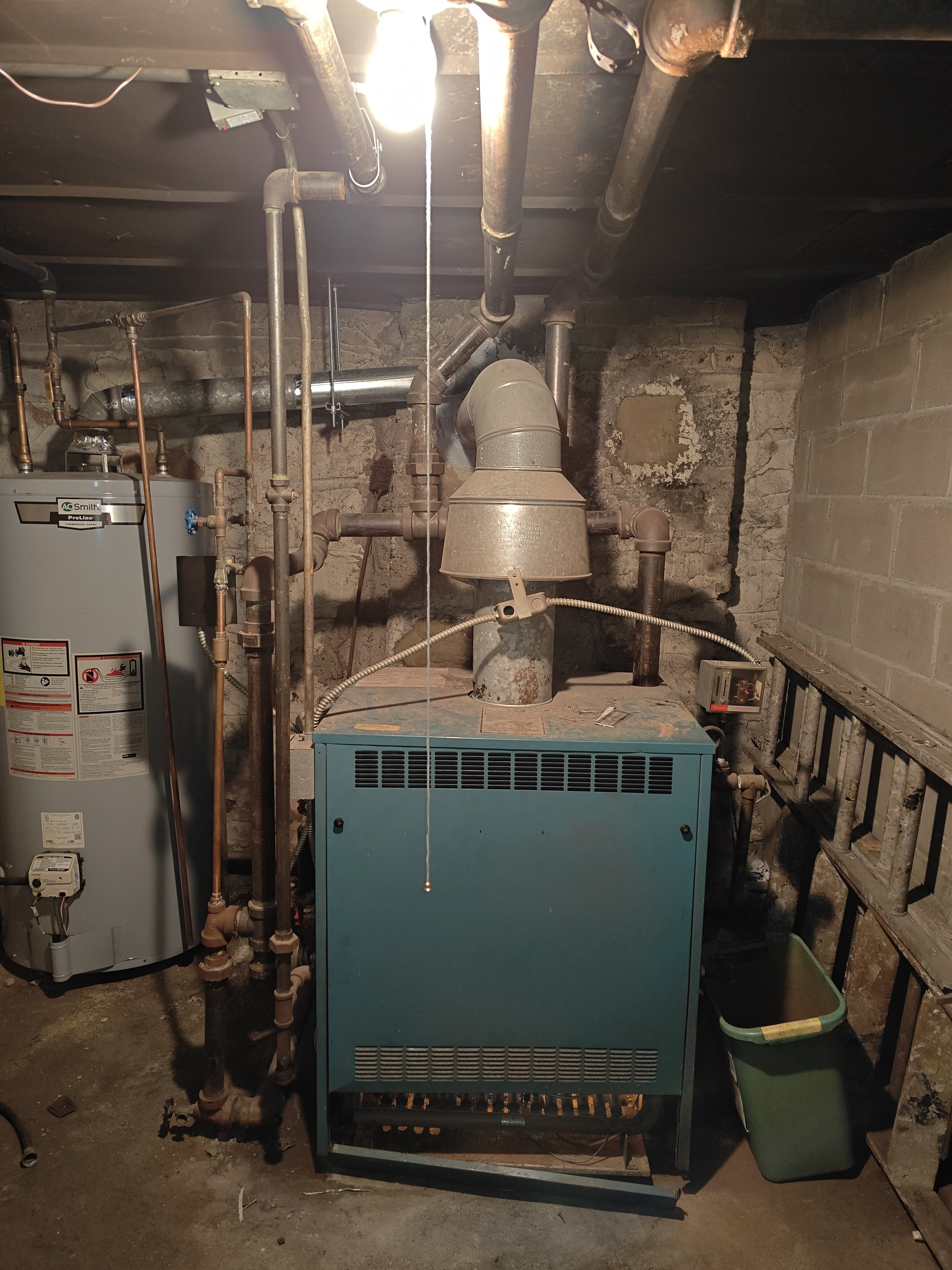

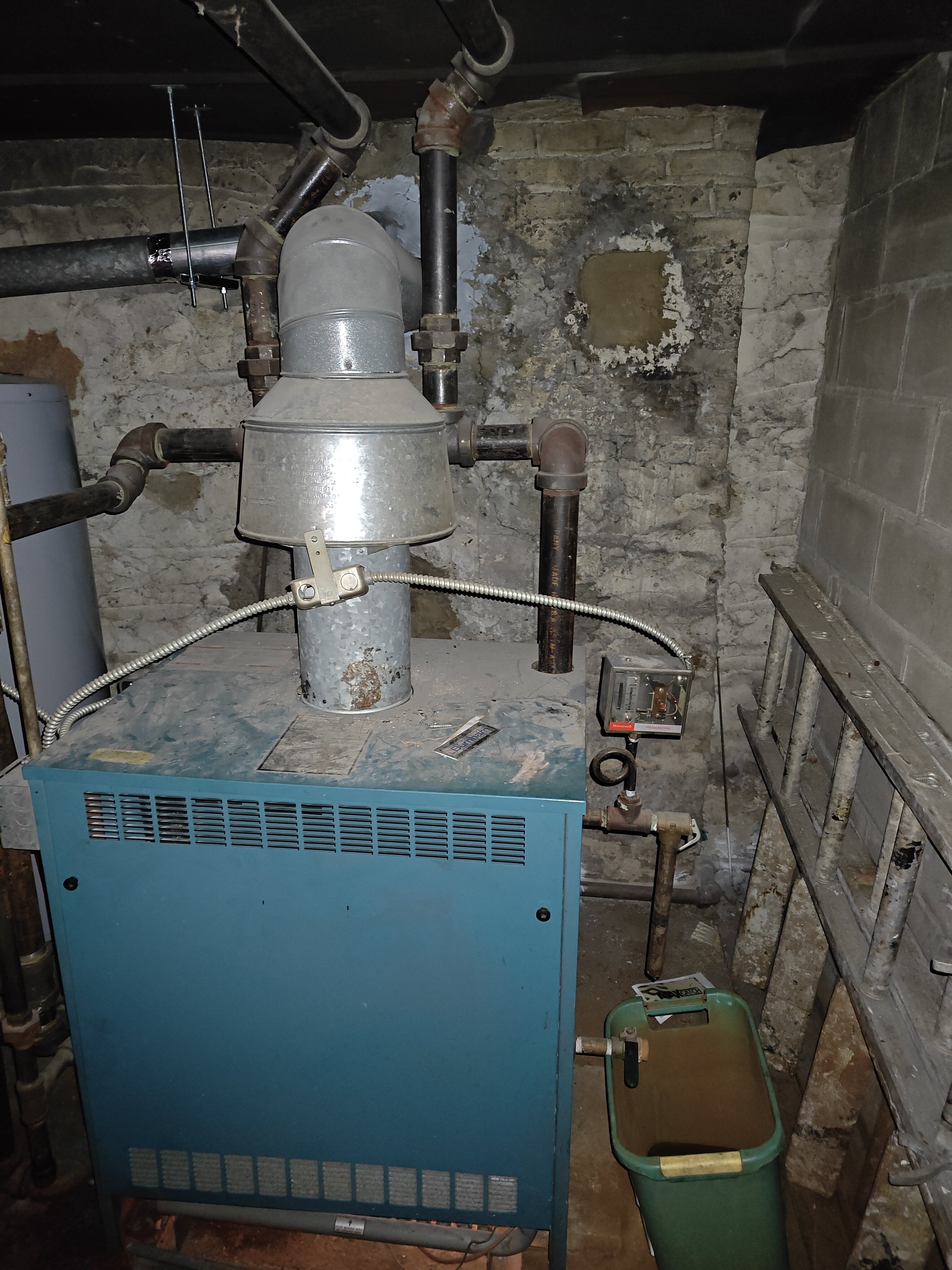

I’m a newbie to steam heating and boilers and I have some questions about replacing a gas fired steam boiler
A few years ago we bought a 4 Family house in Brooklyn, NY. its approx. 3200 sq ft, there’s 2 apartments on each floor and the basement is used for storage. The boiler is almost 40 years old, its a 245K BTU Burnham, (See images below)
I called my tech at the beginning of this season to service the boiler, and he told me that it has a crack and will need to be replaced in the near future. Over the last few months, it has been losing water and constantly needs to be refilled. I asked my tech for a quote for a replacement, which he provided.
Before I go ahead with the replacement, I want to make sure that it will be done correctly the first time around

Number 3 and number five are instant disqualifications. Boiler must be skimmed, and the only correct way to size the boiler is by measuring radiators.
Personally, I am not a big fan of king valves. Just one more thing to go wrong. Rather than coming up with all sorts of creative means to pressure bomb the sludge out of the boiler, it is preferable and possible to avoid the sludge in the first place.

And just to back up a bit. Are you certain that the boiler is actually leaking? Easy way to check is to fill the boiler above the top of the boiler, and see if any water comes leaking down onto the burners

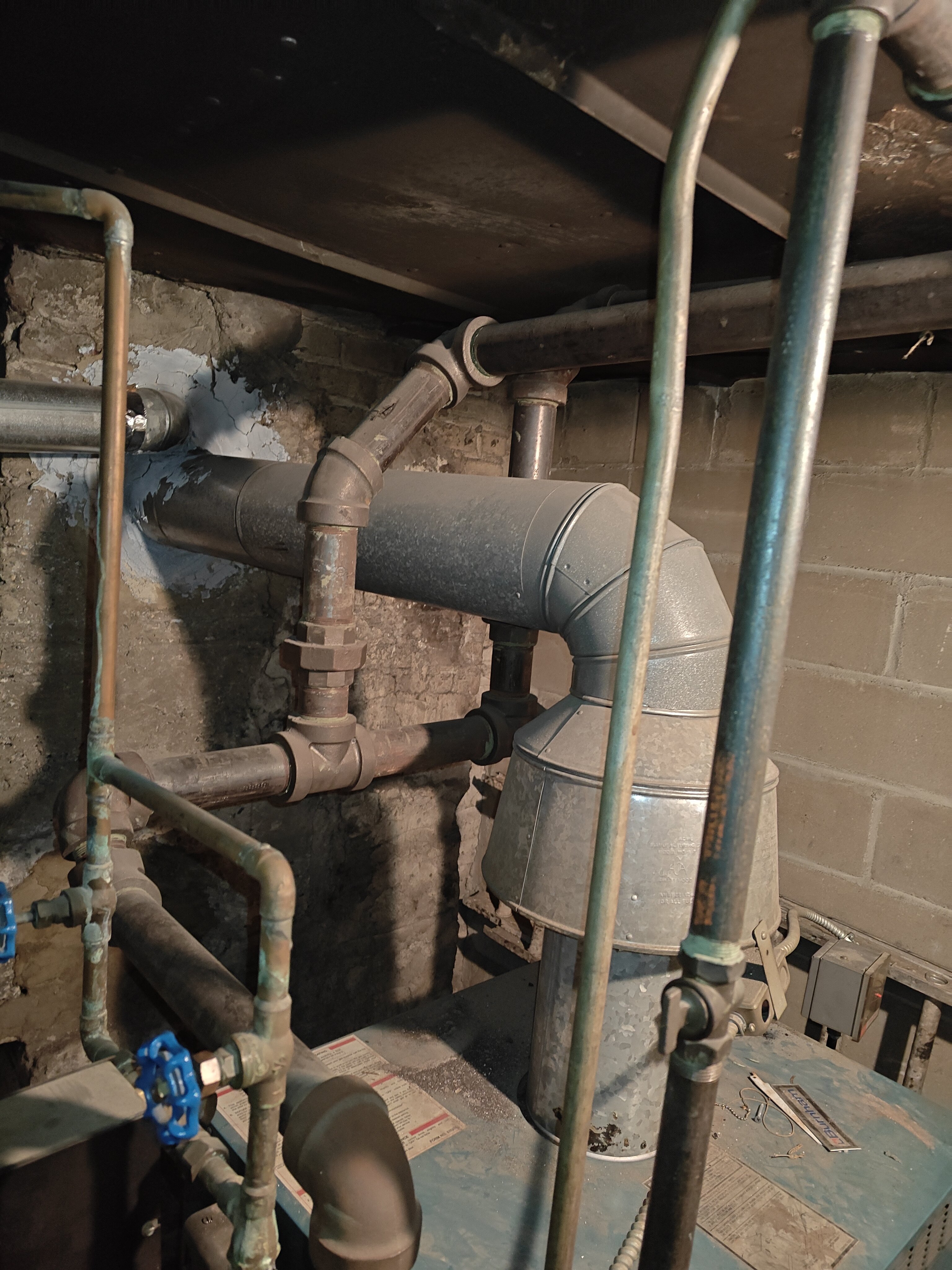

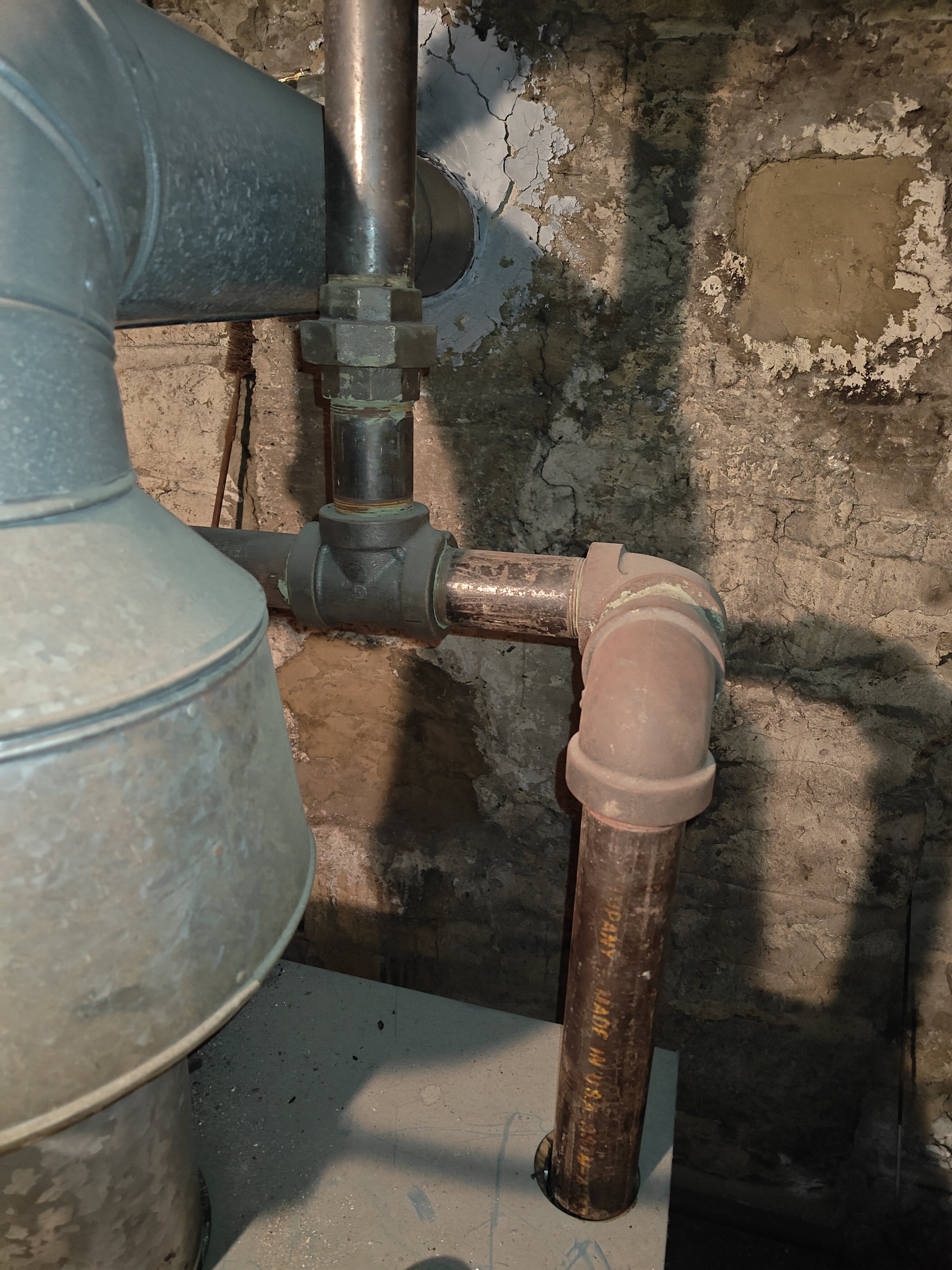

Make sure the quote says they will do the piping to manufacturers specification, including proper pipe size. The pipe size is important. The one they quoted needs 3" header, we see on here frequently that they don't like going over 2" piping, don't let that happen. Of course we don't even know if the quoted boiler is the right size.

Everything @KC_Jones said plus do the mamual fill test on your boiler to make sure it is actually the boiler itself that is leaking (not a return line or leaky vents...).
If you have been on this forum you are probably familiar with the radiator edr estimating tables. If not ask. See that 628sqft number on your boiler plate? That should match up to the total edr of your radiators. Ideally it may be 5-10% less. You should do this sizing yourself so you know. Nonetheless, a qualified steam guy would do it anyway rather than just basing off your existing boiler.

I did the test and got confirmation
I opened the water supply to the boiler and watched the level rise in the sight glass. As the level reach the top of the sight glass I heard water dripping and saw it pouring out over the burners
I lowered the water level to the higher black line on the sight glass and fired up the boiler. I went to the roof and saw clouds of steam coming out of the chimney. Within an hour the water level was so low that the LWCO turn off the boiler until the feeder topped it up
Looks like it's time to replace?

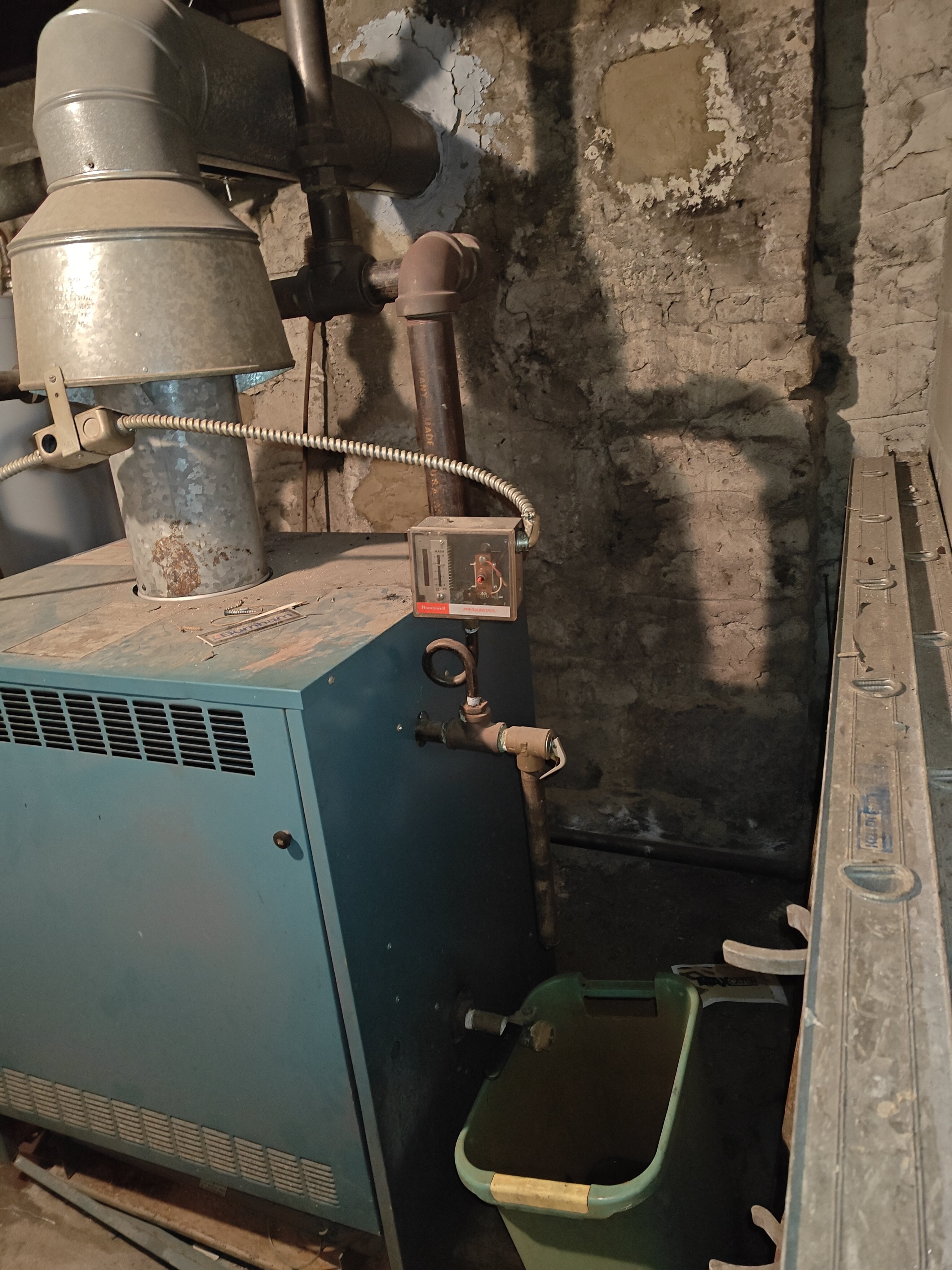

you can take the jacket and probably the flue collector off or look up with a camera or mirror to confirm it is leaking somewhere in the heat exchanger, there is a small possibility that a connection of some sort is leaking but if a section or joint between sections is leaking it is unlikely to be worth the labor to repair that if it is even repairable vs replacing the boiler

It is very likely a hole rusted in a section. it can't hurt to take the jacket off and confirm that but i'd be surprised if it wasn't.

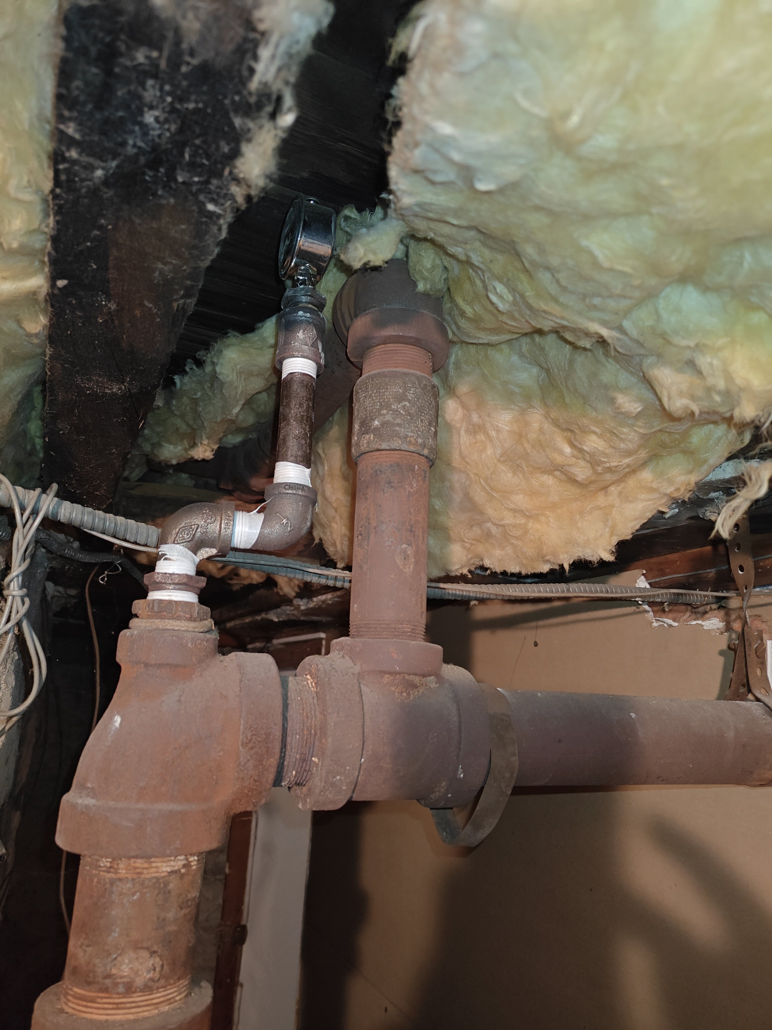

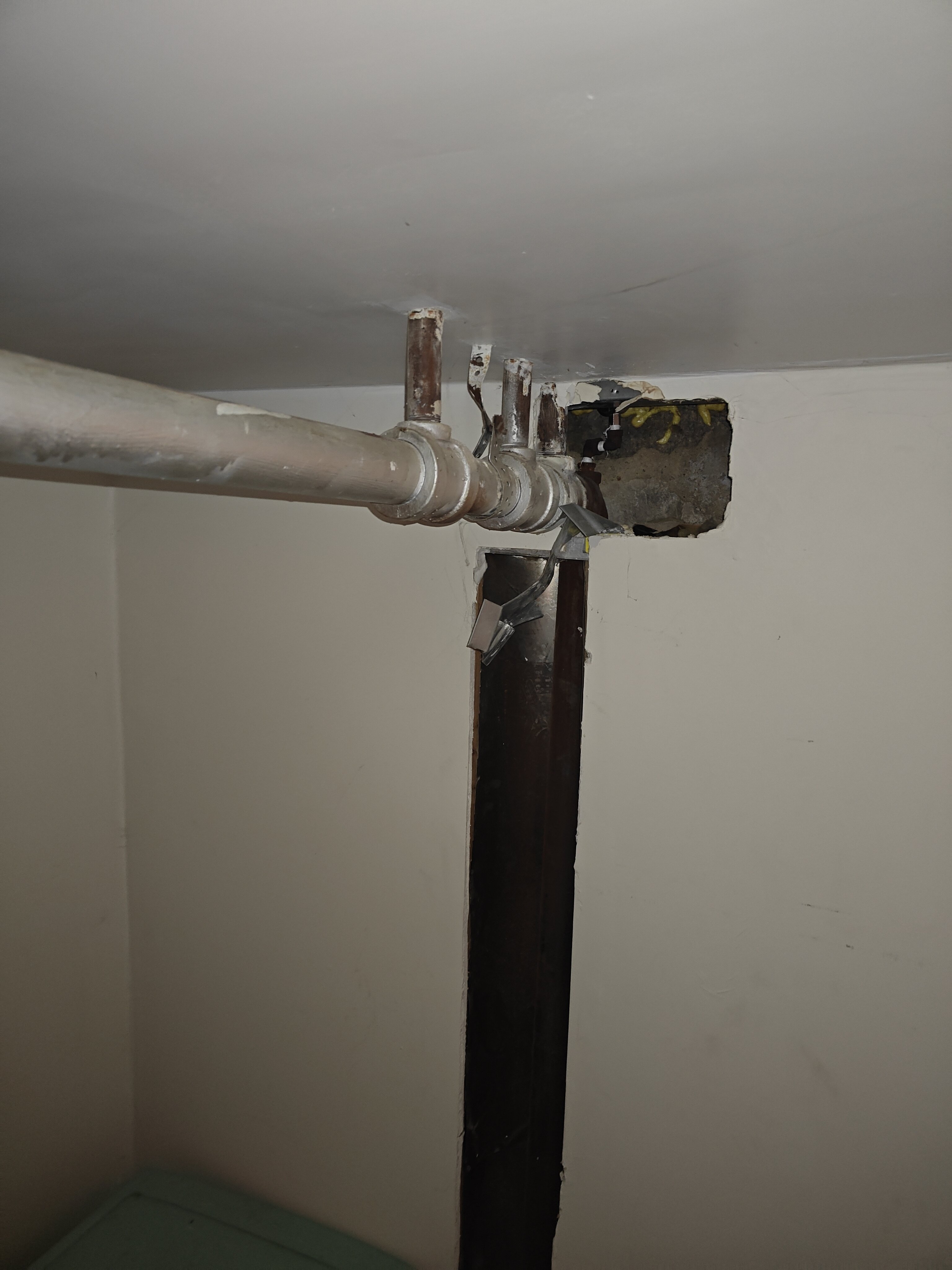

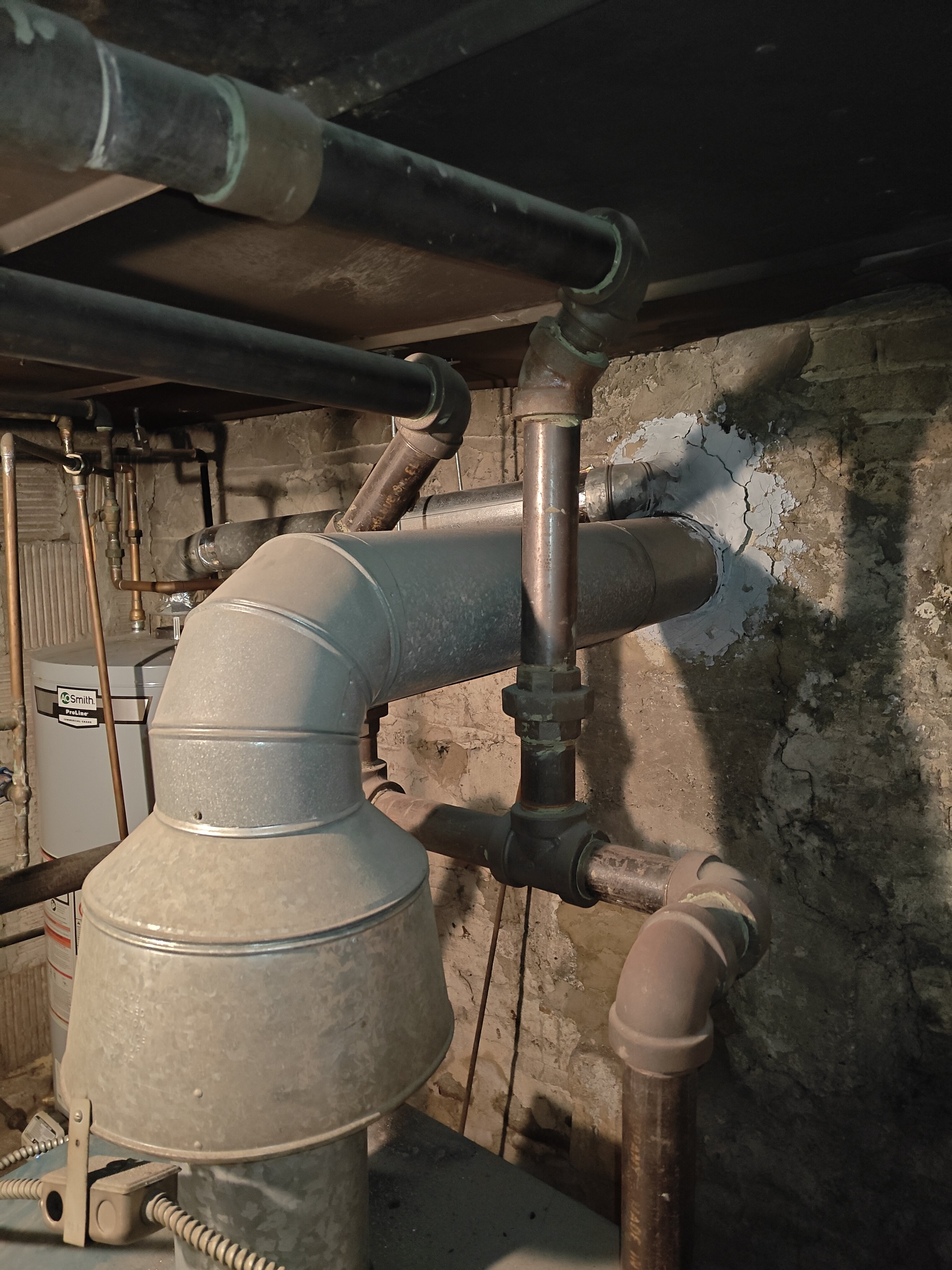

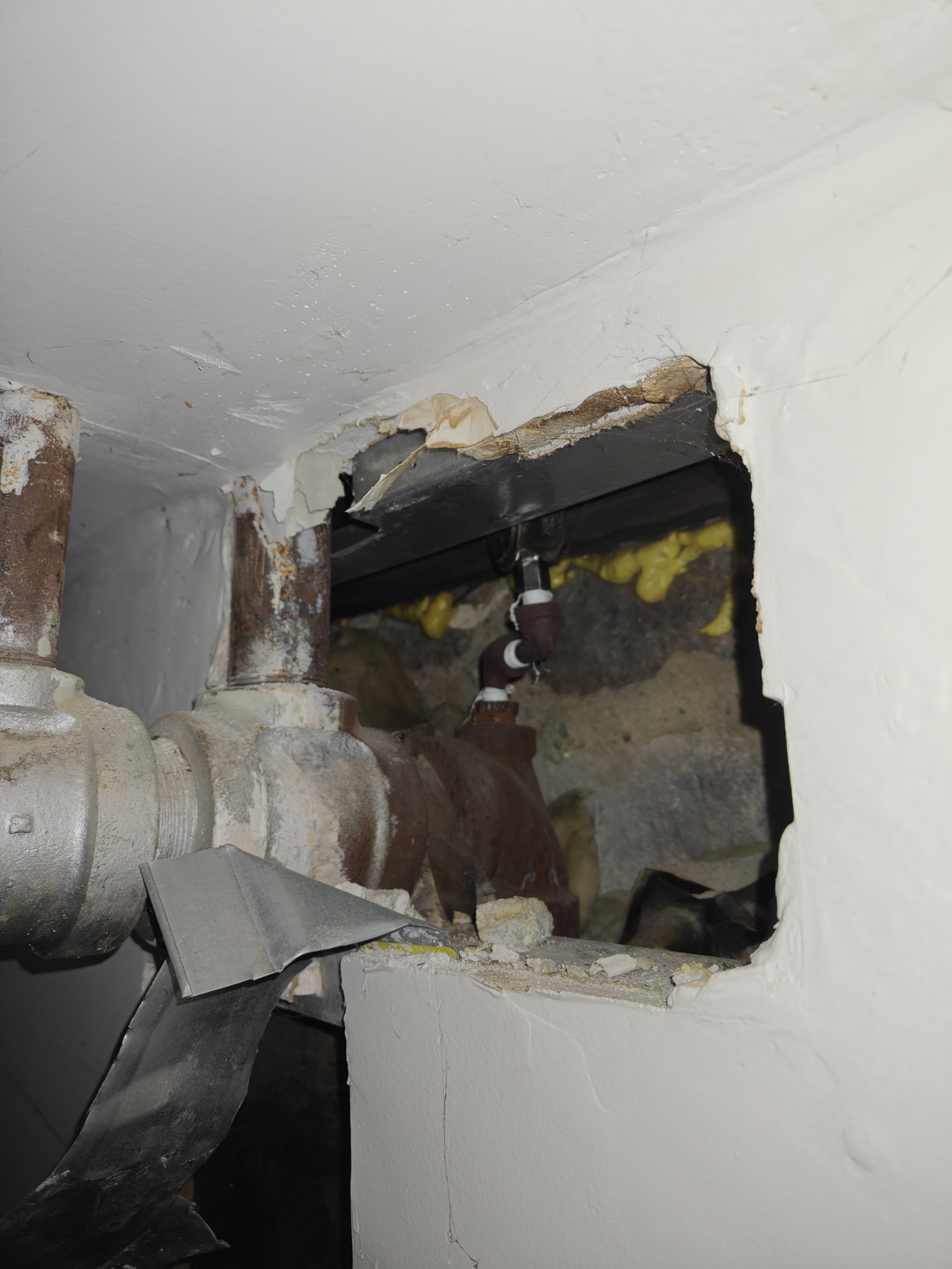

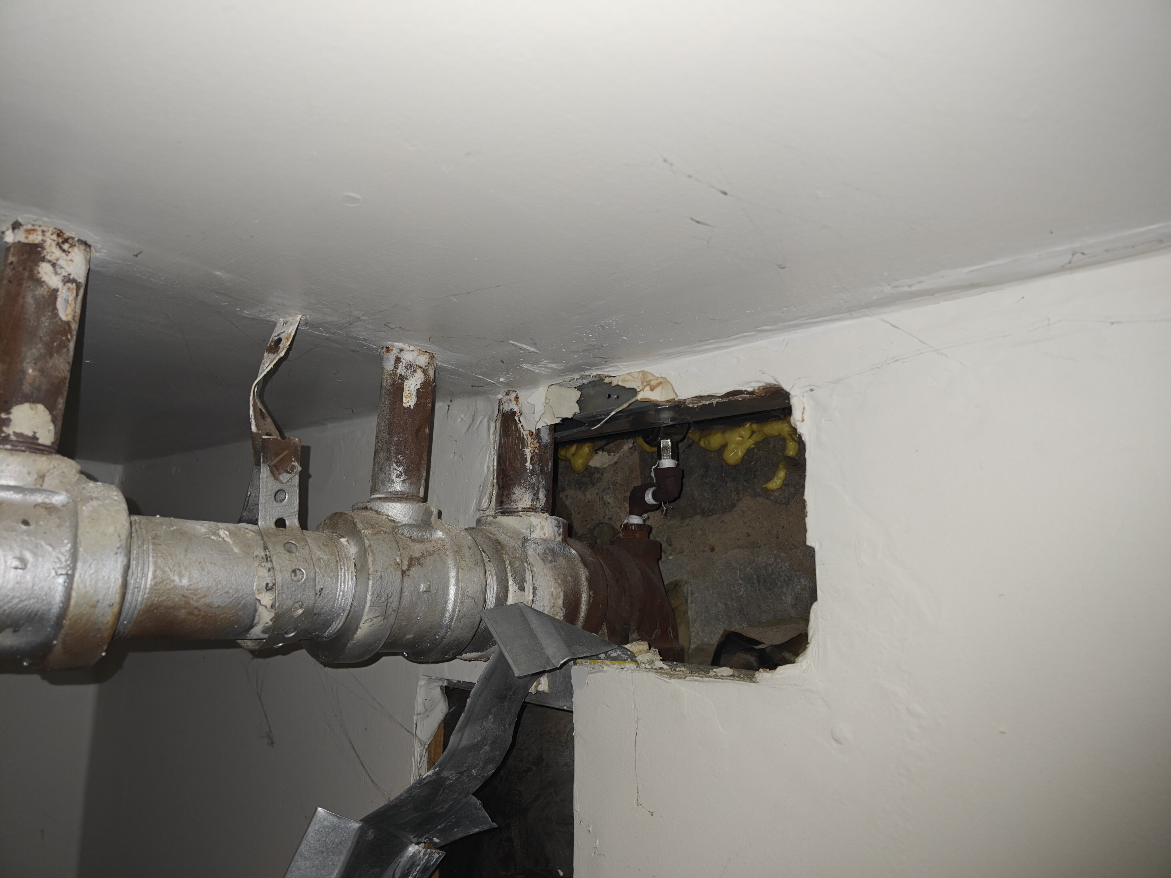

Can you show all the piping on the boiler, floor to ceiling, all sides?

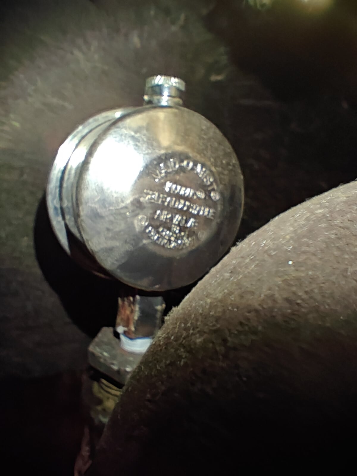

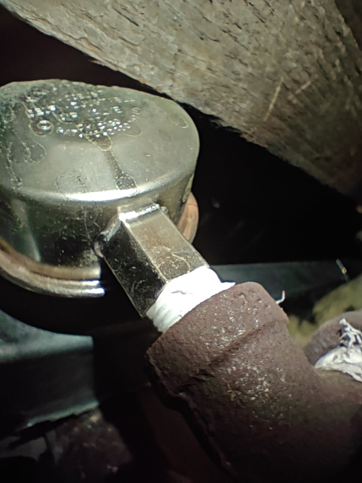

How about your main steam air vents also?
I’m a plumber in NYC in queens, see far too often guys around here just go off the size that was originally there. 100% have someone who measures and check all the rads as well as the near boiler piping and the main in the basement before deciding on a size and brand. I install, but personally don’t size them, if you’re looking for a trustworthy company in BK or the general area feel free to message me
