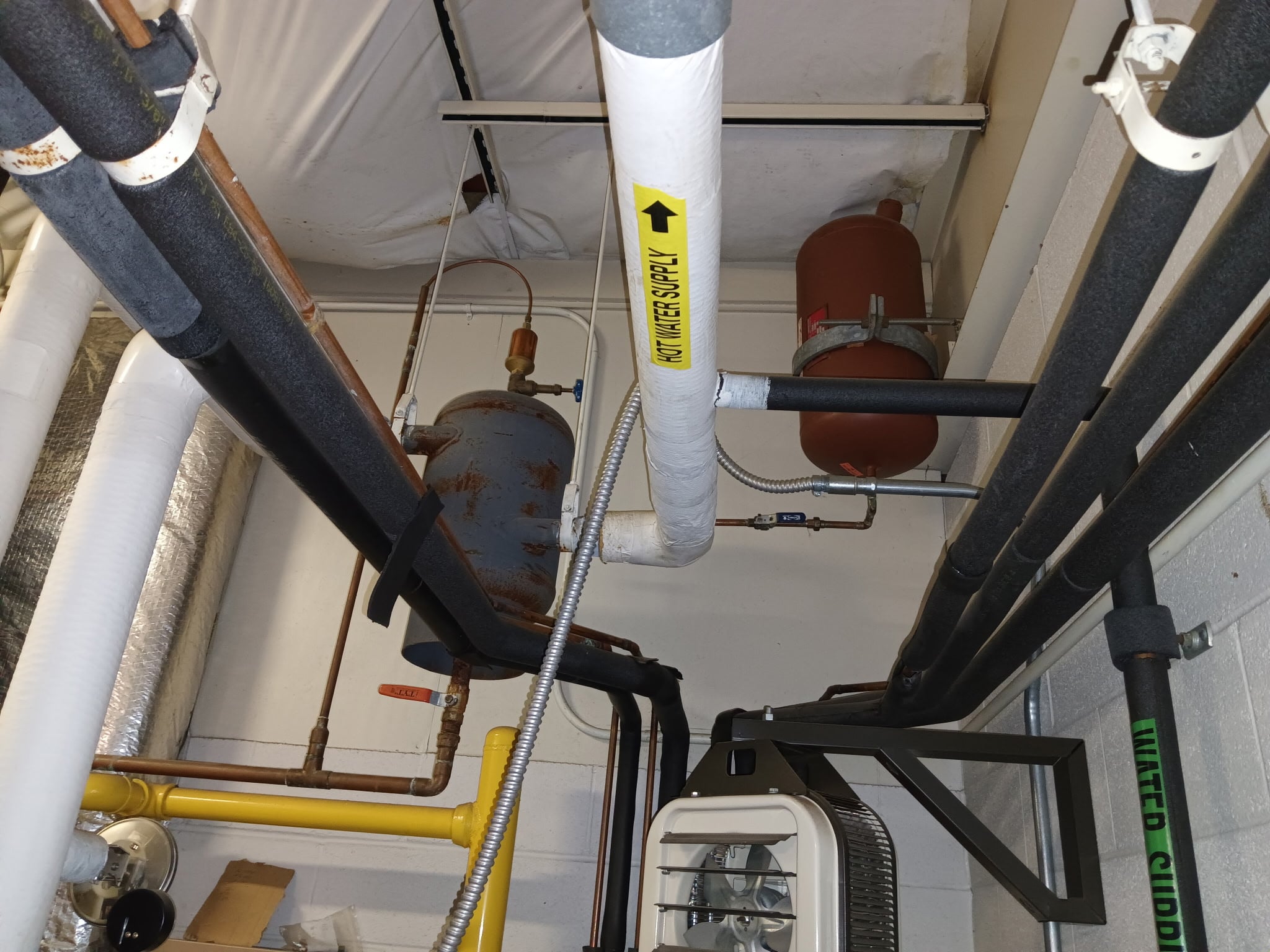

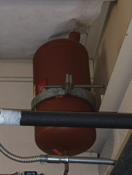

I couldn't reach the local page on this so I've got to bother you guys about it.
It's always amused me when I walk into a boiler room and see an Extrol tank with the lettering upside down. But now I'm a little humbled because in this boiler room the Extrol tank confuses me. I have not been there and don 't intend on going there because it's in Lexington Kentucky and I'm in Colorado. But the building superintendent is a buddy and asked me about some symptoms and sent pictures.
It's a 750Kbtu boiler serving two huge fan coils that are also right there in the mechanical room. They are the only load. A very large air seperator with a B&G vent on top and a tap for a nearby (and physically higher) ASME rated Extrol tank is on the suction side of the pump. Each fan coil has its own air vent (Hoffman) on the return side of its' piping. There is no automatic feed valve.
The original complaint was that the boiler needed continual refilling and the gauge responded instantly to his doing so. I told him his expansion tank was water logged and he had a leak somewhere. He found the leak in a failed Hoffman air vent associated with one of the fan coils and replaced the air vent. During that process he checked the air charge on the tank and it was 1 psi. He charged it to 15 psi but on further examination discovered there was no water at all on the water side of the bladder. In other words, both sides of the bladder had air.
The tank is oblong but is mounted vertically near the ceiling.. The air valve is on the high end at the ceiling and the boiler connection is on the low end. There is no mounting "base" or "stand" on either end. The writing on the tank is oriented along the long axis and so one has to turn ones' head sidewise to read it. I told him the tank was mounted upside down and too high and that he needed to move it to floor level, turn it so the air valve was on the bottom and the boiler connection was on top and reconnect it to the boiler. allowing boiler fluid to enter the tank.
But then I got to thinking and told him to hold off until I talked to you guys ……
What bothers me is the lettering on the tank.
If I were in the business of fabricating tanks I would definitely put my name on it so it could be read without standing on ones head or turning ones head sidewise. BUT IF THE TANK IS OBLONG, AND THE WATER INLET IS CENTERED ON THE TANK, HOW DOES THE WATER SIDE OF THE BLADDER GET FULLY PURGED OF AIR? I mean, during the filling process air WILL be trapped above the level of the water inlet of the tank on the wrong side of the bladder!
I'll quit now and let you guys think this over. Sorry to be so wordy but I'm trying to be precise and give you an accurate picture. (And the picture below should help)

    A bit of confusion here. You have supplied two photographs and they contain a total of THREE different tanks. Please indicate WHICH tank in the photo you are having trouble with. Three tanks: 1. gray, 2. red. 3. blue. If the tank is entirely empty of water, that is not right. The side of the tank that has the pipe connection should have water in it. Your system pressure should be relatively low. Under 20 psi. The 'other' side of the tank should be hollow—when tapped or rapped on. You can only test the air pressure with the tank isolated from the system. An expansion tank can be mounted in any orientation. The writing on the tank orientation is meaningless.

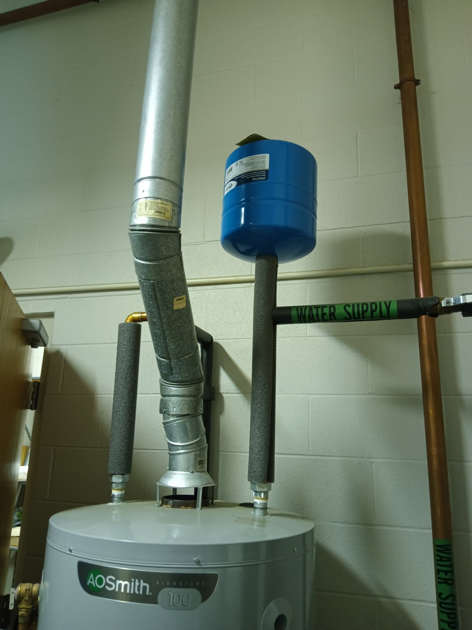

    The blue tank —not an "Extrol" tank (#PFX T121), appears to be on the supply side of a domestic gas heated water heater. It is NOT on the heatring system. The tank pressure on that system will should be higher—28 or 38 psi. i.e. 2 psi. below the "cut-in" setting on the pump switch.

    There is nothing wrong with that mounting orientation. How did he determine that the water side was dry? There is no drain or test port there to check. If it's not taking water without spiking the pressure, something is closed, the bladder is compromised, or the charge is wrong. The water side needs to be dropped to zero before fiddling with the air side. Once that water side is open (maybe disassemble the union after the valve is closed), fill the air side to whatever the desired water side pressure will be. Use two different low pressure gauges, not a regular automotive tire gauge. When that's set, reassemble the water side and fill to desired pressure. All done, unless the bladder is compromised.

    I think the way it is installed it will collect air in the system over time similar to a compression tank. The issue is that since the bladder won't let this air rise to the top, each the system system cools down and the pressure drops, this air is pushed back into the heating loop. I guess over time the air eliminator will remove it but will take many cycles.

    I believe that all three of the installation images provided by Alan Forbes are 3/4 filled with air and 1/4 filled with water. I can't imagine any other scenario. I also believe this tank installation scenario defeats the holy grail sought by those who believe the correct way to handle air in a closed loop system is to expel it from the system by mechanical means.
    Speaking to Ground Up, I acknowledge being annoyed that my original statement about the tank being completely empty of water was not taken at face value and apologize for not giving your question more attention. To answer your question though, it was determined that the tank had no water in it when the union just upstream of the tank was broken and no water came out. That having been determined, the operator decided that tank filling protocol was irrelevant until the cause of the empty tank and the pegging pressure gauge was determined. That's when he called me. Prompted by your message here, however, I have advised the operator to disconnect the union again, crack the valve next to it to see if boiler fluid is available there, and to run a rod or something into the tank to rule out the tank inlet being filled with crud (and perhaps discover that there is in fact water in the tank). The manner in which it is piped would promote rust, crud, and corruption at that location. This scenario would explain all the symptoms described by the operator because the air cushion would in fact be isolated from the system in general due to a blockage at the inlet to the tank.

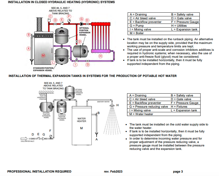

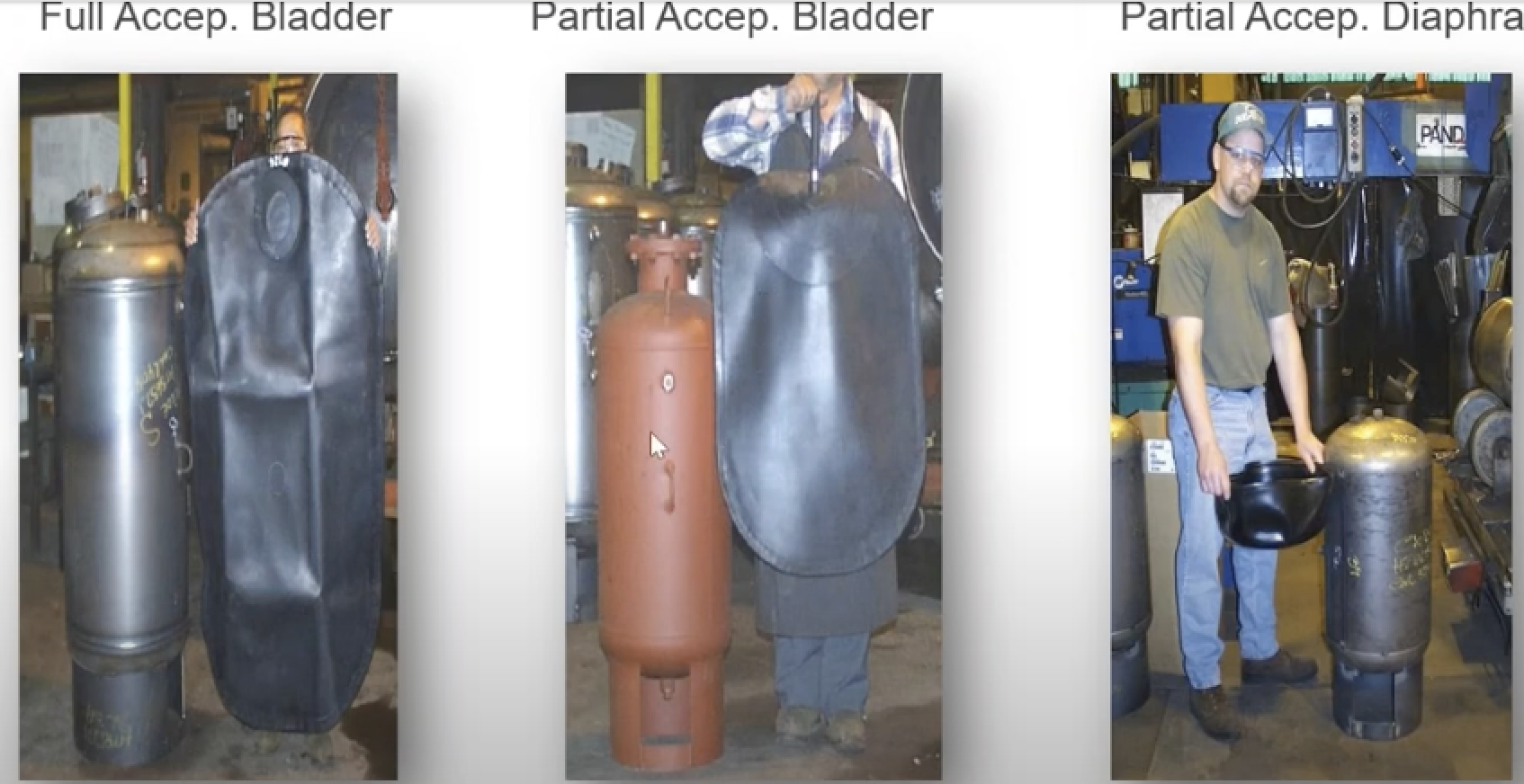

    Here is the installation instructions from Zilmet. They show hydronic and potable tanks in any mounting position.

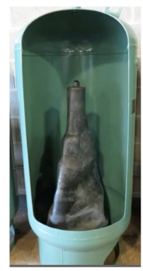

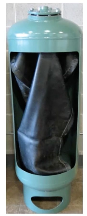

    I think the tank in the original post may be a partial acceptance or full acceptance style.
    So it has a bag inside. The bag or bladder can be top or bottom connected on the tank, depending on if it is a partial or full acceptance tank.
    The selling features are a longer lasting tank, the fluid is in the butyl rubber "bag" and much smaller size than a compression or even diaphragm style tank.
