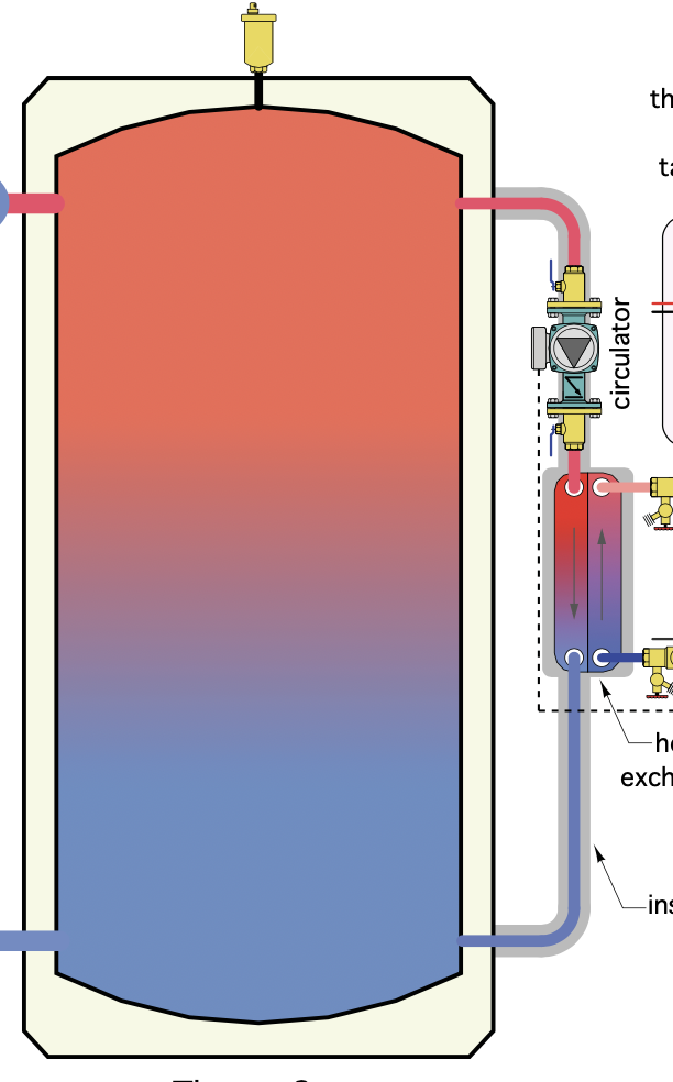

    I do believe EK has the best DHW solution with the external plate HX. Performance will be much better than a coil in tank design. Simple to service or replace with off the shelf tank or HX.

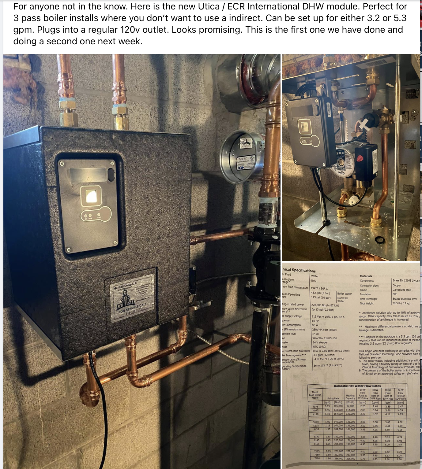

    There are some prebuilt external HX modules around. I think Utica still offers a DHW module. It is simple to build your on.

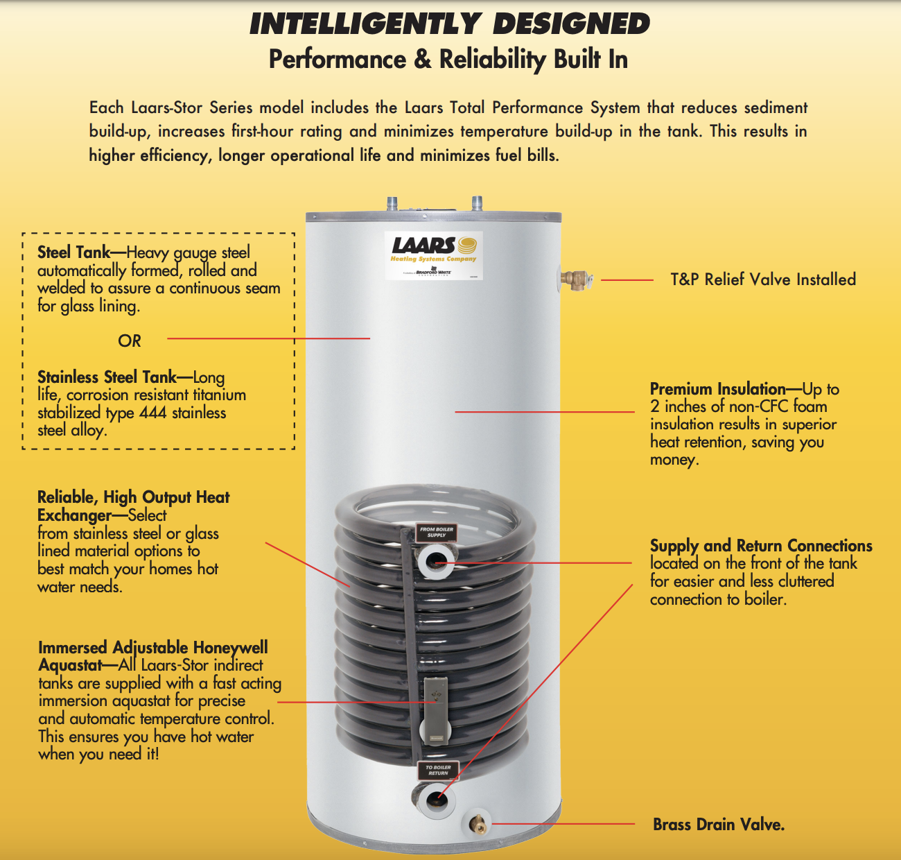

    If not a separate I prefer a glass lined steel tank. Laars, Bradford, Bock and a few others offer them with large smooth coils.

    So would you or someone have a diagram on how to plumb and wire one?

  • Bob, thanks for your reply. Unfortunately I can't see the whole Pic. So with a CI boiler I would have a circulator going to the HX. Then ,like my current setup, I would have the bronze circulator going from the HX to my current tank. I would plumb in a bypass for descaling.
    So would the 2 circulators be wired to come on at the same time?

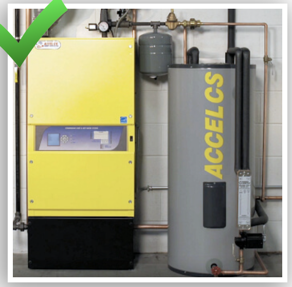

  • Now that is what I want my installation to look like.
    Not this
