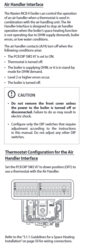

    I just figured out that this wiring design will not work because the the A/H contacts are open (OFF) when there is no thermostat call for heat from a thermostat. Without a call for heat from the thermostat then the contacts can not close (turn on). If the contacts are not closed then the thermostat signal can not get sent to the TAM 7 because the R8222 relay contacts are open and will not allow the TAM 7 to close the end switch from (P4) from the Hydronic Heat Control. That in turn will not activate the SR502 zone thermostat to start the pump and send the signal to the Navien.
    Basically this approach needs the Navien to call for heat before the A/H contacts close and the A/H contacts need to be closed before the Navien can call for heat. "Catch 22"
    This must be resolved by a series of additional relays that will allow the TAM 7 to start the boiler. This will take some time to resolve.
    I just got off the phone with Navien Tech Support and it is an easy fix. use the DHW Pri contacts that are right next to the A/H contacts. They do the same thing but start out Closed and they start out open and stay open until there is a call for DHW, unlike the A/H which close on a a call for heat and Open on a DHW demand.

    Before we do that… some new info:
    • To your question on whether the contacts stay closed, they do. This is audible w/ a continuity tester, with no breaks
    • By removing the W from the relay and tying them together, then triggering a DHW call, the relay stays powered with NO DROP OUT. I mean when wired like this:
    This is telling me that cutting the heat call jostles the Navien enough to make some sort of continuity break, or enough to signal the relay to drop out, then pull in again, over and over. I wish there was a way to detect this with the meter, but either way it is clear when/why it is happening.
    Even with the PDT102 installed, I expect it to do the same thing, after the delay kicks off
    Someone at Terry Love suggested early on that a water flow switch on the DHW hot outlet might work, but I was focused on the relay and didn't want to go opening up the plumbing. Maybe it really is the only way to make this idea work reliably.
    If the DHW PRI contacts do not stay closed for the duration of the DHW demand, then you will need to install an After market flow switch that will do the job without depending on the Navien circuitry

    What generates the DHW call, the flow sensor in the boiler ?
    " This is telling me that cutting the heat call jostles the Navien enough to make some sort of continuity break, or enough to signal the relay to drop out, then pull in again, over and over. I wish there was a way to detect this with the meter, but either way it is clear when/why it is happening. "
    To me, the thing is, on short DHW calls the PDT102 should not allow the relay to energize, so nothing should be jostled, right ?
    An interesting note: Depending where you look in the manual the terminals for the DHW PRI and the A/H are reversed !!! Are they accurately labeled on the unit ?
  • giantsean
    giantsean Member Posts: 116
    Yes I believe once the boiler senses an opening of the tap it will activate DHW. I do not know how a call for heat (or lack thereof) affects it though… When the W wires are closed (nutted to each other) the relay works fine and does not cycle on and off, even when passed through the DHW terminals. I kind of wonder two things:
    • Maybe the act of turning off the heat call resets something in the boiler, where all the relays that run those terminals reset, even if they start closed (like during a DHW call)
    • Also I have found grounding/shorting A/H and DHW to sometimes make the difference, Perhaps the way it's wired they are somehow shorting back to the boiler somewhere unexpected, since it's two W on the same relay?
    I get what you are saying about the PDT102 but eventually after the delay it will just start the same process as in the video… the relay will close after the delay which opens W, then will immediately close, which maybe will start the delay again? I have to try it.
    I did indeed notice that they are sometimes reversed on the diagrams! Not sure why though. Most times the book has A/H on top and DHW on the bottom, and that is how they are on the board.

    You fellas ready for this? 😂
    I went down to test what would happen if the PTD102 was wired in as 109_A5 suggested. As it turns out, I was right about it just delaying the effects I have already been seeing (though oddly, when the delay was set for really long - like 5 minutes - it seemed to keep the relay pulled in longer… might have been a fluke though).
    Out of frustration I tried a couple different combinations of hookups… all same result. THEN I remembered this note about DIP SW #7. I figured… what the @#$%… couldn't hurt to try flipping it from OFF to ON… turned on the hot water and BINGO!!!!!!!!!!!!!! THE RELAY STAYS PULLED IN!
    I am presuming that turning off A/H Interface mode removes that function from the system, and perhaps it works in conjunction w/ the DHW terminals (see below notes talk about stand-by mode). Maybe cutting W tells the boiler to momentarily flip out of stand-by… don't know don't care… it works! (again lol.. hopefully this time for good!)

    I'm guessing it at least turns off that relay, and maybe (to my benefit) ignores what is going on in terms of what the DHW call is doing. I'm actually thinking of calling Navien (I can make myself sound like a fairly convincing tradesperson even though I'm not :D) and asking then specifically what might be happening with my…ahem.. my "customer's" setup lol.
    109A_5 Member Posts: 4,346
    Well if it works better in that position " Space heating Thermostat - Unused ". Does a call for heat still work ?
    The PTD102 should block the short DHW calls.

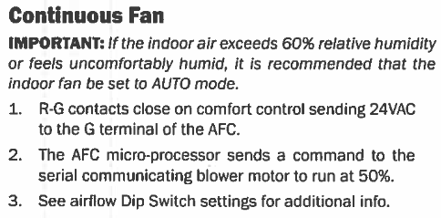

    That makes sense when you have a PSC blower motor. The TAM7 is equipped with an ECM variable speed blower motor. You just can't open the "Heat Speed" wire with an Aquastat. I would have suggested that much earlier, if that were the case.
