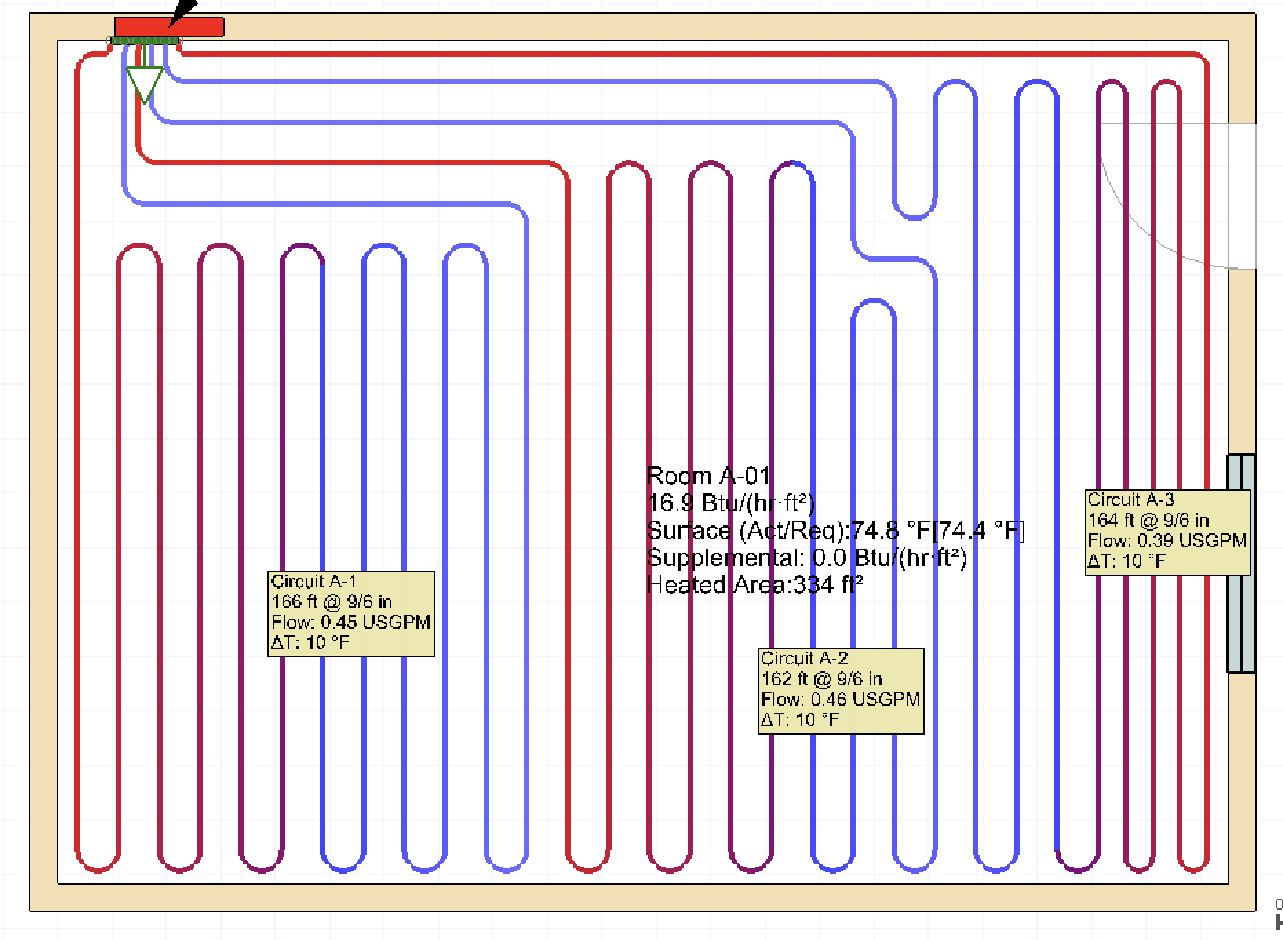

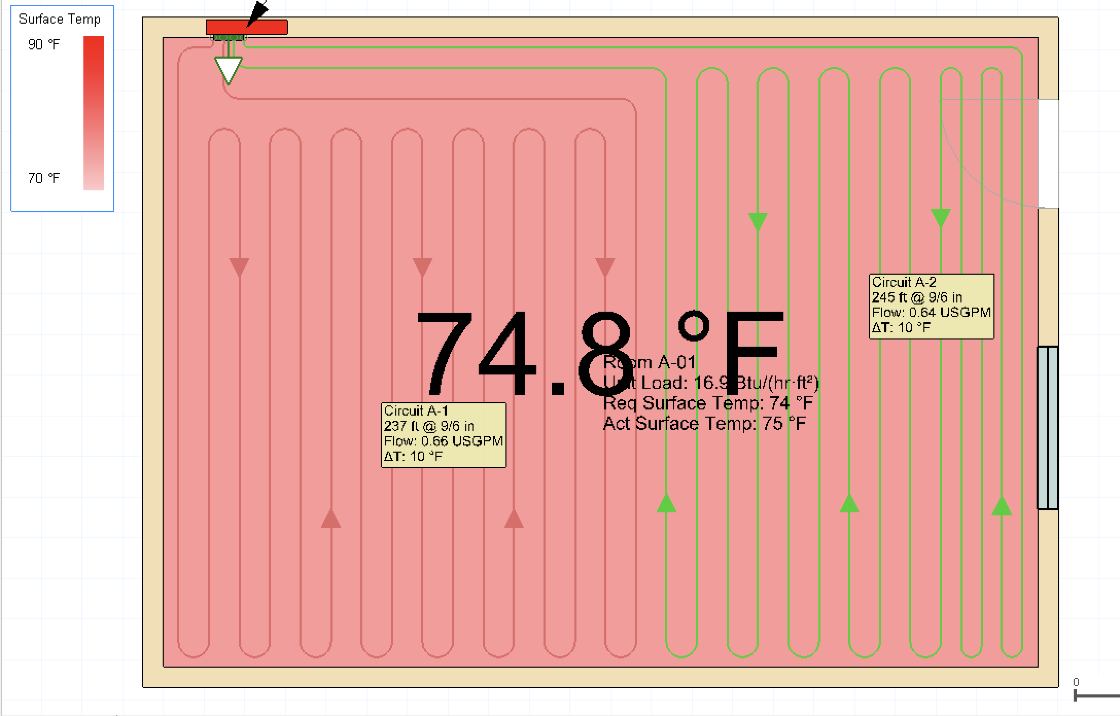

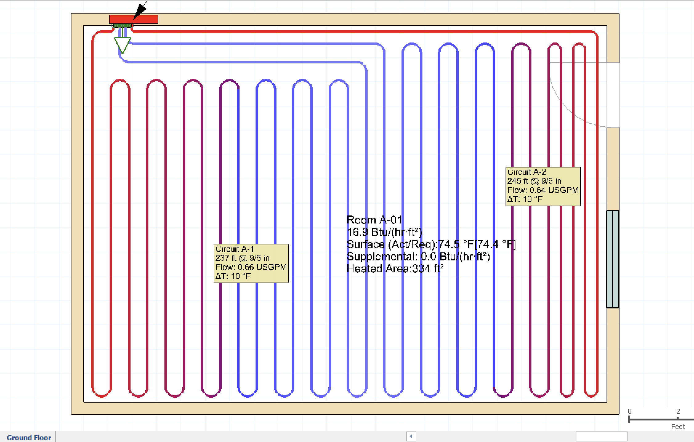

Hi there, I'm starting a new woodshop build in May. This will be a pretty small structure - 16x22, with a standing-height storage loft above, contained within the building envelop. This is my first time designing and installing radiant heat.
I'm on a budget, so I have to DIY just about everything. Because I am technically building a two-story barn, I was required to have an engineered slab done for my building permit.
The slab I had designed is a 16x22, 6" thick, with thickened edges (16") and a 6" curb.
It will have 3" of rigid EPS under and around the entire slab, including under the thickened edge footers.
I intend to use "Heat Sheet" R12 under the main slab, as I got a screaming deal on it. I'll buy 3" Durospan 250 for under the thickened edge as it is readily available in my area and meets my engineer's 25psi requirement. Last, I'll use 3" XPS vertically around the slab perimter (again, because I got some for super cheap).
Heat-Sheet is one of those 'radiant-ready' insulation products with raised installation pucks, so the PEX will be at the bottom of the slab.
I downloaded a trial of LOOP-CAD and also did a few different heat loss calculations. I think I've got it figured out, but this is very new to me. LOOP-CAD recommended either 3 loops of 165 feet each, or 2 loops of 240 feet each. I'm using RauPEX 1/2" Pex-A pipe. Is there an advantage one way over the other? My intention was to install at 8" spacing. I'm assuming three loops means a faster response time perhaps, and more even heat. But does that really matter in a 6" slab with pex at the bottom? Seems it will be very slow and even no matter what. The two loop option estimates flowing at 0.65GPM. The 3-loop option is 0.45GPM. This assumes a delta-T of 10 degrees F.
The building will be 2x6 walls with Rockwool, plus 2" of exterior rigid foam (R32 total). The second floor is a stick-framed gambrel roof with a cathedral ceiling, with insulation around R40-45 or so. I wanted more, but I'm under a height restriction and can't make my rafters any larger. I'll have three small triple pane windows and an insulated commercial man-door. I've built my own carriage doors, which have 4" thick rigid foam in them, R20.
Winter gets to -40F at the worst here. That said, typical January temps are more like -13F. I'd like to keep the interior at a steady 50-60F, but be capable of heating it to 70F if I have a few weeks off or something.
The heat source will be an electric boiler. My calculations say I'm somewhere around a 3kw (10,236 BTU) boiler, maybe 4.5kw (15,352 BTU) at most if I'm over-estimating my energy efficiency.

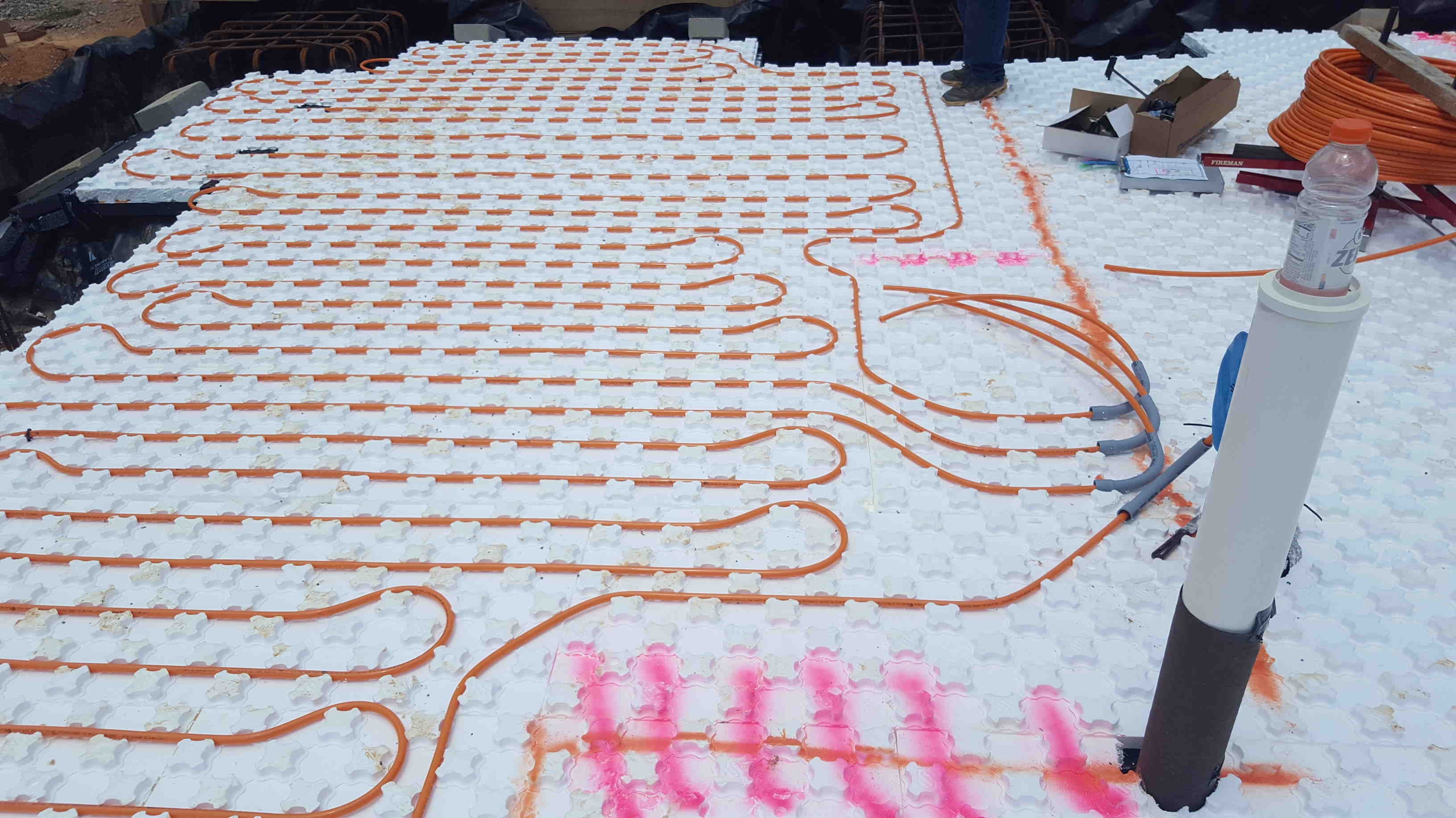

Loop layout ideas are attached here. Any red flags?

  • To get back to your original question of two loops versus three: I would normally default to three to make it easier and lower power draw for the pump (but for your small space and low flow rate it would not actually make a noticeable difference), and in case you have to abandon one in the future (exceedingly rare, but it does happen).
    I suggest keeping the pipe pulled in from all the perimeter by at least a foot, or more if you know the outer edges will be populated with tools, cabinets, etc. If you recalculate the loop lengths that way you will probably find you can tighten the loop spacing to 4" for a portion of each loop, and I would do that toward the center of the room. Note that when you tighten up that spacing you will still flare out to do the end turn-arounds with a broader bend (like a shepherd's crook; see attached photo) unless you are using exceptionally flexible pipe.
    But you have not said why, if your heat will be electric resistance anyway, you do not want to do electric wire or mat radiant. You could still use the Heat Sheet as insulation, but you will need to tie the radiant wire to reinforcement wire, so will not get advantage of its tracks. Or do you hope, as DC Contrarian mentioned, to use some other source in the future?
    As far as quick heating for areas you will stand most often, consider electric radiant suspended ceiling panels, the advantage being you don't have to blow air and dust to distribute the heat.

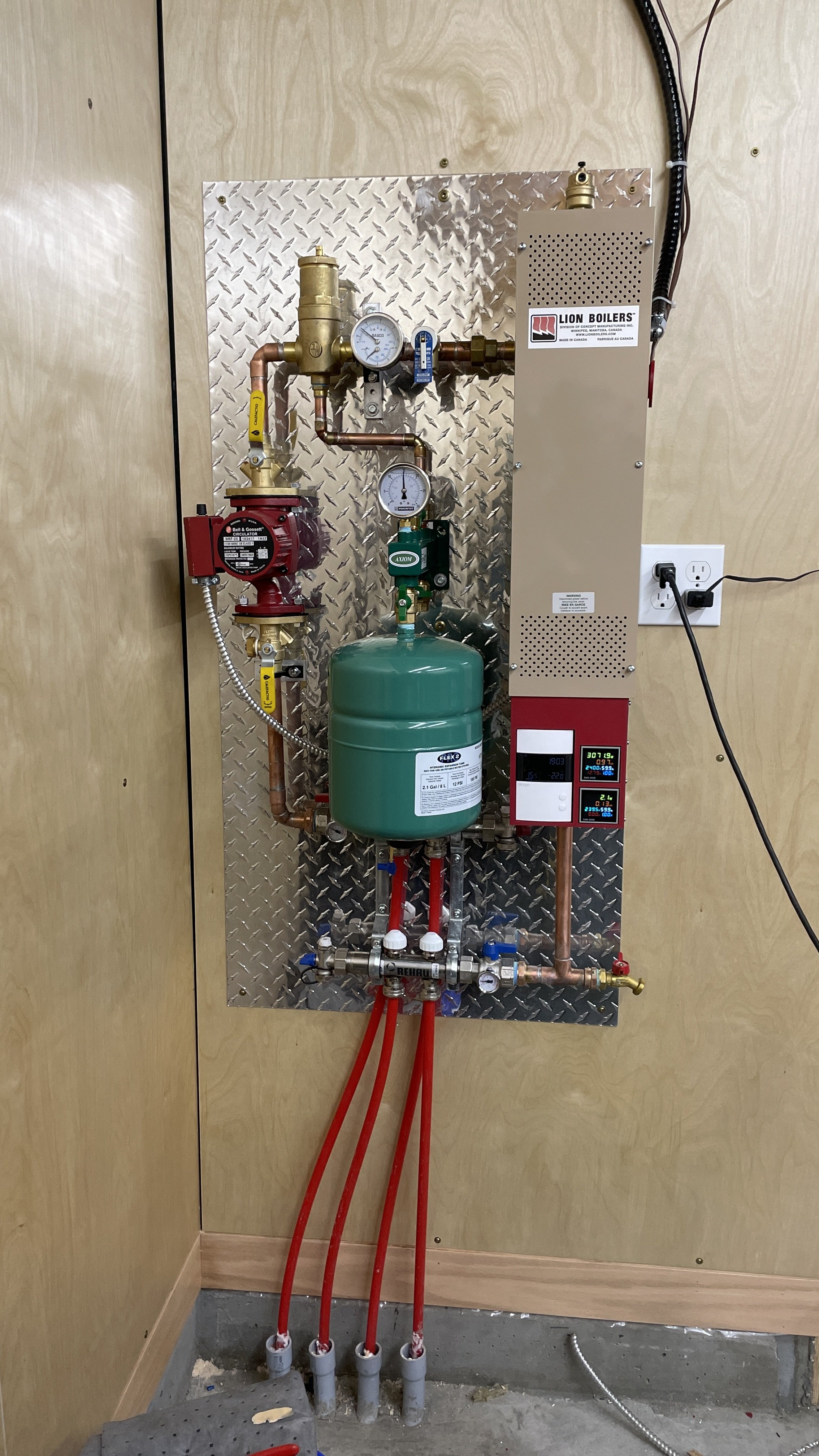

    I got my hydronic floor system up and running in December 2025. I went with a 3Kw electric boiler. I worked with a local plumbing supply house for all the components, then assembled, filled, purged and wired the system myself.
    I used a Lion LEB dc 3Kw boiler, a Bell & Gossett NRF-25 three-speed pump, copper lines, and am controlling it with a Sinope smart thermostat. The thermostat controls a relay to activate the boiler, as it cannot control the boiler directly. I'm running a 50/50 glycol mix (coldest temp this winter so far has been -38C).
    My floor has 500' of 1/2" pex, split into two equal loops. Loop spacing is 9" apart. The concrete is about 6" thick, with a 16" thickened edge. Insulation under and around the slab edges is 3" of EPS. The building is 16x22' with R32 walls, and a second floor with a vaulted ceiling, about R45. There are three triple-pane windows. And shop-built carriage doors, with R20 foam cores.

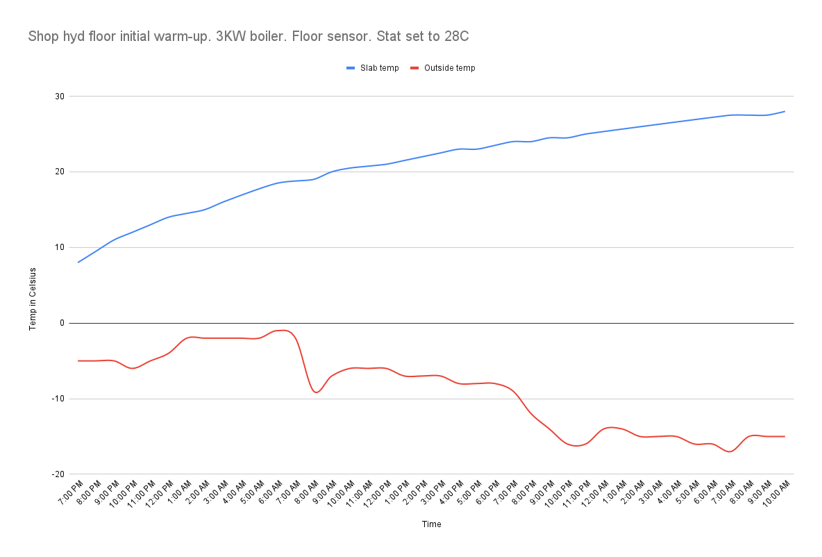

    The initial warm-up took 1.5 days. I admit, I got nervous that I had undersized the boiler, as the temperature increase got slower and slower as the heat rose. The floor temp started at 7.5C. It rose about 1C every 60 minutes up to 18C. Then the rate of temp increase slowed. By 24C, it slowed again. However, with patience, the floor reached 28C / 82F while it was -20C outside. That gave me an inside temp warmer than I'd want for a workshop. It was about 21C when the floor temp hit 28C. But I was happy to know the system was capable of achieving that temperature.
    Shop hyd floor initial warm-up. 3KW boiler. Floor sensor. Stat set to 28C.png
    At that point, my supply temp was 100F, my return temp was 90F. This matched my LOOP CAD predictions. Prior to this, the supply temp was a fair bit lower. The boiler couldn't heat the glycol to 100F when the floor was cold. I'm not sure if that's typical or not, though, as I've never worked with hydronic heating before. The delta was larger as well, closer to 20F. But as the floor warmed, the supply and return temps also rose. And the delta got smaller.

    That is a nice compact piping package.

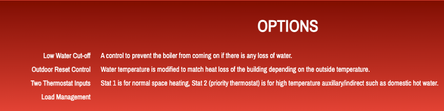

    A few thoughts. You can get an optional reset control so the boiler would modulate its temperature based on outdoor temperature . This saves $$ on operating cost and the slab will stay a nice consistent temperature, never over or undershooting. Maybe you have ODR in that boiler control? It is worth the time and $$ to set up.
    With the boiler above the piping, glycol with no make up, you want a low water cutout. Maybe the boiler has a pressure switch to protect it and the pump if the fluid drops? If not they have an optional one.
    Here are the options listed at Lion Boilwers site.

  • Those options are for their larger CEB line of boilers. I tried to figure out how to include an outdoor reset control when I was installing this, but couldn't figure out if it was possible. I should reach out to the manufacturer (they are even Iocal to me) as I fully agree with you - some kind of low water cut-off control would be great given I do not have a make-up supply. Appreciate the tips!
