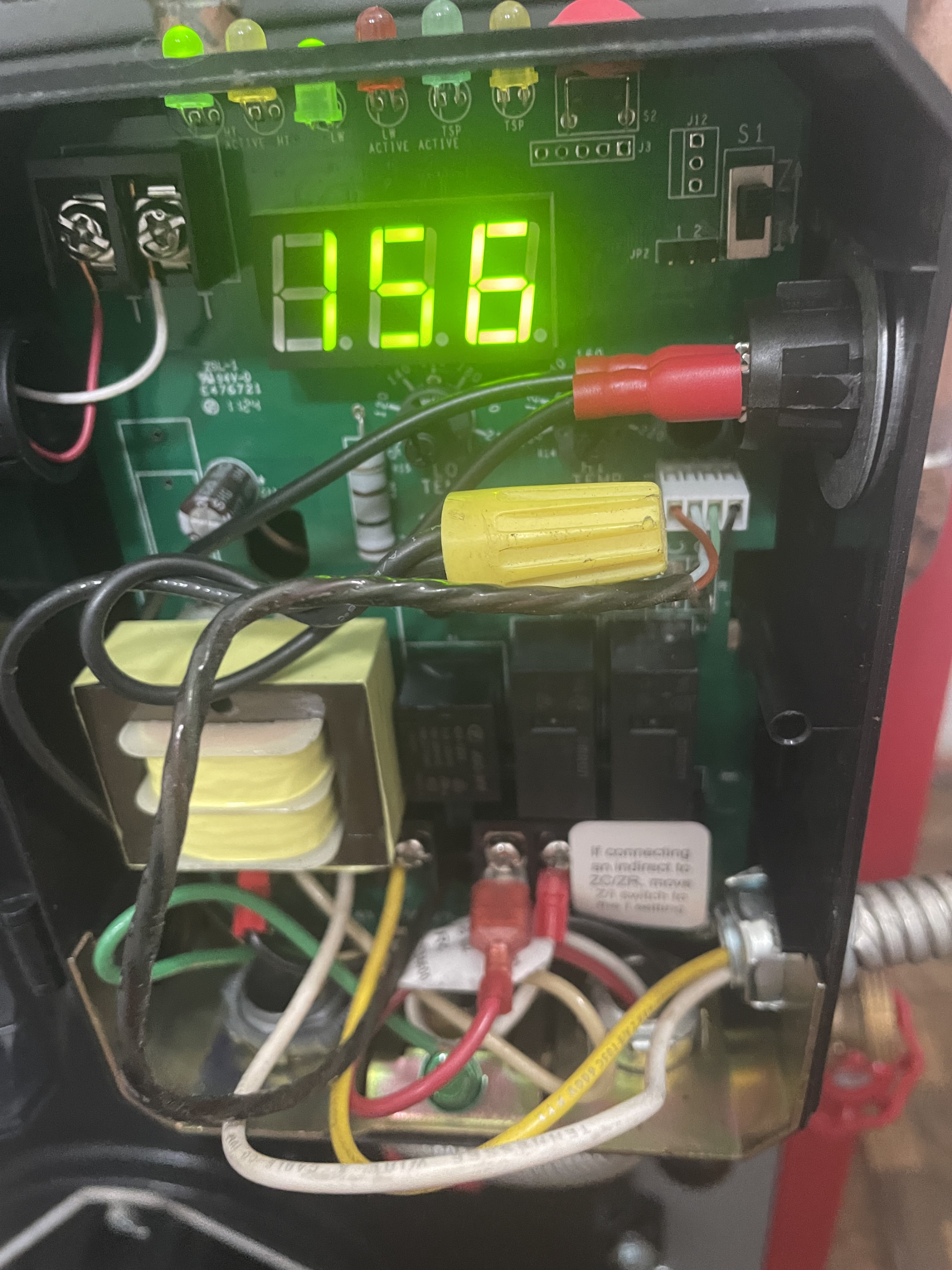

    I can draw you a diagram if you wish. What controls the burner. Open the cover and take a picture of how the wires are connected.

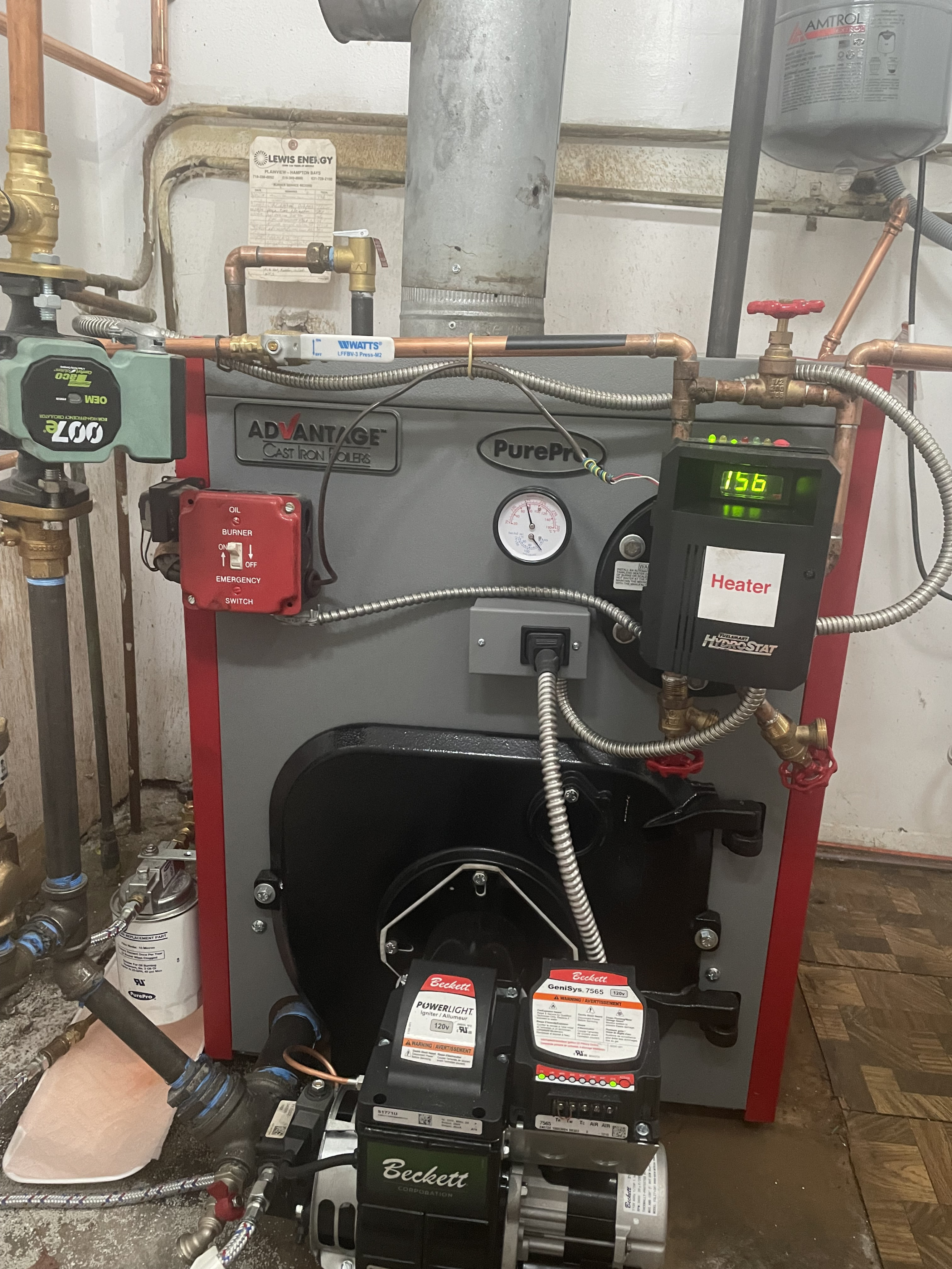

    I hope you have a thermostatic mixing valve on the coil to prevent scalding. Can you show us a picture? Mad Dog
    Mikerandazzo78
  • thank you Ed/Maddog for the quick responses!!!
    Some pics attached…using Hydrostatic 3250
    Right now with low limit set to 150 the shower is decent. Shower Flow is barely 2GPM so I’m okay with the pressure. When the heat is running boiler goes to high and if you’re in the shower then, you get a much hotter shower. We will add cold as needed in the shower as we are used to this game.
    I feel like I’m wasting oil by keeping the boiler so hot (150) for the chance I “might” need hot water. Also in the summer when the boiler is only used for DHW this can get expensive.
    Was looking to drop the LowLimit to 120 and then have a “light switch” turn on to kick the boiler on to its high temp. As for scalding, we are safe with this since we have to deal with it when the heat is also callling

    That said, you do have the ability to make the burner operate with a switch about 10 minutes before you take a shower. Let me look at the stuff you will need and draw you a diagram

    HVACNUT Posts: 7,784
    These are the drawbacks of having a tankless coil. I should know, I have one. An indirect wasn't an option?

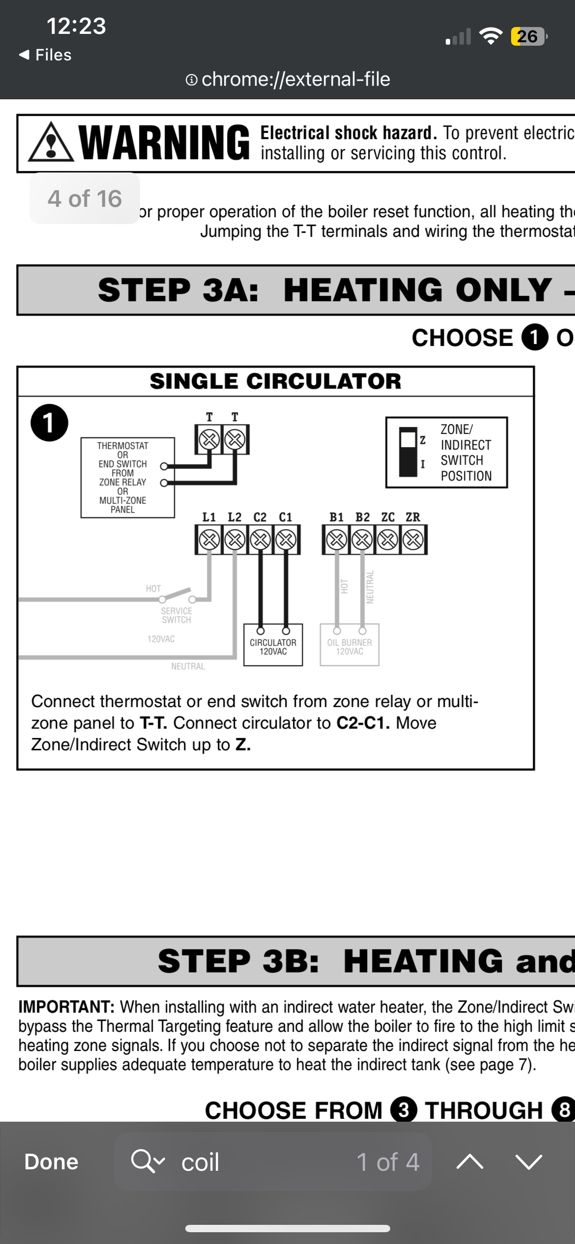

    If nothing is connected to C1,C2 in the Hydrostat, then you can move Z/I to I, and switch ZR,ZC. Switch off, Cold Start, or low setting. Switch on, burner runs to high limit.
    I don't recommend it, but you can do it.

    I am not sure if this will work, but I should.
    1. Set the high limit to 160 or above (If you don't get enough heat on the coldest winter days then set higher)
    2. Set Low limit to lowest temperature or OFF
    3. Add a switch to connect L1 with ZR on the Hydrostat 3250 control
    4. Set the Indirect / zone switch to I
    5. When the switch is turned ON the burner will operate to maintain 160° and the circulator will be turned off for up to 45 minutes. after 45 minutes the DHW priority will time out and the circulator will operate for space heating. This is a feature you want to have in the event you forget to turn off the hot water manual switch.
    This is the simplest, most energy saving way to operate your system using the water heater on manual demand. When the switch is off, your boiler will operate like a cold start boiler. That is the most efficient way to operate a boiler that does not have a tankless coil. In the winter when your boiler is operating on and off as the thermostat calls for heat, you will get warm water from your tankless coil for hand washing and other short uses.

    thanks everyone. I will get a local electrician to make sure this is code and I can always disconnect if it doesn’t work.
    @EdTheHeaterMan any recommendation on a switch? Regular light switch?
    Shower is about 50 feet from hydrostat so was thinking of a light switch near shower.
    Attached under “circulator contacts” are I think the amp values for Zr but I’m not sure.
    Thanks for all the help.
    EdTheHeaterMan Posts: 12,957
    edited February 2025
    I would do a test before getting an electrician involved. Use a regular 15 AMP light switch from home depot and connect it near the boiler. after you are sure that it will work, then you can get an electrician to do a nice job running a concealed wire from the bathroom to the boiler room. Make sure it is located in a place where someone that is not used to it will not just turn it on to see what it does. As far as they will know, nothing will happen and the switch may stay on and your savings will go out the chimney until you find it and turn it back off. Perhaps a red cover and a label that states Hot Water Demand. Perhaps a 30 minute 120 VAC Timer Switch would also be a good idea.
    There may be a 10 minute wait time from switching on before you get hot water, in some cases.

    5 amp is enough. the circuit from 1 to ZC is 120 VAC less than 5 amps.

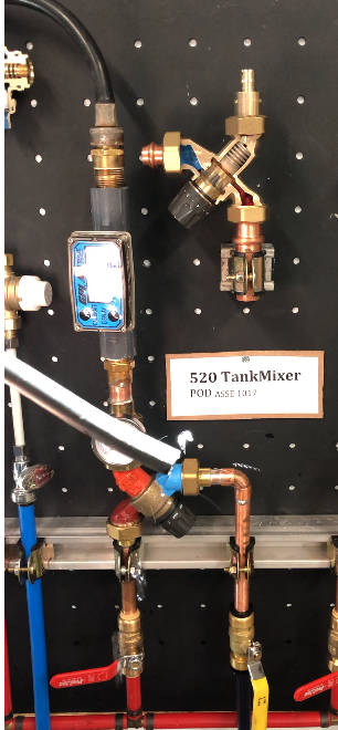

    I don't see a mixing valve on that tankless.

    Also. Before you do this verify if you have a [ true ] mixing valve on your system. A true mixing valve helps prevent you from being burned by scalding hot water. If the new installation was recently done, one should have been installed.
    So I would ask why you are doing this? Is it cost? Is it convenience? There are other ways of getting "enough" hot water with a tankless coil. Im no not so sure you will achieve either in doing this. Just because you can doesn't necessarily mean you should.
    hot_rod Posts: 28,708
    A mix valve like this Caleffi 520 is an excellent choice for tankless water heaters, tankless coils and combi boilers.
    It is fast responding and slows flow to a trickle if you lose the cold side. I'll try to get this demo video posted at one of the media sites and link it here.
