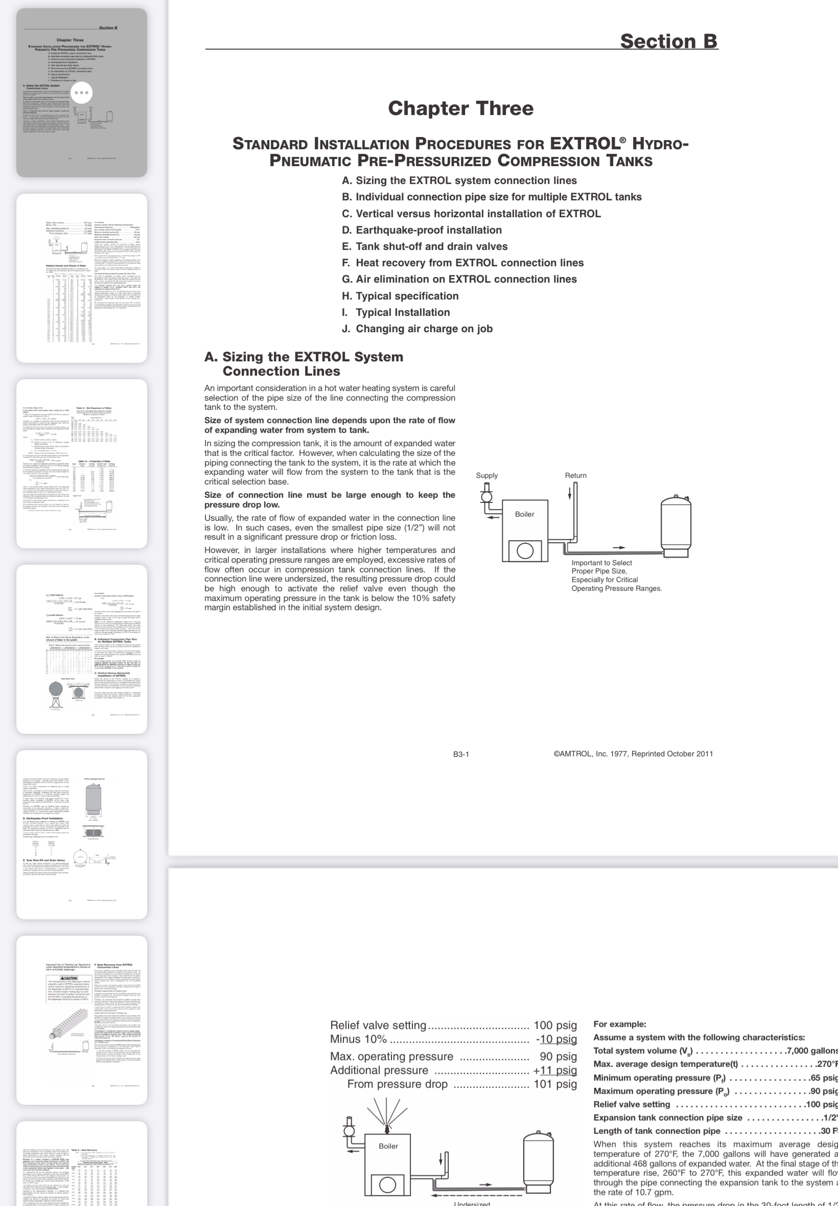

the Amtrol engineering book explains it well. It depends on the amount of expansion you need to accommodate, and the piping distances also. It is a free download that evert hydronics involved person should read
amtrol engineering handbook

@EBEBRATT-Ed said:
"In the Amtrol example they are talking about a system with 100 psi."
You forgot to mention the 7,000 gallons water volume and the 270 degree max average temperature. 😅
