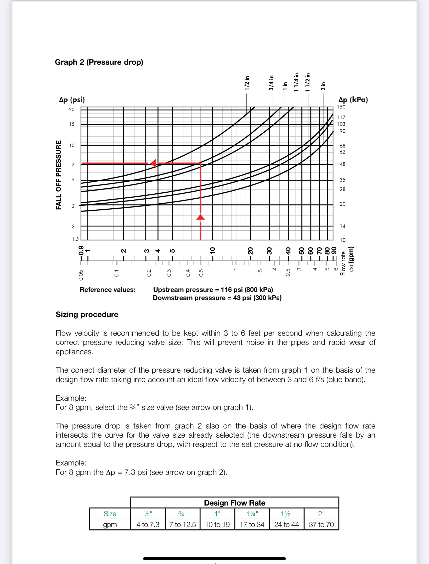

    that is what is know as “fall off pressure”
    In an engineered system you would look for 7-10 psi drop with everything in the system flowing.
    The pressure reducing valve is sized to the maximum building gpm with the 7-10 psi fall off
    There are a number of factors involved in that pressure drop.
    The size, length and condition of the water line into the home, the size of the PRV, any filtration devices. A main valve that is partially closed.
    If you think the psi drop is excessive look for plugged strainers All PRVs have strainers All BFD backflow devices have strainers. Most water meters have strainers Water softeners, water filters will drop pressure.
    Faucets and shower heads have strainers also
    If you have 6 psi drop with just a .50 gpm lav faucet running, that is a bit high
    Run a few faucets and the shower at the same time and check that dynamic pressure.
    The vacuum relief valve protects the tank from collapsing should there be a negative pressure in the system. Another safety device that is in the code but sporadically enforced.

    hot_rod Member Posts: 27,806
    I suppose as the pressure inside the tank changes that much you get some movement causing that noise.
    That is a huge pressure drop, 44 psi!
    The gpm for a wash machine fill, usually 3-5 gpm. As stated earlier a 7- 10 gpm drop with maybe everything in the home flowing, something like 10-12
    I think you have a restriction somewhere in the plumbing
    What type of line from the street to the home? Old galvanized pipe presents this exact condition as they rust closed. A pinched copper or poly line would also
    If you have a pressure reducing valve in an accessible spot, I would run a flow test there. A pressure gauge and a 5 gallon bucked would determine gpm and pressure drop.That would determine if the flow reduction is inside or outside the home. It could be as simple as a plugged screen in the PRV. Attach a pic of the PRV.
    Attached is a sheet for sizing a PRV based on fall off pressure.
    On the bottom line use the gpm at max flow, 8 gpm in this example. Maybe a two bath home with every fixture running.
    On the left axis find 7 psi, where the two lined connect give you the 3/4” PRV size
    in the bottom box we show max flow for various size 535 prvs
    A 3/4 valve max 12 gpm.
    Enter the sizer chart at 12, on the bottom, run up to the 3/4 valve and see the 10 psi fall from. So it shows how the 7-10 psi is the industry accepted range
