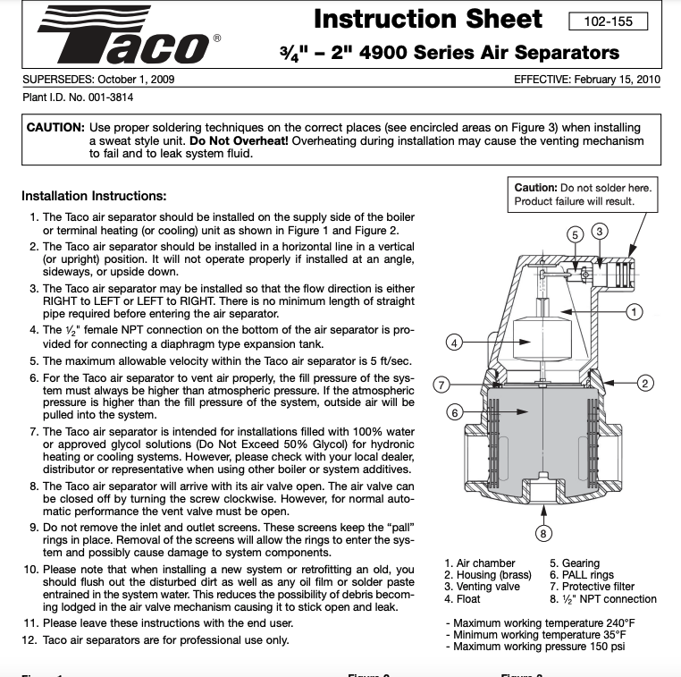

    If you hear air in the pipes the circ must be working. And if that air passes through the air sep it should remove it within an hour or so. Looks like a Taco air sep? Like this?
    Make sure the vent is open. And yes they can plug up from time to time.

  • Yes, that is the one and I verified the vent is open. So maybe I need to look into getting that replaced. Based on its location, I can't open it up and look into it.

  • Your air separator is working just fine. The extreme low pressure that is happening after each heating cycle is drawing air out of suspension at a rate that is unusual in a hydronic closed system. Once you get that check valve out of the system, you will find that the system will work just fine.

    If the air sep is in fact working properly all air, free air, entrained, dissolved, suspended will be driven out. The temperature increase from the boiler does help with that. Within days , o2 at the molecular level will contact ferrous metals and oxidize (rust) it and be consumed in the process. You have “dead” water starved of o2

    There's an air scoop in the block that also has an air eliminator. Air should be non existent if you do what was recommended.
