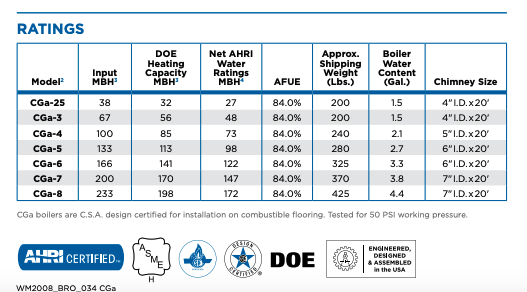

So with assistance from a fellow on this site and a heat loss calculator I am closing in on the size boiler I need. But now I would like to know how much,if any, upsizing of a boiler is needed for indirect dhw.
We are 2 in the house with normal hot water needs. I will throw this into the mix. I have a lead on a brand new Weil-McClain Aquapro 30 gallon tank for $400.
Info that might be helpful
2000sqft house in NE Ohio, double 2x4 walls with R30 ,6000 HDD's,30,000btu/hrs heat loss@0f.
Leaning towards Weil-McClain CGa boiler.
Thanks!
Which boiler are you considering? The smallest may be a bit to small. The next size will be oversized, probably end up short cycling on low load conditions.

If your boiler was using a tankless coil (like the discontinued CGt boiler) I might upsize it to a 4 section boiler. But with your indirect tank, that is not necessary. Your DHW recovery will be a little longer with your CGa-3 boiler. You may be a little undersized with a CGa-2.5 boiler. Same 3 section boiler with a smaller burner. But the CGa-3 will be a good fit for your heat loss. You should be using the NET rating for selecting a boiler based on the heat loss. The Input rating is used to select the proper size gas pipe.

The CGa-25 will heat the space fine. But WM used 234K BTU's for testing on their water heaters, where the -25 is only putting out 32K. Maybe the design experts here can help you get the best recovery with the smallest boiler.
30K is a bit smaller than most tank type water heaters burner, so expect performance similar to a 30 gallon gas water heater.
