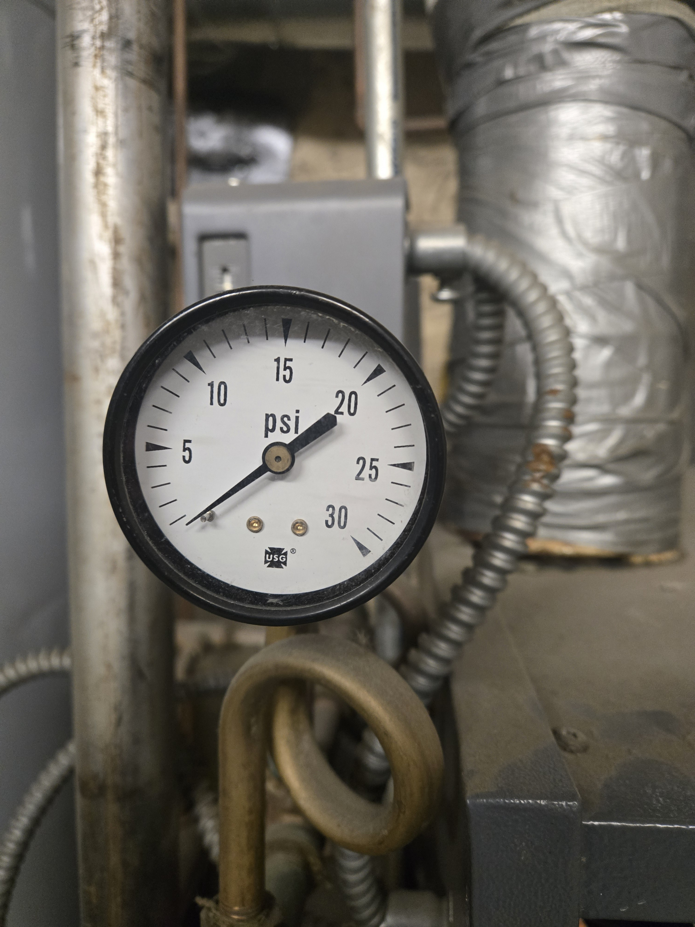

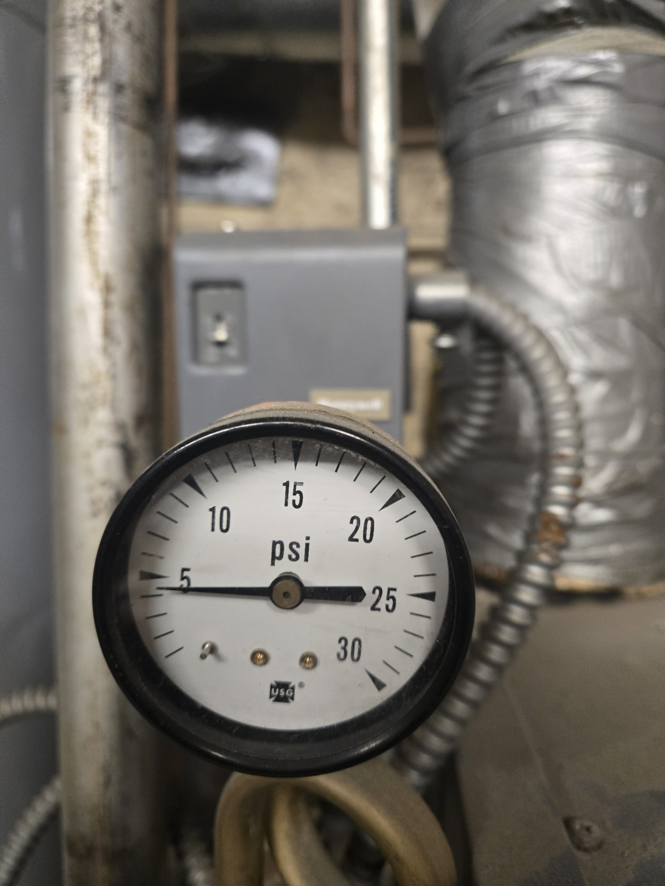

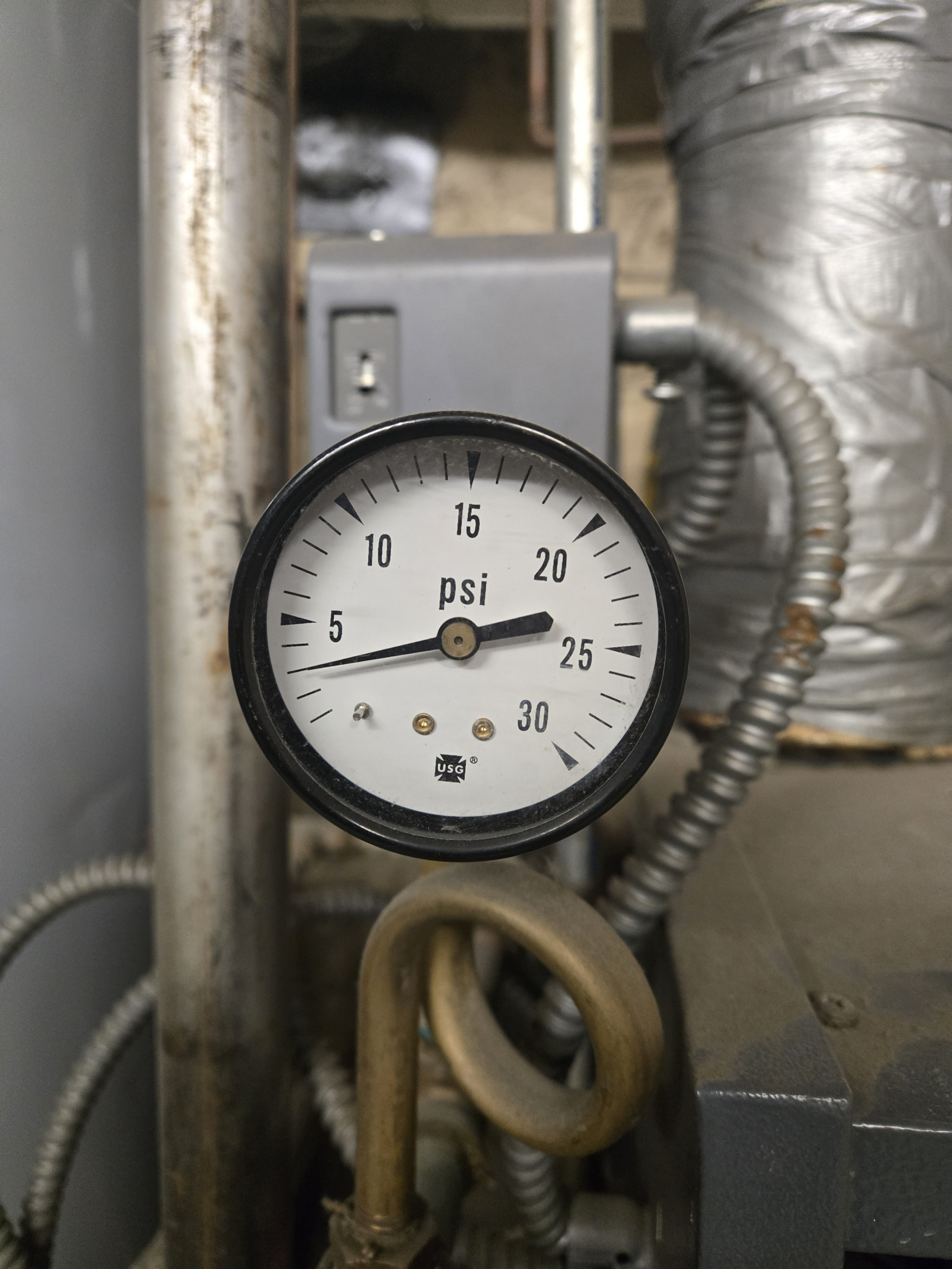

  • The plumber told me the boiler has 3 pressure points where it would shut down if pressure got too high—5, 10, and 15 psi. I just said under 5 because it's never gone beyond that. It's usually between 1-2 (though I have seen go a bit above that once in a blue moon).

    The 0 and 15 may be sort of OK… as they are emergency backups.
    The 5 is two and half to three times as high as is needed. Even the Empire State Building operates on 2 psi.
    Send us a picture of the pressure control devices, and we can advise on how to fix the problem.

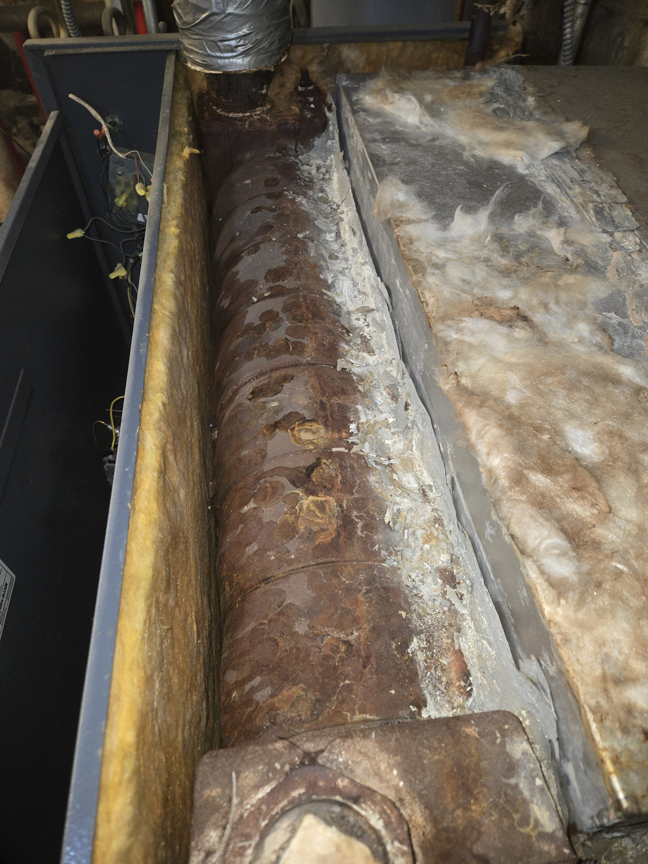

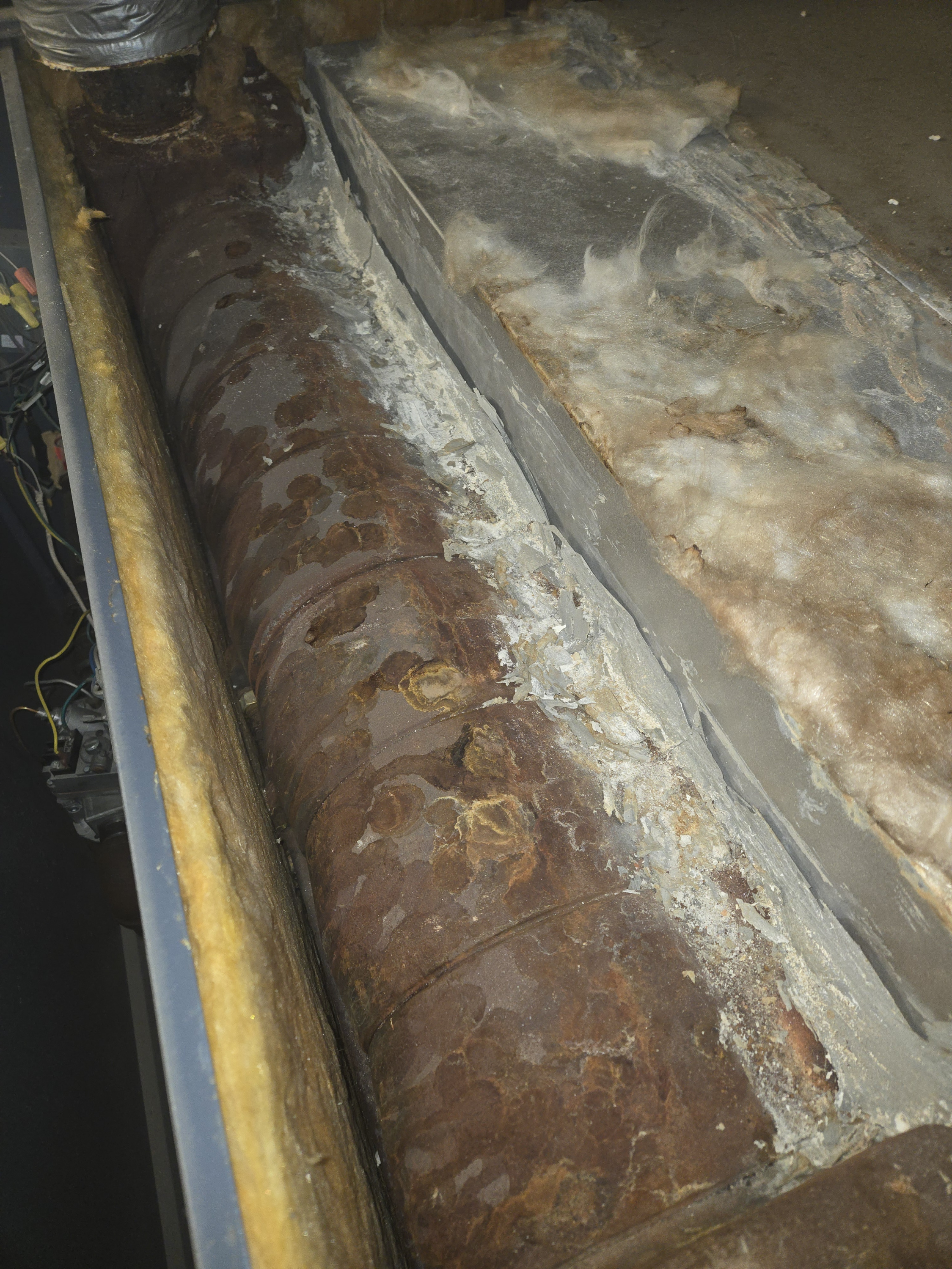

    I shut off and opened up the top of the boiler top yesterday night to see if I could identify anything wrong and see if there was a hole or anything on the sections. I could not visually see anything. If there is a hole, it might be in the back which I haven't gotten to yet. If not, I'm gonna assume it's maybe a minor crack or pinhole.
    I'm thinking of opening the top while it is operating to see if I can see where the steam is escaping from. Obviously I'll be careful regarding the heat. Steam quantity is still low so I'm not expecting a burst of steam to the face. Or maybe I can remove the top and let it run until steam comes out.

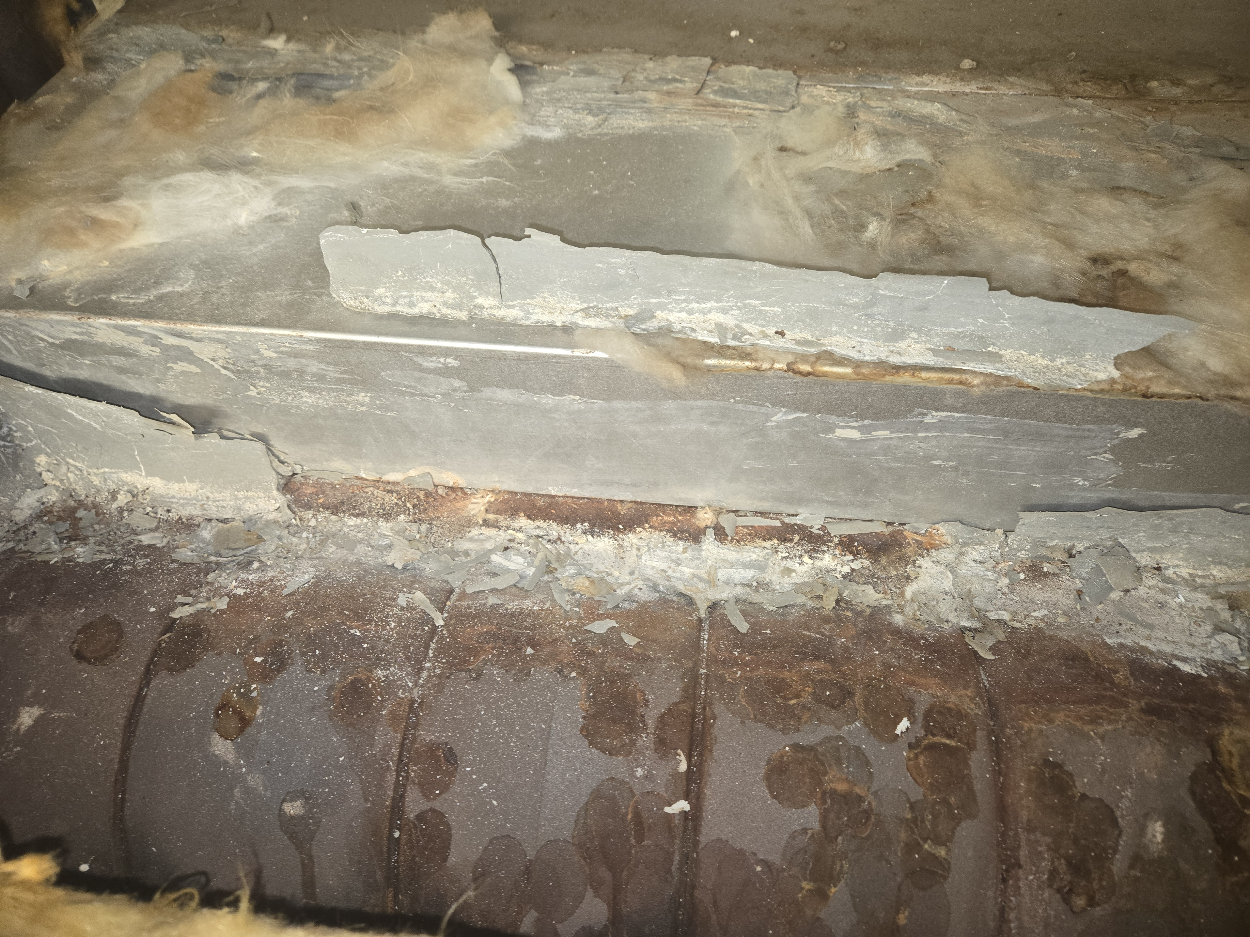

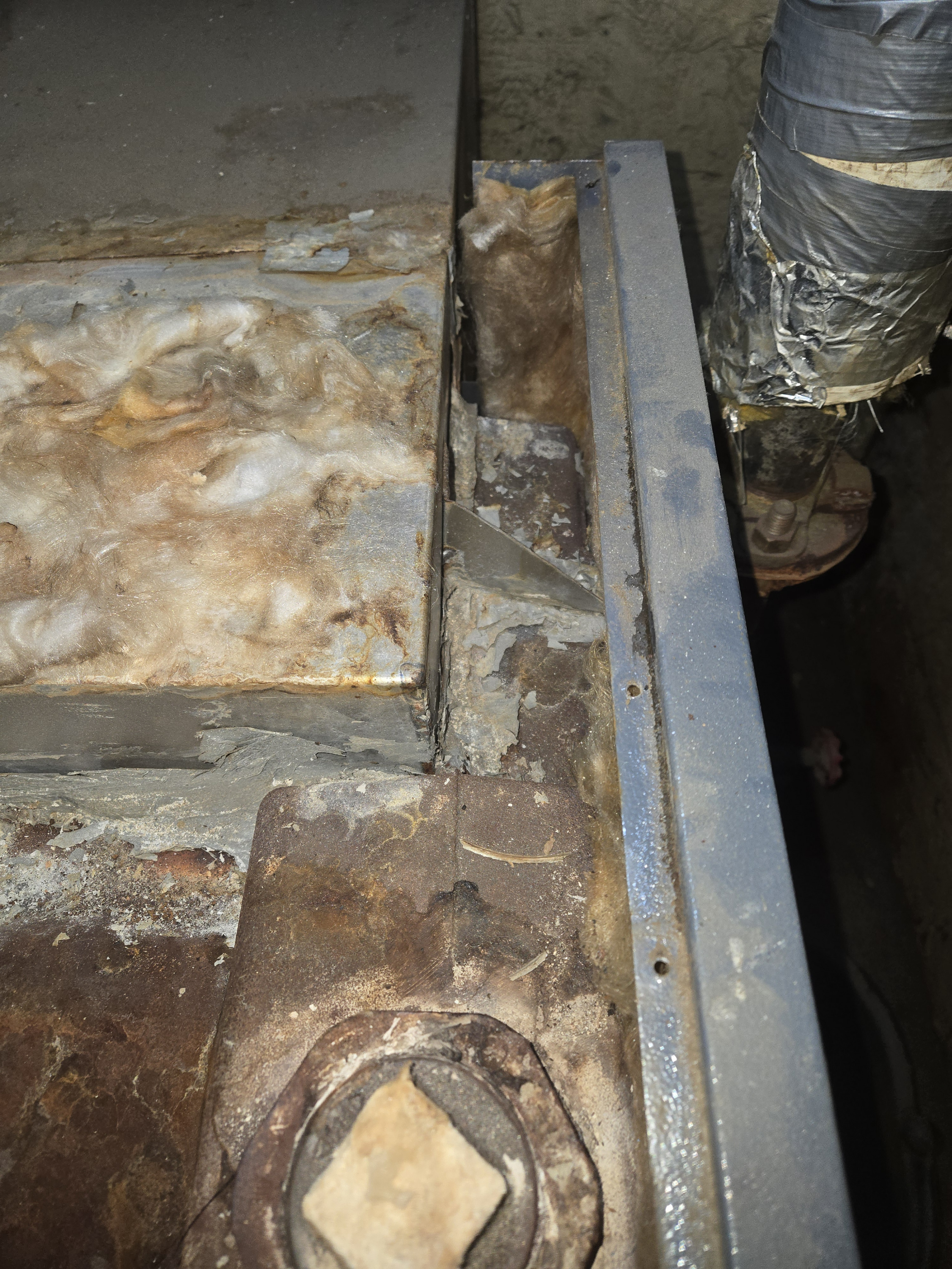

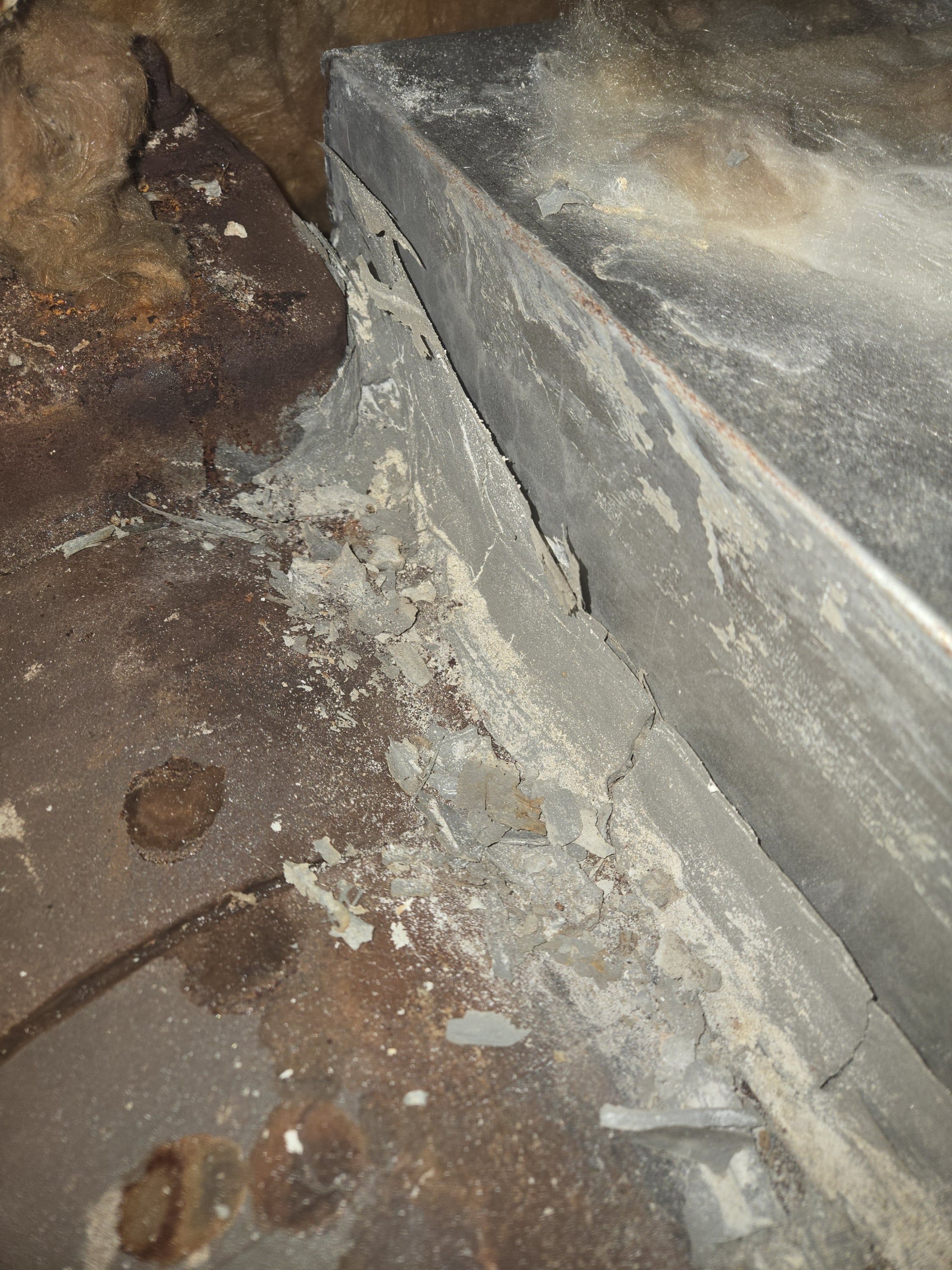

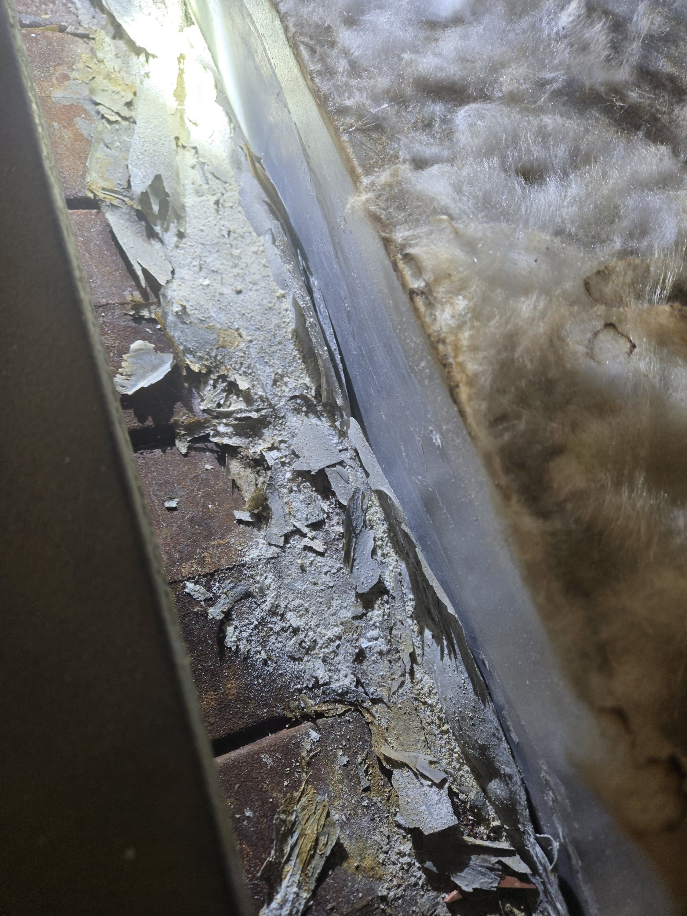

    Also, when I opened it, i noticed there was a silver material that looked like dry paint that had completely crusted away. I've attached a pic. Is this a seal of some sort that needs to get repaired/repainted? Could that be where the heat is escaping from?

    they gray stuff is furnace cement or possibly just mortar sealing the edge of the flue collector box, it seals from flue gases, not water.
    The way to find the leak with the jacket off is to fill the boiler with water and look at where it is leaking. You can only see a small amount of the boiler with the sides of the jacket on and the collector box installed. you could look up around the burners (with the gas off) with a mirror or camera too, once you fill the boiler completely with water.

  • Ok. I'm assuming I should still repair the gray stuff at some point. Possibly a high-temp sealant?

    You can remove all the silver/gray hardened high temperature cement and put a new coat on there. This is what I might use: 10 Oz. black furnace cement tube or Hercules 16 Oz. furnace cement. Both types are available locally at Hardware stores and big box stores. That will seal the flue collector box to the cast iron sections so that exhaust gasses do not leak into your home.

    The pressure is because the boiler makes more steam than the system it is connected to can condense (either because the boiler is oversized or some system problems are causing some of the system to not heat or they are turned off). It has little to do with the leak.

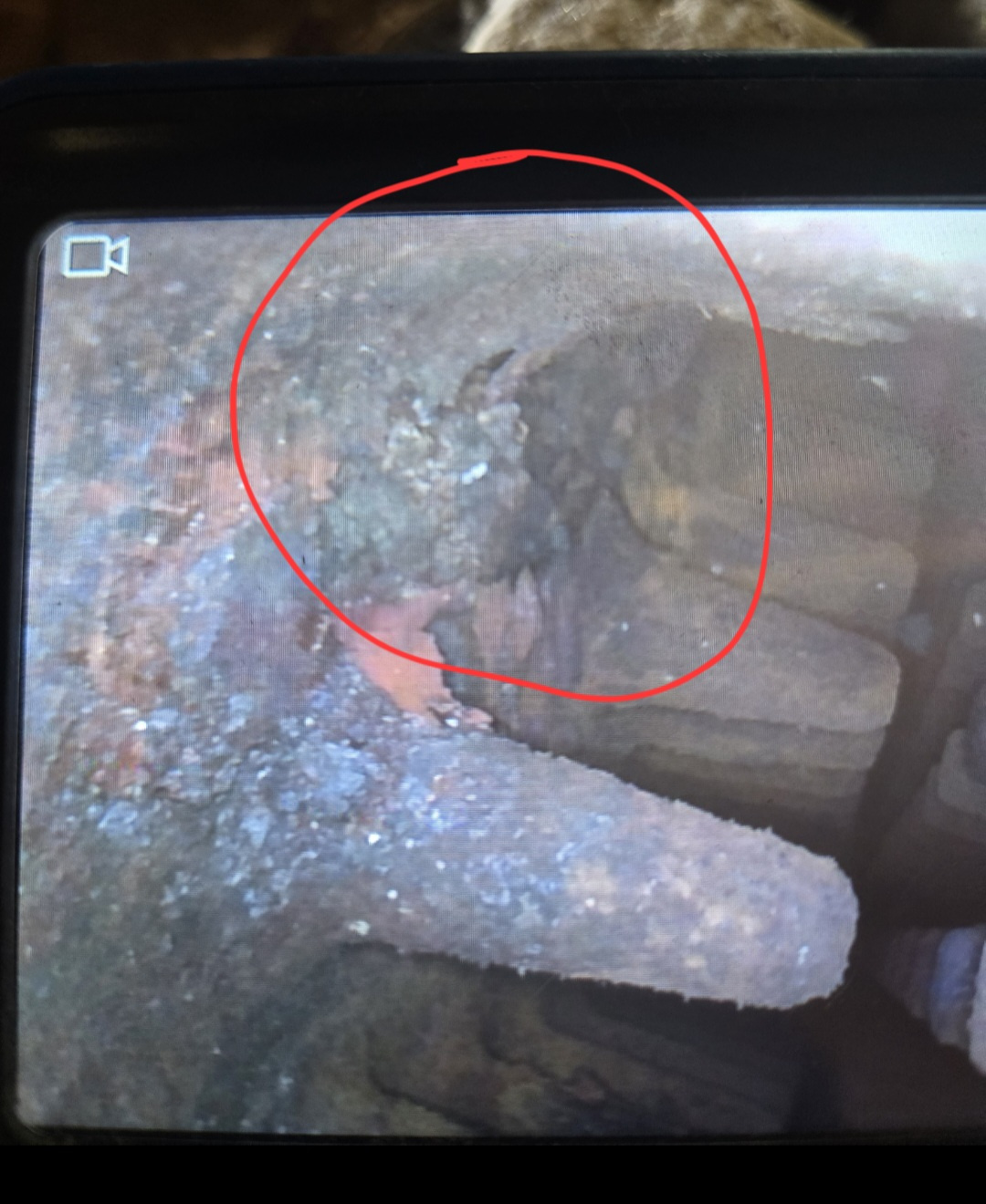

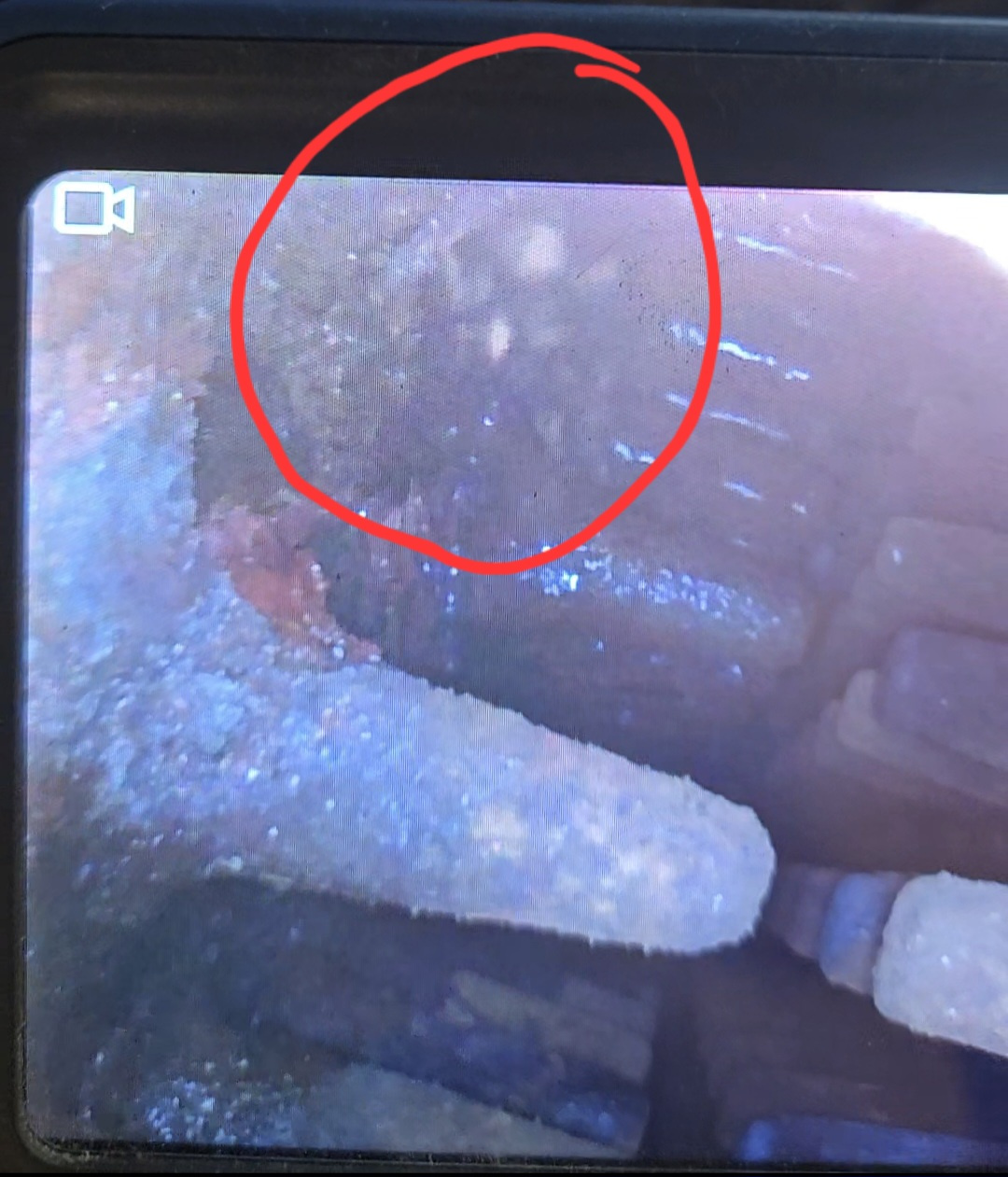

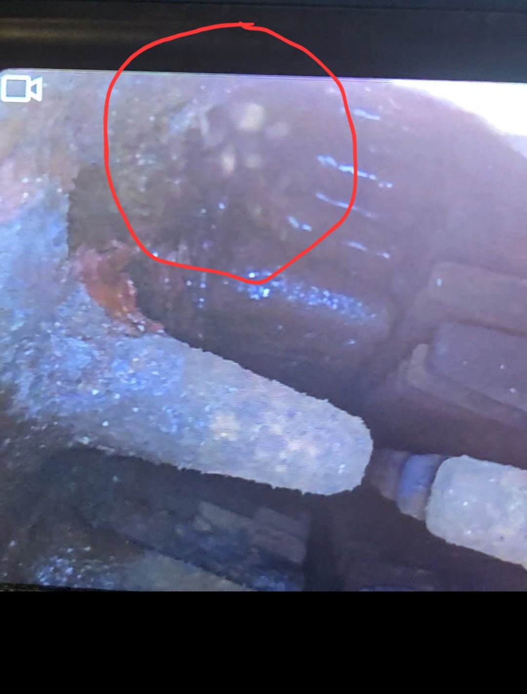

    So, as I said above, last night while the boiler was working, I removed the top and saw where exactly the steam was coming from and peered into the boiler with my endoscopic camera. I saw what looked to be a small hole.
    Then, I filled the boiler to the max water line and, lo and behold, I saw the water pour out. I can't tell if it's small enough for boiler sealant to patch up but I'll give it a try (what do I have to lose at this point?). At least it's below the water line.
