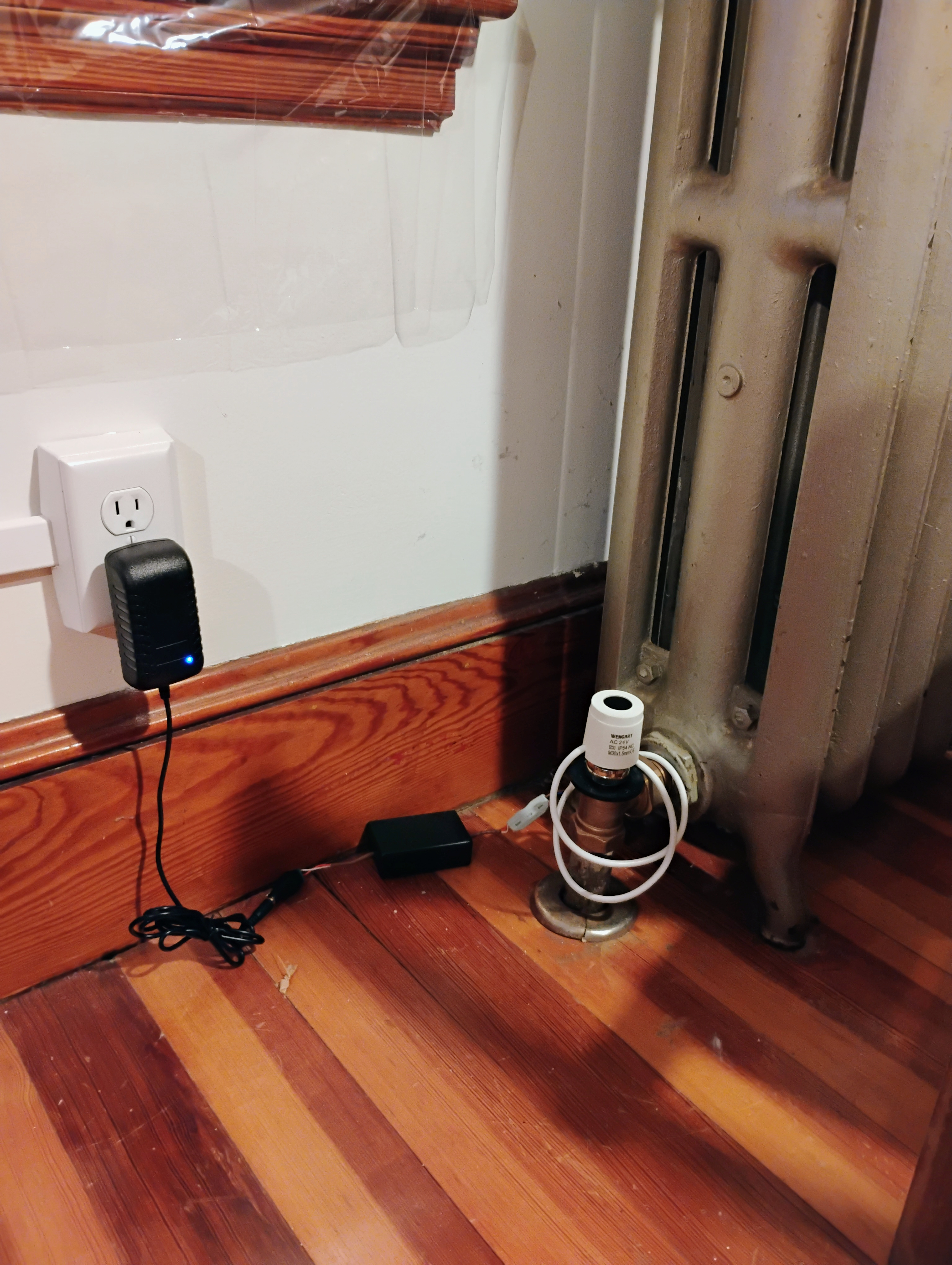

I have a 2-pipe hydronic heating system with cast iron radiators in each of 5 rooms. All rooms were connected to a single zone with the thermostat in the hall. The heat distribution was uneven and could not meet the demands of the individual rooms, some of which were unoccupied for extended periods of time.

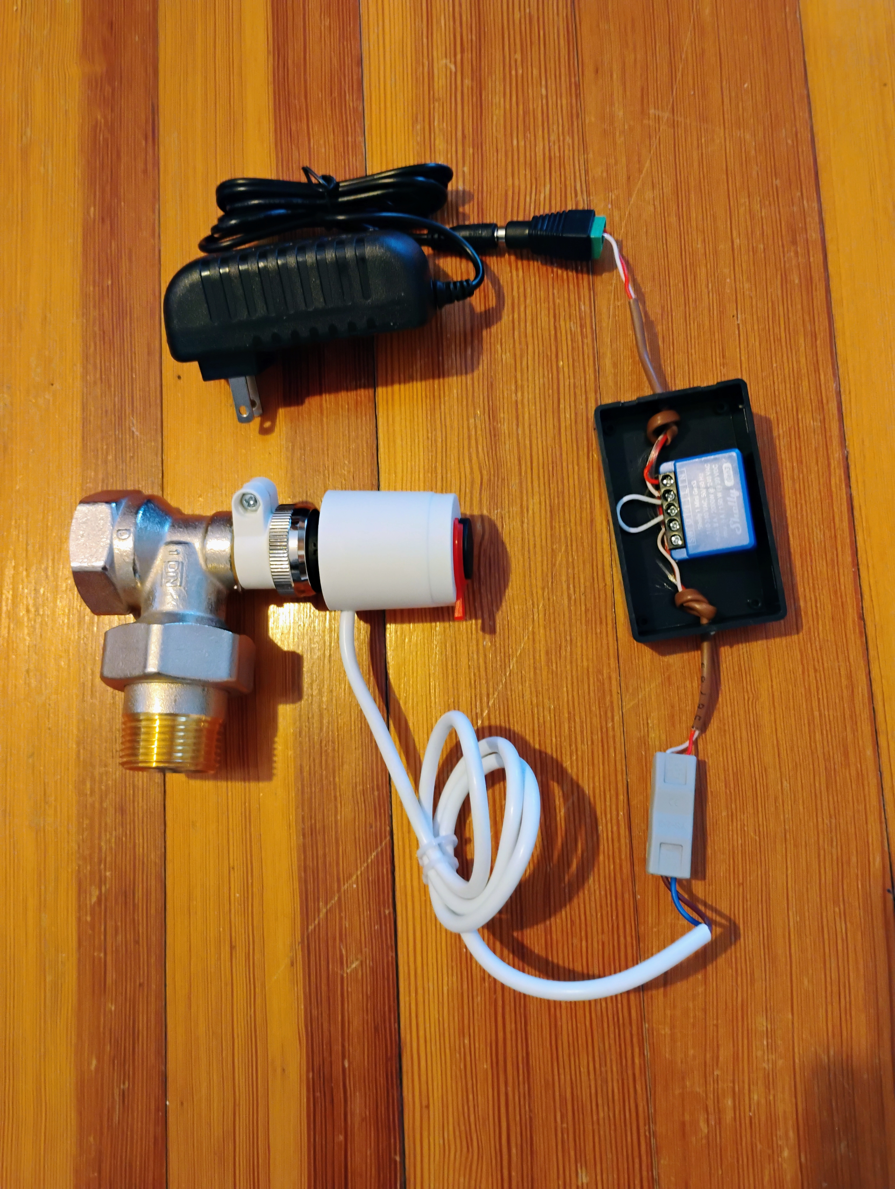

As you can see from the images, I have cast iron radiators with 1” angle valves. I replaced the original frozen valves with Danfoss Thermostatic angle valve bodies, although I did not use their temperature sensors and actuators.
I fitted 24 VDC NC thermal actuators to the valves along with Wi-Fi Relays. These actuators were intended for radiant heating manifolds.

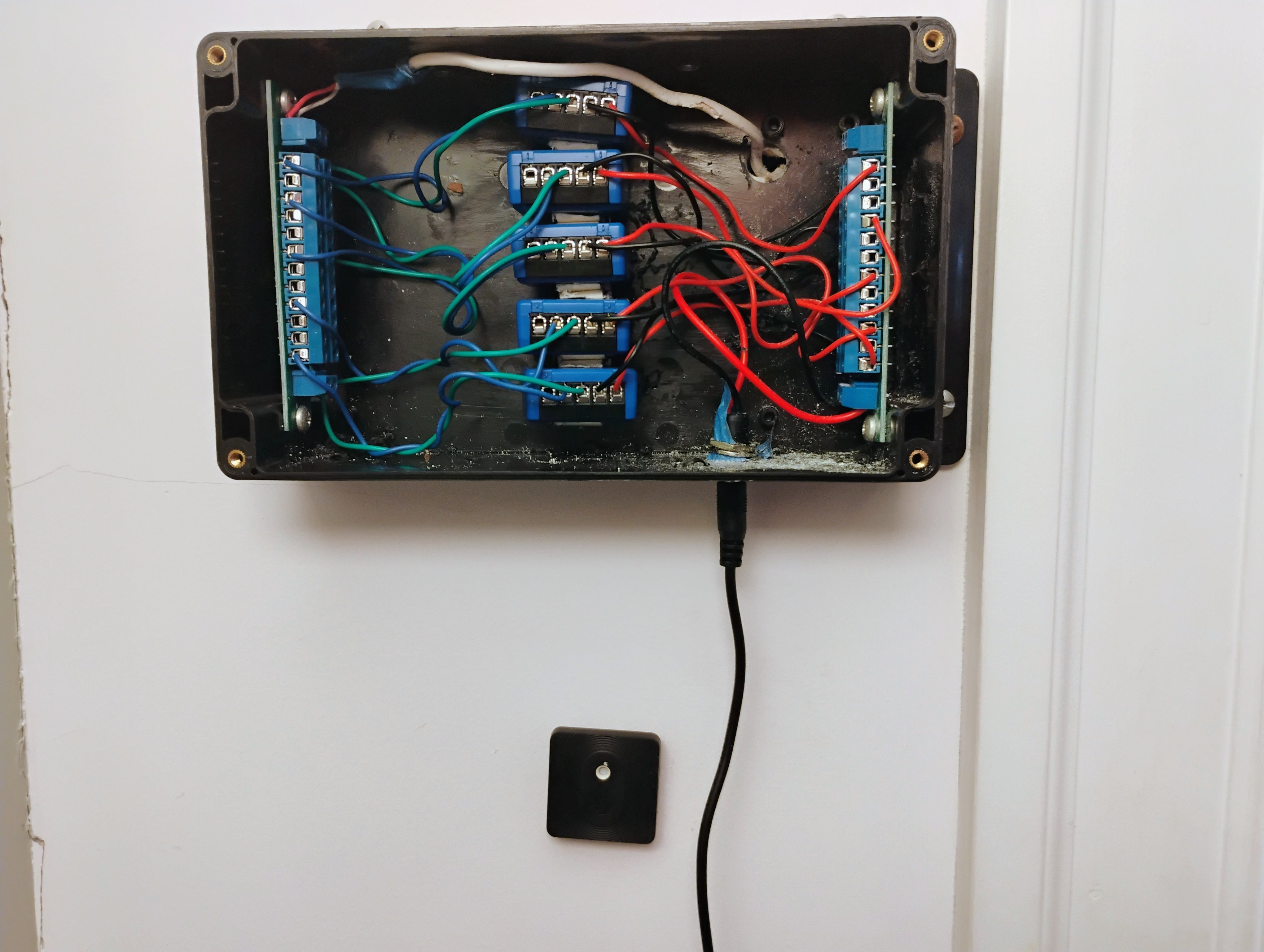

I installed a smart circulation pump that would automatically adjust flow based on the flow demand and assembled a circulation pump relay module (see image) that had one Wi-Fi Relay for each radiator valve. They are all wired to the same circulation pump. So, when all relays were off the pump turned off.
Each room required:
1 Wi-Fi temperature sensor,
1 Angle Valve with 30mm X 1.5 adapter
1 Thermostatic Actuator
1 Wi-Fi relay
1 Power Supply (24 VDC)
The Relay module required:
5 Wi-Fi Relays
1 Power Supply

I am pleased with this project. It’s simple, uses only two types of electronic devices, so my inventory of spare parts is small. I have converted a single zone to a multi-zone system with individual room temperature control at low cost, and perhaps saved fuel by not over heating unoccupied rooms
Concerns:
I wonder if I have introduced short cycling and wonder what period constitutes a short cycle. I invite comments and feedback.
