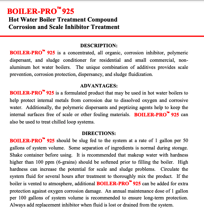

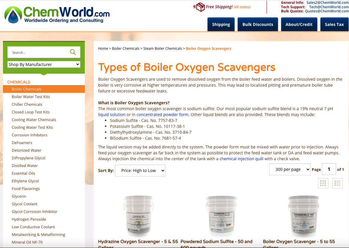

    hot_rod Posts: 28,699
    I know the Rhomar products have a O2 scavenger included in the blend. As In recall sodium sulfite.
    The other important ingrediant ia a film provider. After the system is cleaned the 922 or 925 puts a thin coating on the metals. This helps ptotect them from corrosion. Similar to a rust coating on exposed metal, or anodized aluminum.
    You can buy stand alone O2 scavengers, like the OWF manufacturers provide. It may be less $$ but doesn't include the ph buffer, film provider, etc.

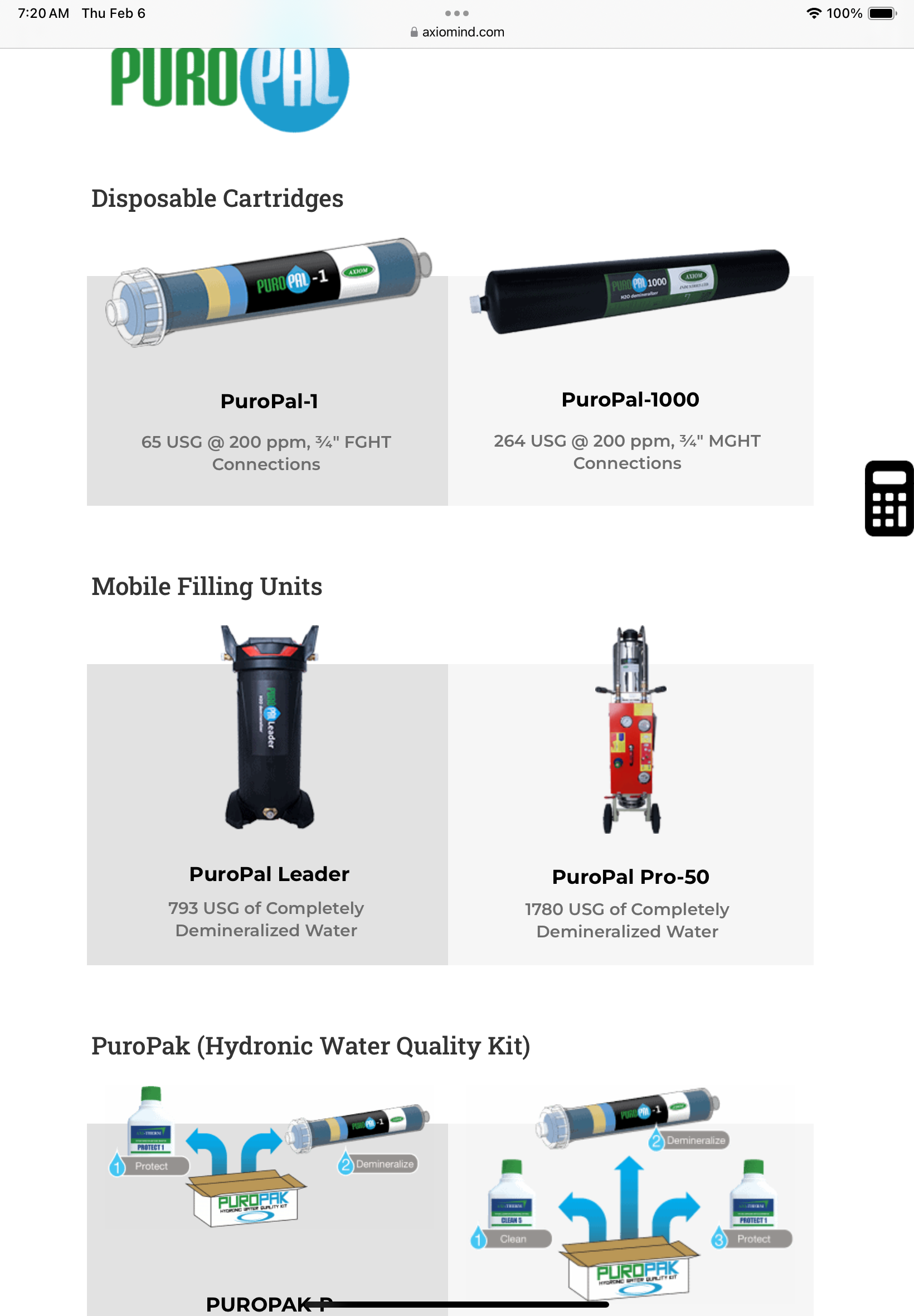

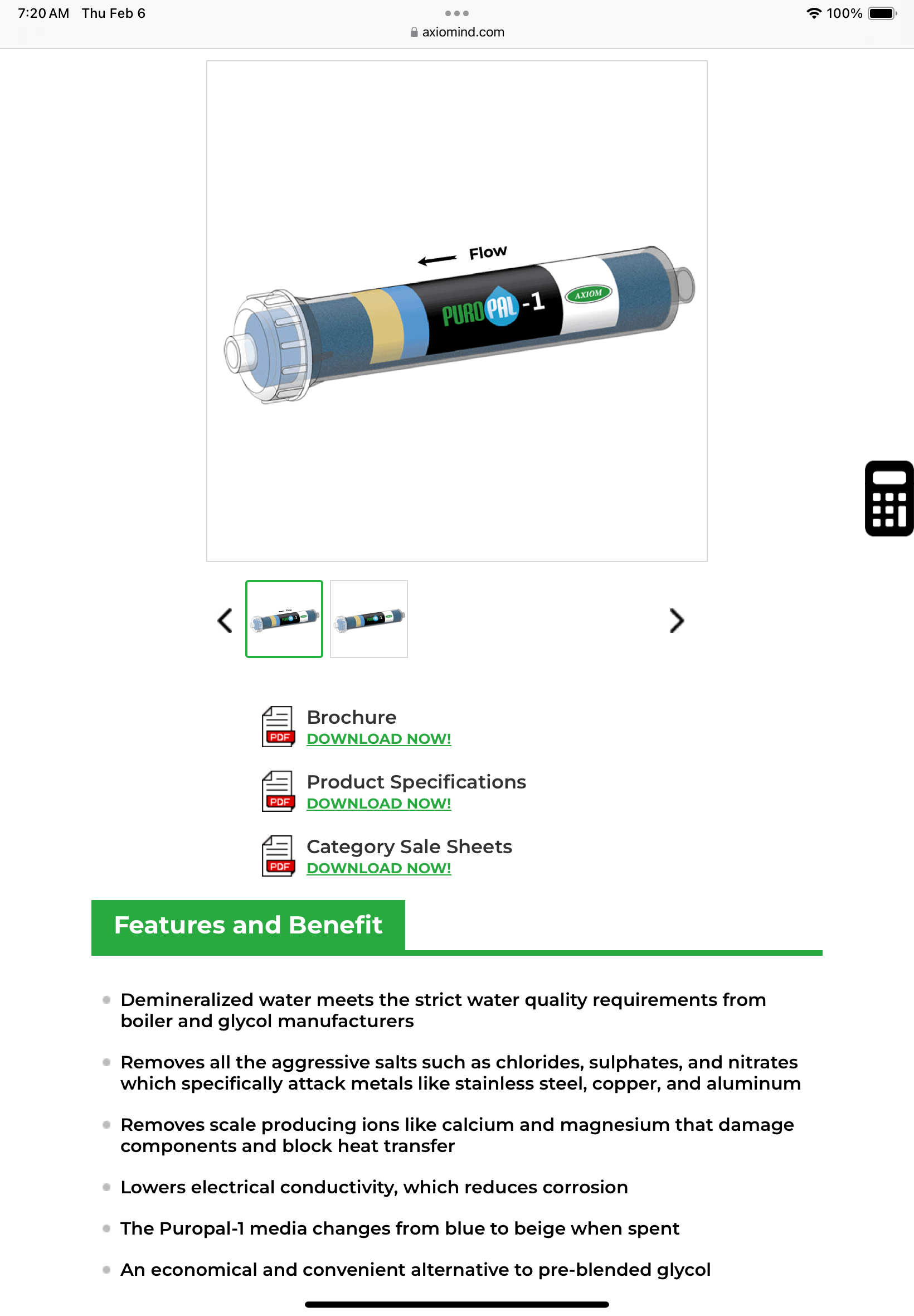

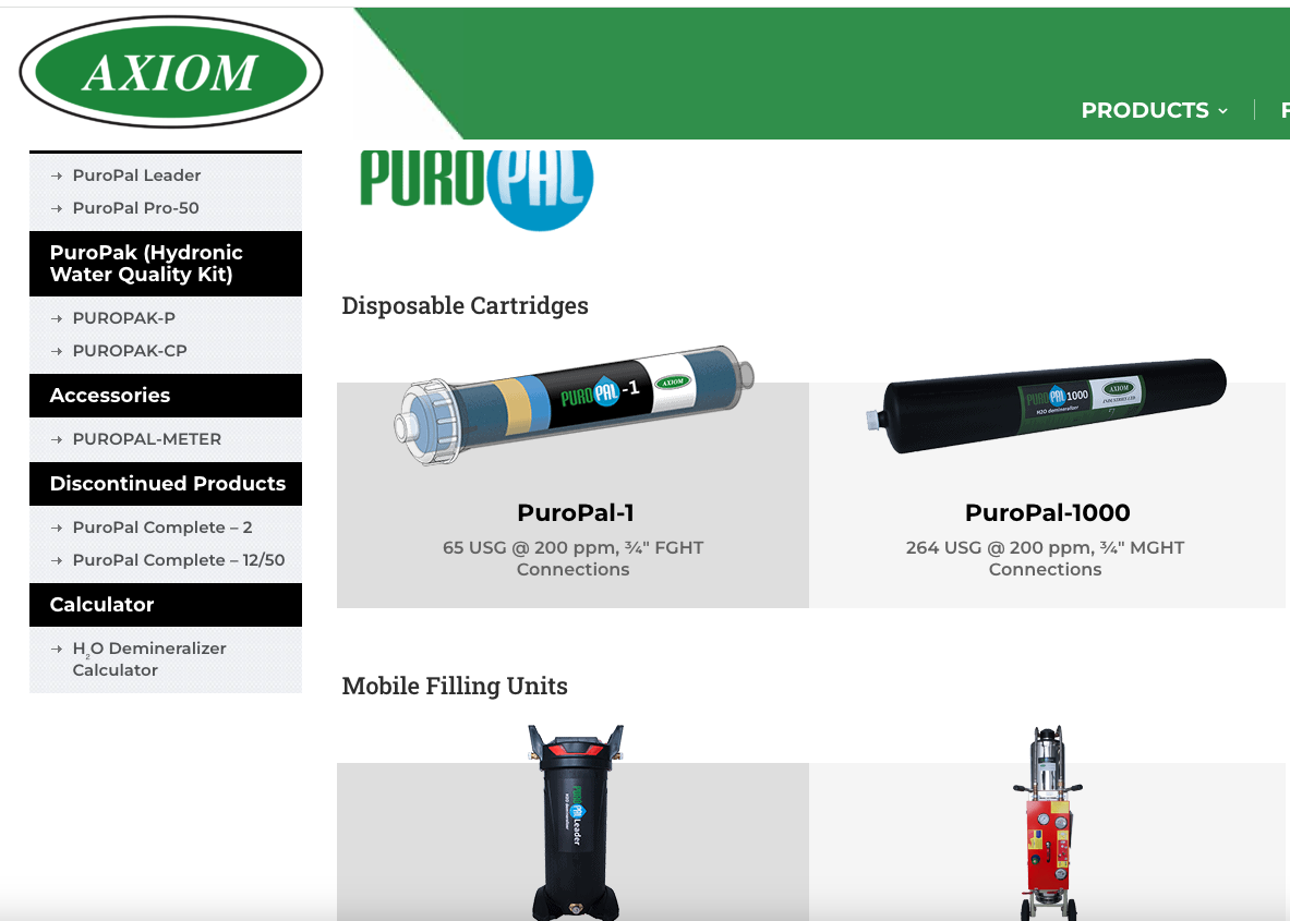

    I think DI cartridges will remove chlorides. I suspect a lot depends on the concentration.
    Purified water is not so expensive to purchase for small residential systems. In 5, 30 or 55 gallon containers.
    I have not used this Axiom product. The kit with the cleaner, conditioner, filter makes sense.
