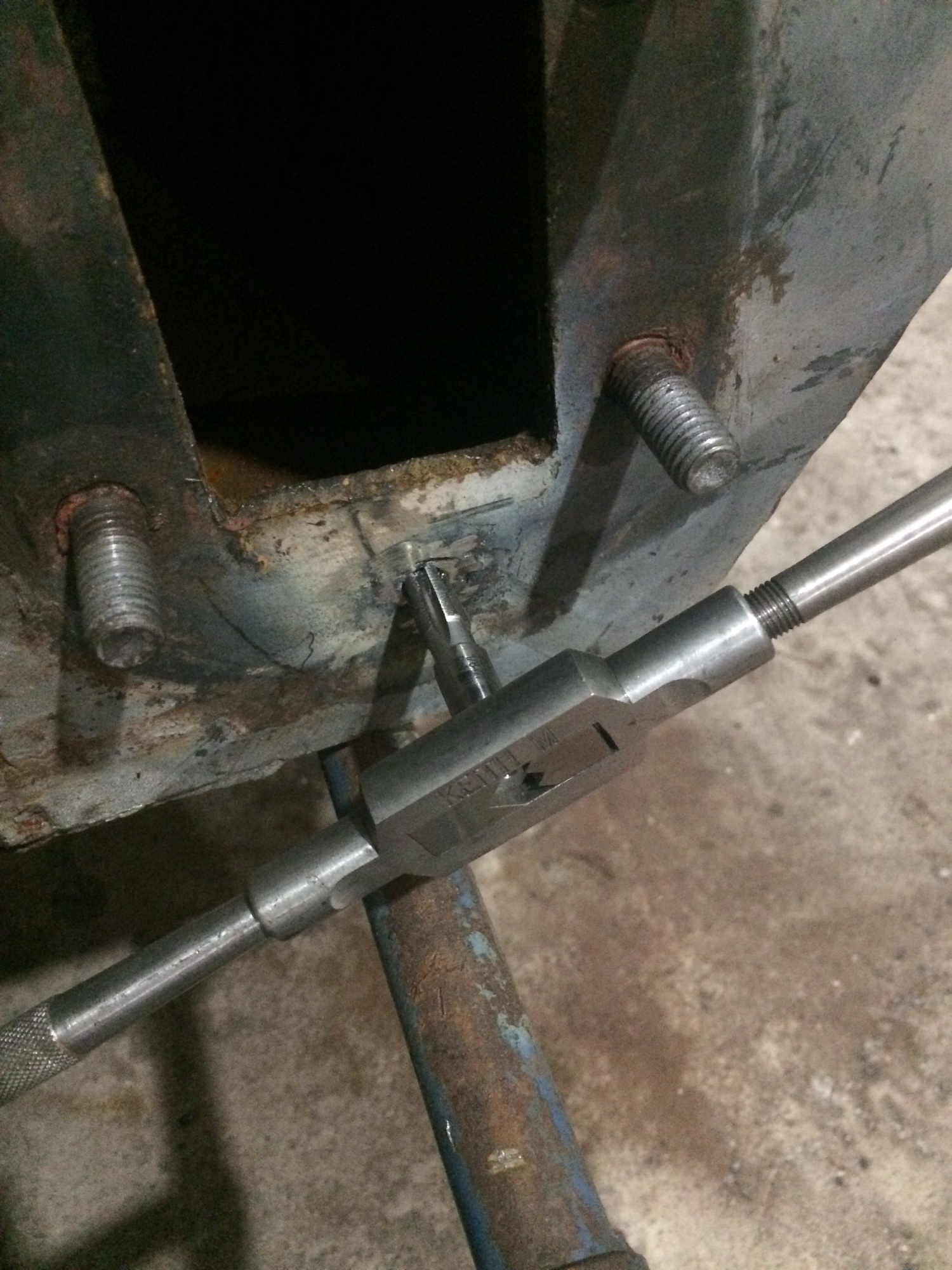

    You can any get a kit. IDK well known brands but I wouldn't go cheapest. What you need are good drill bits. Start small and gradually increase to tap size. Also get a little Zoom Spout oiler or something to keep the bits from burning up.

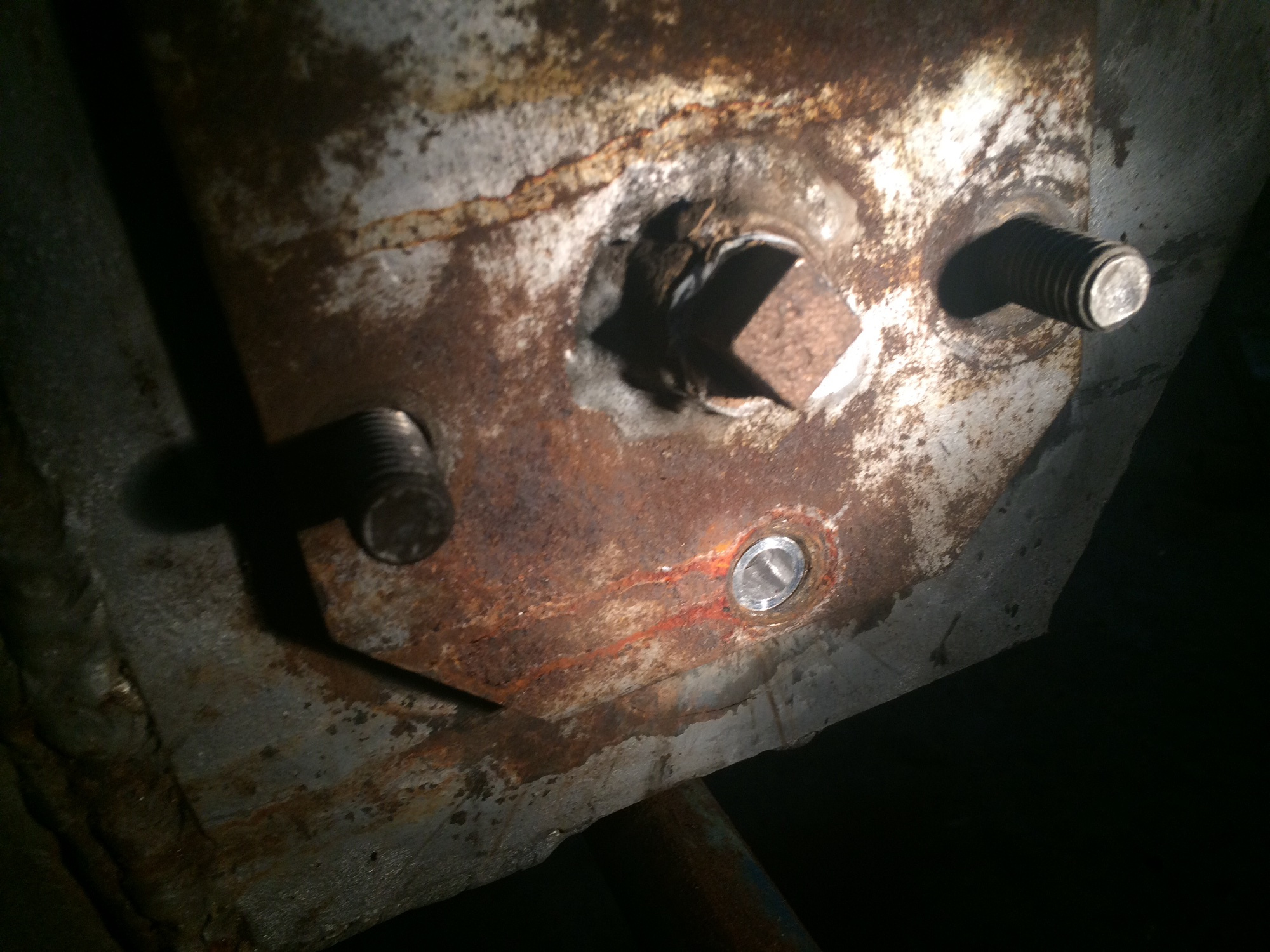

    J Keep in mind the tap differences, a thru tap will push the chips into the hole but will start much easier due to the many gradual teeth leading up to a full profile, where as a blind spiral flute (different than spiral point) will be very difficult to start and will draw the chips back toward you. (out of the hole)
    I bolted down an old coil plate to my broken stud and used a bushing to keep my hole in alignment. It worked very well

    I've replaced dozens of coils, blank coil plates, and plate gaskets over the past 50 years; never needed any taps, dies, or lube.
    I drain the boiler, remove connected piping and wells, and grind the heads off of the bolts.
    After carefully prying the plate off, I heat the remaining studs red hot and let them cool. I reheat the studs again and cool them with ice cubes. The studs have always come out easily & whole with a 6" pipe wrench.
    Perhaps the customers have been lucky I've never had to spend extra time drilling & taping.
    I will note that I don't or won't attempt this type of repair during the heating season, and I've always had drill bits & taps on hand..…
