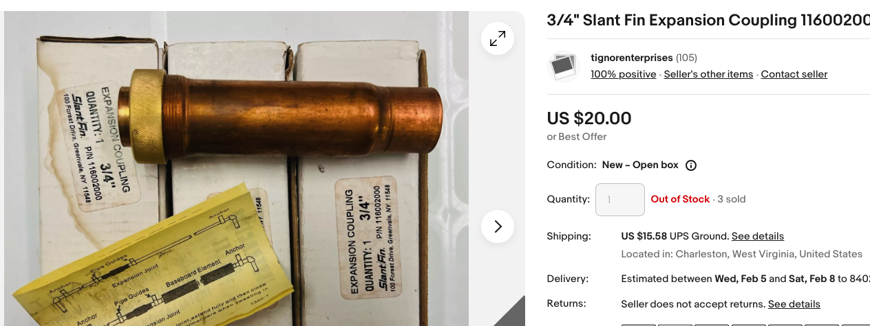

I have an older home with cast iron baseboard. I found a leak on a strange looking fitting. Can I replace this fitting with a normal peice of 3/4 copper? What is the point of this fitting?
A # 75 SlantFin expansion coupling, I'll bet. They come across E bay from time to time.

there are two of these joints both are leaking, both at the beginning of the run. The water comes up from the basement then splits at a tee fitting on the second floor, About two feet from the t fitting are these joints. Each run goes around the perimeter of separate bedrooms then back down to the basement.
How long is the pipe it's on?
Coming off the tee, The pipe is about 3 foot long before it goes into the cast iron baseboard.
so these should not be eliminated with straight pipe but replaced with new expansion fittings?
it depends on the overall length of that section. The piping and baseboard combined.
Without an expansion joint you may get noise, creaking, snap, crackle pop type noises as the metals heat and expand and try to grow in length.
Long copper fin tube sections will arc up off their supports if you don’t accommodate the expansion movement.

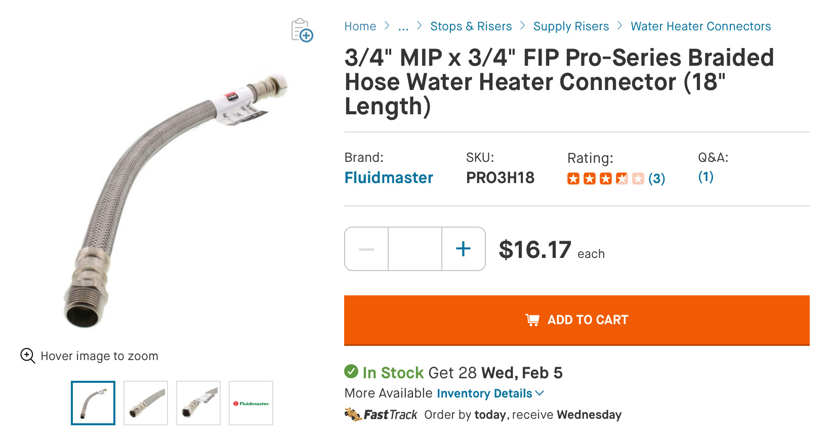

I wonder what the temperature rating is on these water heater connectors? I think it would offer enough flexibility.

Bellows type is still available.
Much better than a slider joint.

With more connectors? What's wrong with a compensator? 2 sweat joints and you're done.

Not heat rated.

around 180F
