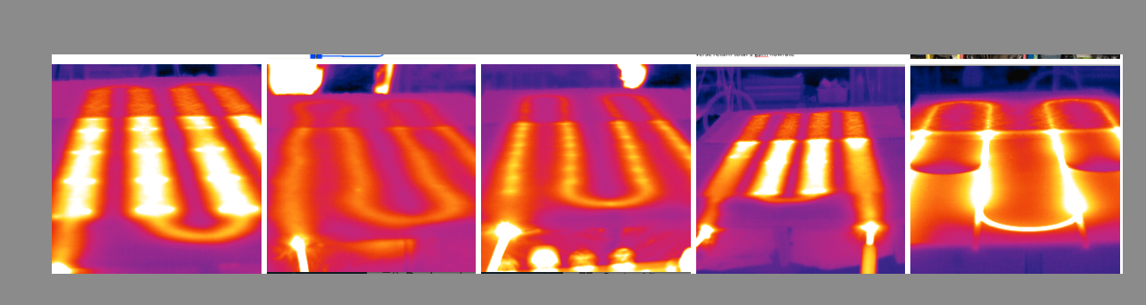

    The tube spacing has a lot to do with it. Here is a look at a piece of Warmboard and the Uponor suspended tube method, basically joist bay warming. The suspended tube, while lower temperature does have a more even spread.
    On the rear 1/2 of these sheets is carpet, no pad. The carpet actually helps spread the temperature profile also.
    Realistic, comfortable residential radiant floors, 24- 26 BTU/ sq ft. Above that supplemental heat needs to be considered.
    Launstein Hardwood in MI did a lot of studies with various species of wood. They built a test chamber and ran a bunch of different woods. I don't know it that is still available at their site.
    Another thing that is not always considered is the heat flux of the room. Furnishings that block the radiation. Couches, cabinets, etc. A couch doesn't necessarily turn into a radiator when placed on a radiant floor heat panel.
    From left to right:
    Pex in extruded plates 8" OC
    Suspended pex, 1" below subfloor
    Rubber staple up (with heat transfer staples:)
    Copper tube in extruded plates. (notice where I pulled the plate down to make a crinp. The donduction is crucial with plates, so they need to be tightly fastened)
    Warmboard

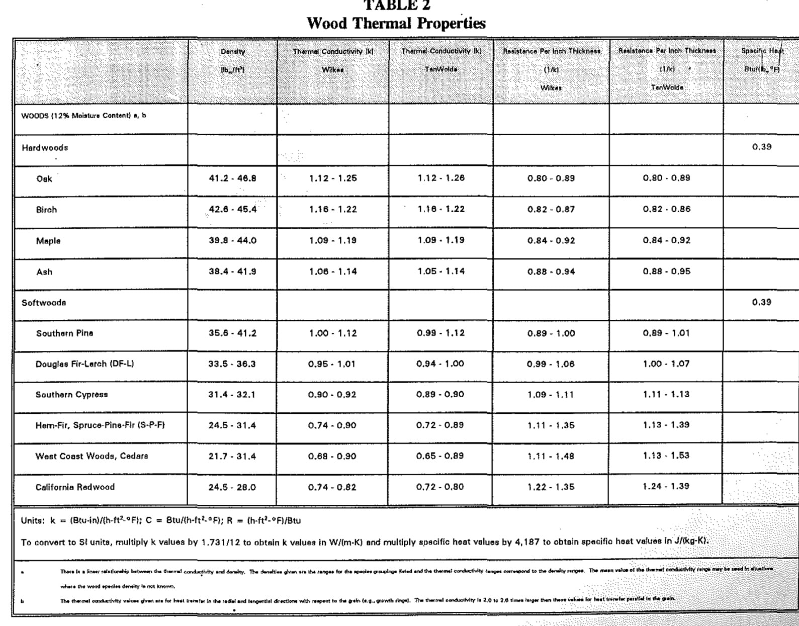

    you can get deep into the woods exploring the different woods for specific heat, thermal conductivity and thermal resistence. ASHRAE has data on that. Here is a chart of various species.
