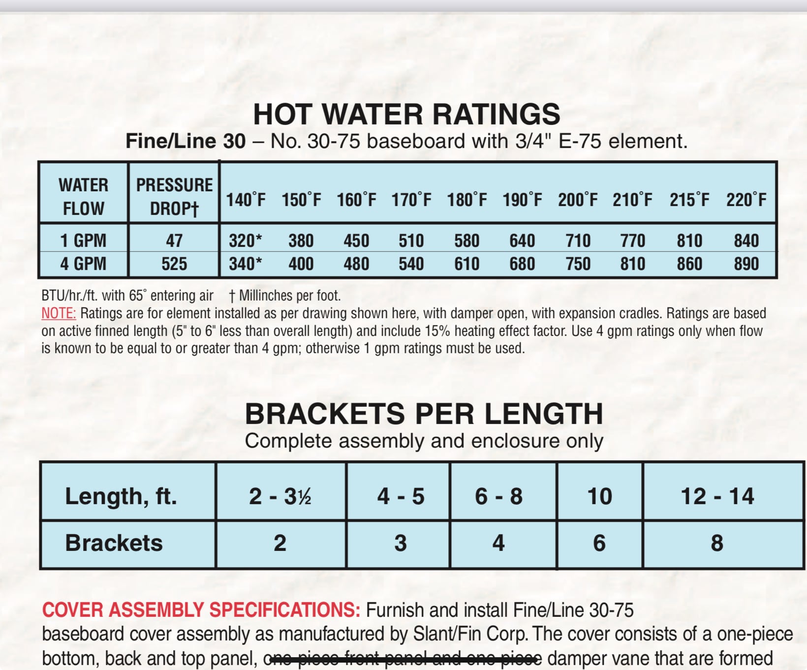

My question is how do I determine the proper flow setting? Slantfin says either 1 or 4 GPM on the BB pdf. So is it exactly 1 GPM or if my 007 can't push 4 GPM, use 1 GPM or do I need to do a calculation to get a number that equates to a proper GPM per zone?

You don't need a calculation. What you do need is to answer the question "am I getting the heat I want out of this zone?". You can start, though, by measuring the difference in temperature between the water going into a zone and the water coming back out. We usually shoot for around a 20 degree difference. Then adjust the flow to try to get there. Too little difference? Try reducing the flow. Too much? Try increasing it. Try to get all the zones more or less the same.
And take your time! If this is baseboard heat, it may take half an hour for a zone to stabilise, so give it that much time.
Once you get things more or less even, then you can start reducing the flow in zones which are getting too warm, or increasing it in ones which are getting too cool. Again, though, take your time. It takes time for things to stabilise.
The flowrate for fin tube baseboard is absolutely not critical. If you look at the slantfin charts, you will see that the output from the baseboard is nearly the same whether you flow 1 GPM or 4 GPM.
However, if you flow 1 GPM, the last baseboard on the loop will not have sufficient output as the temperature will drop more than 20° in the loop. You certainly do not need to flow 4 GPM as this would imply that you could DELIVER 40,000 BTUH from the loop with a 20° DT. That would only be possible if you had 80 feet of element in the loop. Highly unlikely.
As Jamie mentioned, look at the difference in temperature from the beginning of the loop to the end of the loop. Anything between 10° and 20° is perfectly acceptable. Personally, I'd shoot for about 15° to keep the last room from declining too far. By some miracle, the designer MIGHT have installed more baseboard in the last rooms and then the effort to get to 15° is not required.
The flow rates on fin tube are all over the place for most installations as the installer hasn't a clue what will occur. Due to the nature of the beast, this largely becomes irrelevant for MOST baseboard systems.

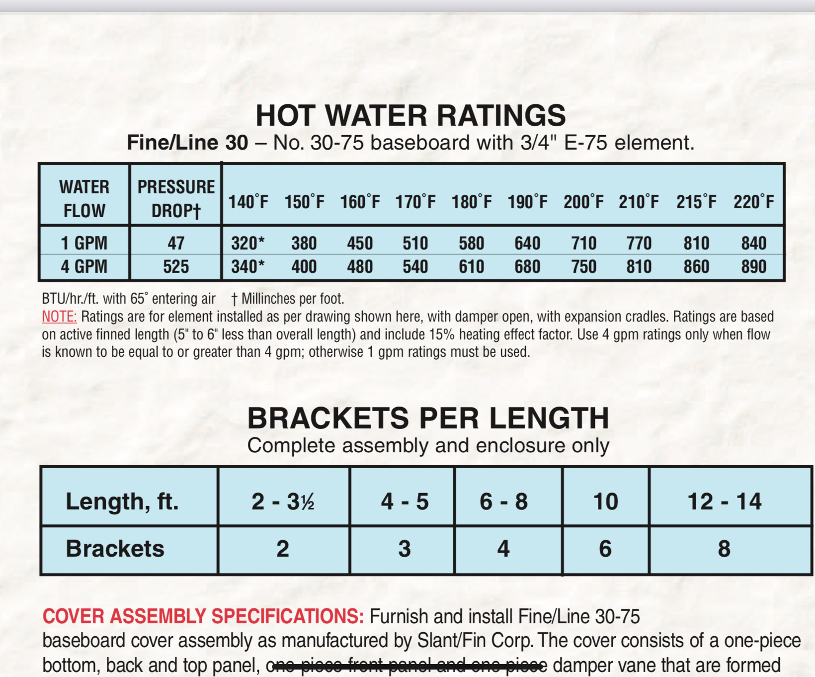

Here is a typical output chart for 3/4” fin tube
