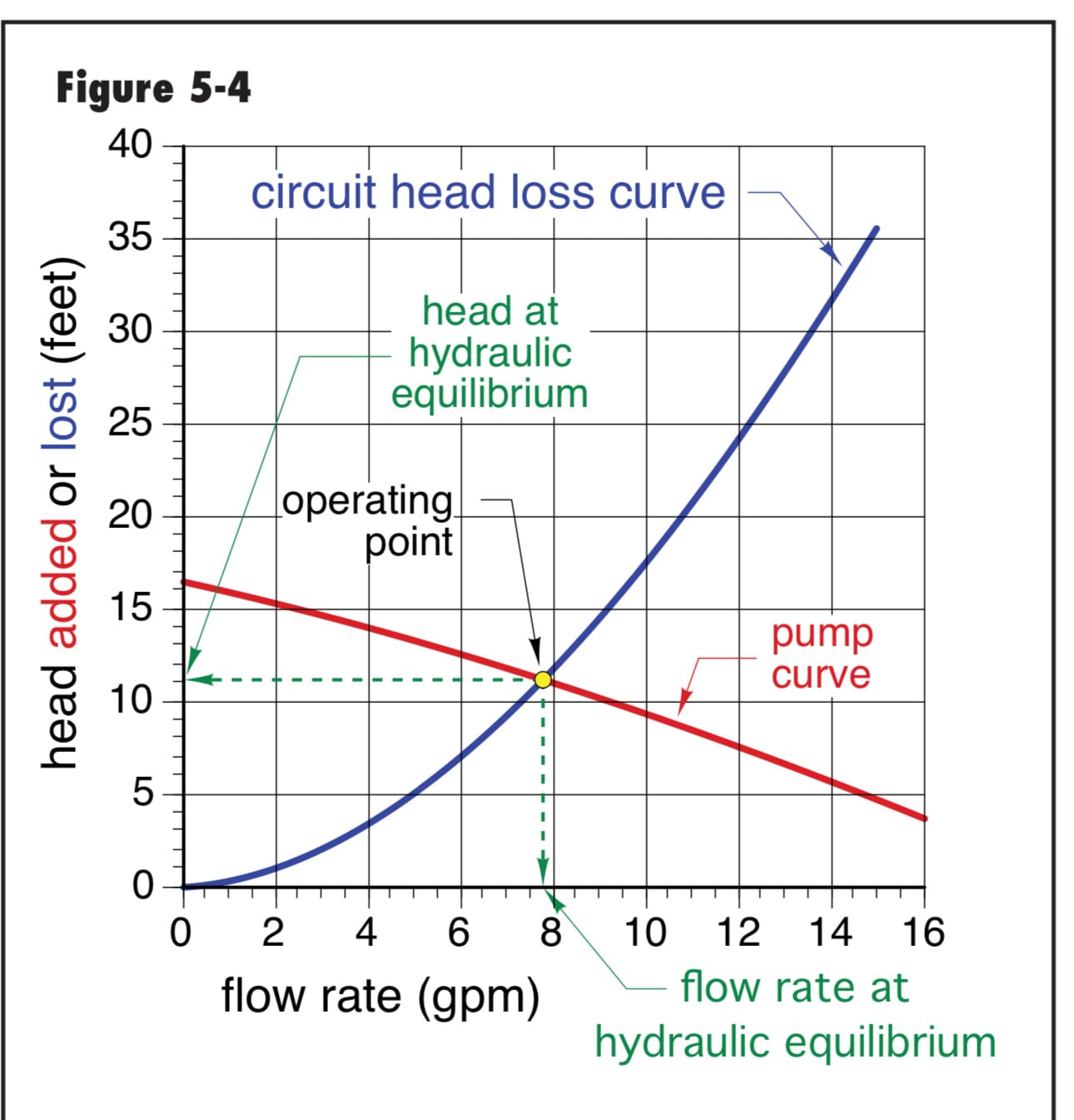

    the pump curve from the manufacturer tells you what the pump is capable off.
    A system curve that you develop based on the math you have done goes on top of the pump curve to show you where the pump is actually running.
    Best practice is to run in the middle 1/3 of the pump curve for a healthy life.

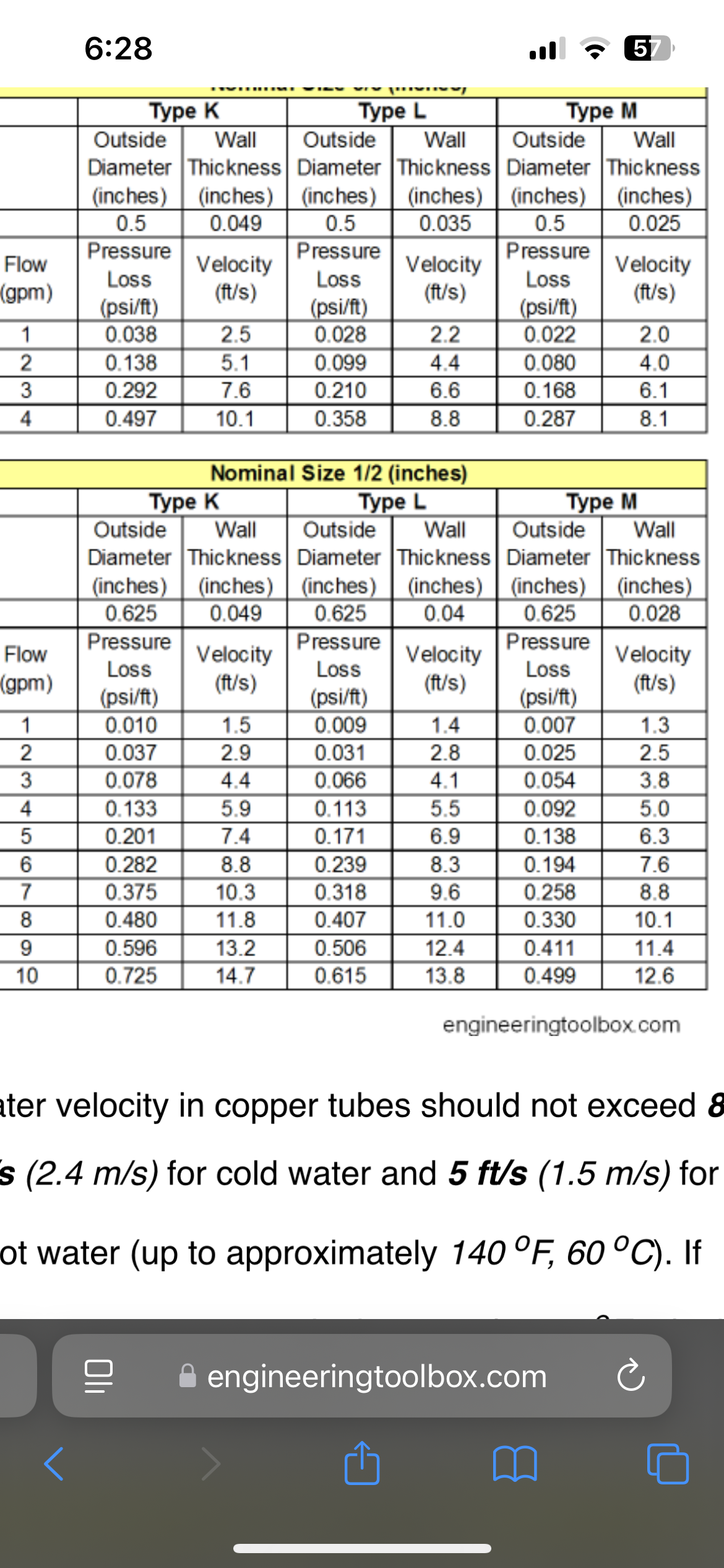

    hot_rod Member Posts: 28,076
    here is a table that shows pressure drop at various flow rates From Engineering Toolbox. Com
    1/2”copper Type M?
    2 gpm would be a safe design flow, 2.5 fps velocity
    Use the factor times the EL, the number is in psi multiple X 2.31 to get ‘ of head

    Id been using the H=a*c*l*(f)¹.⁷⁵ from the Caleffi idronics #16 publication. That landed me on the 13.5ish (including the larger return pipe length) at 3gpm. At 2 gpm as you mention it looks like 6.8ish ft total. A 007 could swing that.

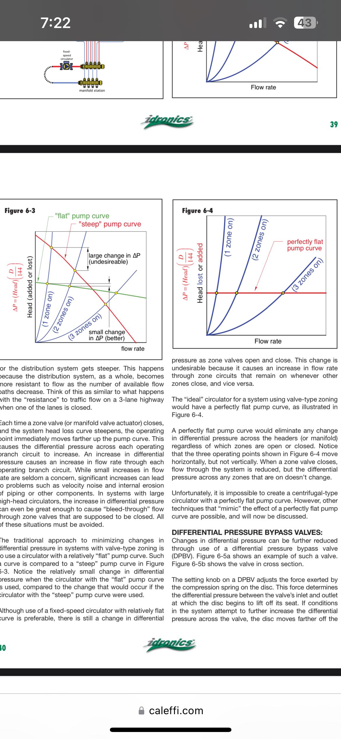

    If I know the head of each individual loop or zone, and let's pretend they are all balanced, how do I calculate the cumulative head if 2 or 3 are flowing at once?
    Jamie Hall Member Posts: 27,697
    By far the simplest way to handle two or more loops which are piped in parallel is to replace them with an "equivalent" single pipe which has the same hydraulic characteristics as the combined pipes. If all the pipes are the same material, it is sufficient to simply use an equivalent pipe with the same cross-sectional area as the sum of all the pipes in the loop. You can then calculate the head loss/flow curve in the usual way for that equivalent pipe. Then the flow in each individual pipe can be back calculated from the head loss.

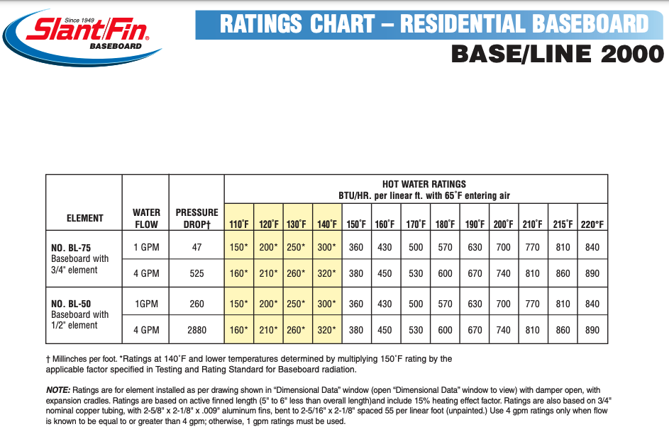

    You can try the following test to see if there are major flow issues, but realize that the output of baseboard at 1 GPM is only about 5% less than flow at 4 GPM. So if the flow is anywhere near similar, you probably will not be able to tell.

    Just know in the 1/2" fin tube that 4 gpm is going to cost you quite a bit more flow resistance. 1- 2 gpm is what I would design around
  • NEMatt
    NEMatt Member Posts: 87

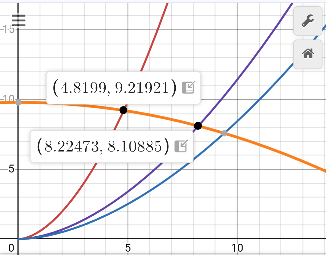

    Alright I went ahead and did it the right way.
    Calculated the head loss values/curves for each zone and plotted them against (what I back calculated to be the best fit for the Taco 007 pump curve.
    Red is my most used first floor zone (split loop)
    Purple is if my first and second floors are both calling (2fl is also a split loop)
    Blue is if all zones are calling (mudroom/kitchen is single pipe)
    With just the first floor running it'll be at right around 3fps through the pipes and with the two main zones it'll be around 2.6fps.
    Seems I'm to the good with the 007 after all. I was just not thinking about the additive effect of loops and zones right.
