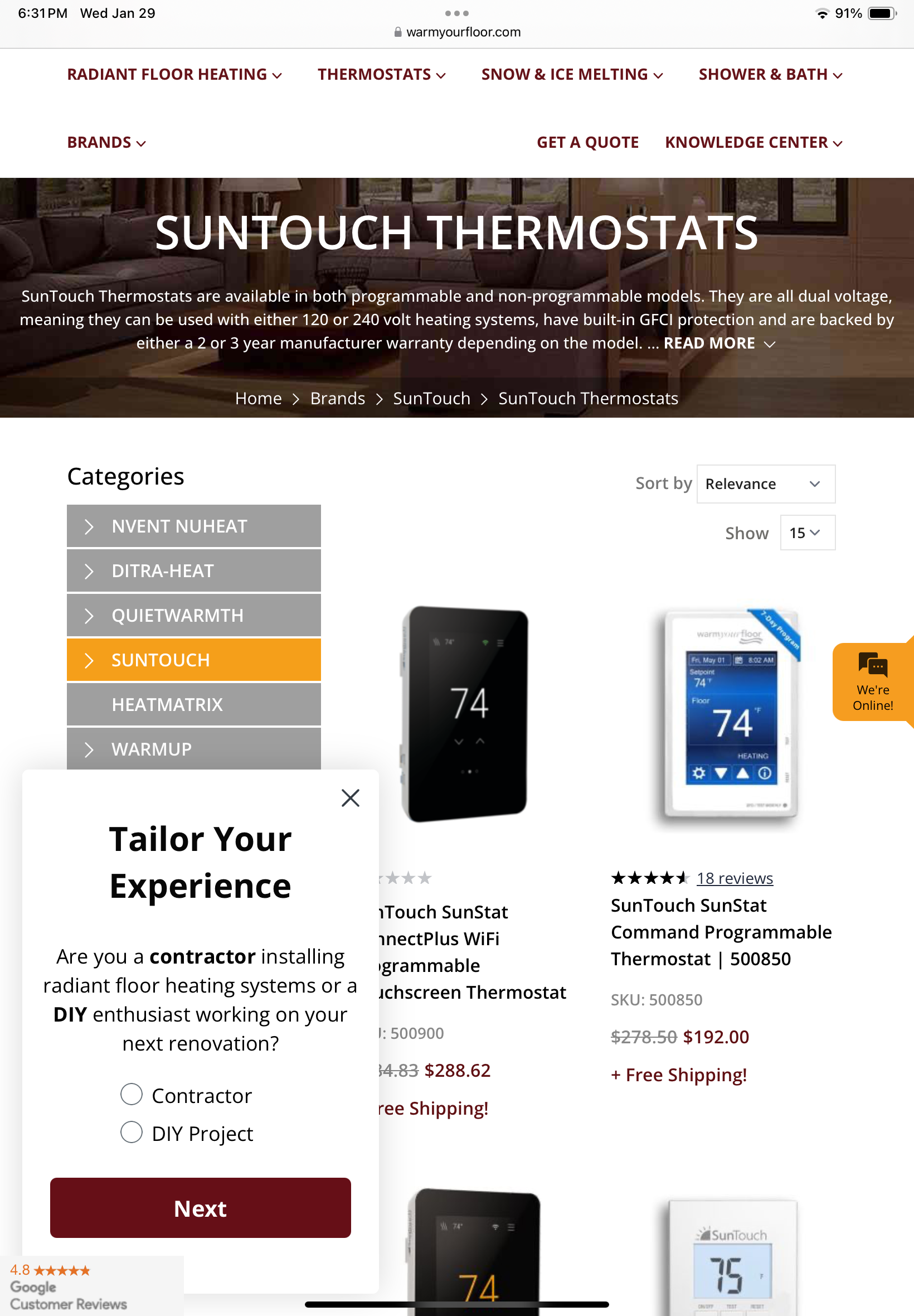

Some of the radiant electric systems have nicer 120 or 240 v stats
