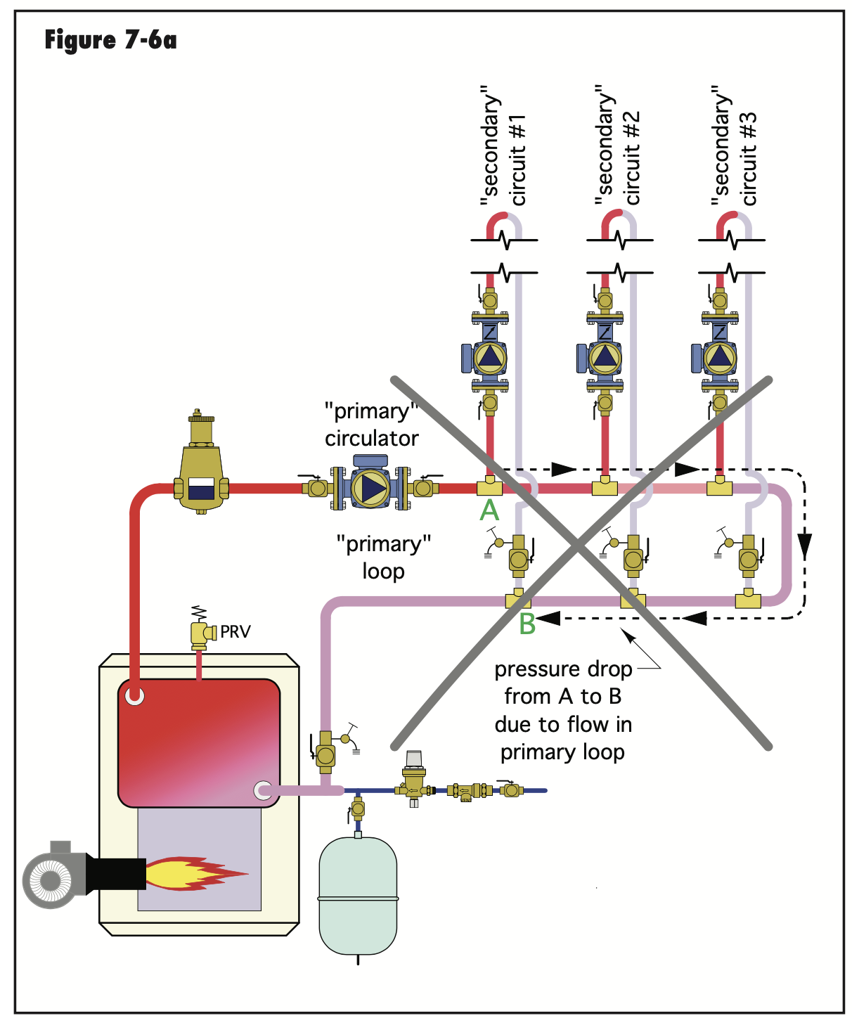

  • I can see what Clammy sees. I imagine something like this.
    By closing off the valve circled in Red the boiler pump will send the water through the high temperature loop when that zone calls for heat. If that Red circled valve is open completely then there will be very little flow thru the high temperature loop/zone.
    If the boiler pump also operates when there is a call for heat from the low temperature zone there is a chance of deadheading when the mixing valve closes off the hot water side in favor of the return water from the low temperature zone. This is why you can not close the Red circled valve completely. I am also guessing that the mixing valve visible in the photo on the lower low temperature loop is for cold water return boiler protection. But that is just a guess.
    Can you post pictures of your low temperature loops, mixing valves and pumps that are not pictured, but illustrated above?
    If this is close to your system, the best way to adjust that valve is to use an amperage reading on the boiler pump to see if there is not enough flow as you close the valve. You will need to do this under the most severe condition. That would be with the mixing valve temporarily adjusted to have the hot inlet side closed. Then close the hand valve until the amps on the pump reach about 80% of the rated amperage.
    But for now Just close it completely and then open it one full turn and see if that gets the system to operate properly.

    The main issue is it is not really a primary/ secondary piping. You only have P/S if you have closely spaced tees or a LLH or separator. There needs to be a hydraulic disconnect of some sort.
    So in that pic, if the valve is closed the boiler pump is put in series with the radiant pump for example.

    it is the most common piping error we see, over and over. It usually includes ghost flow issues also.
    Good intentions, bad execution.
