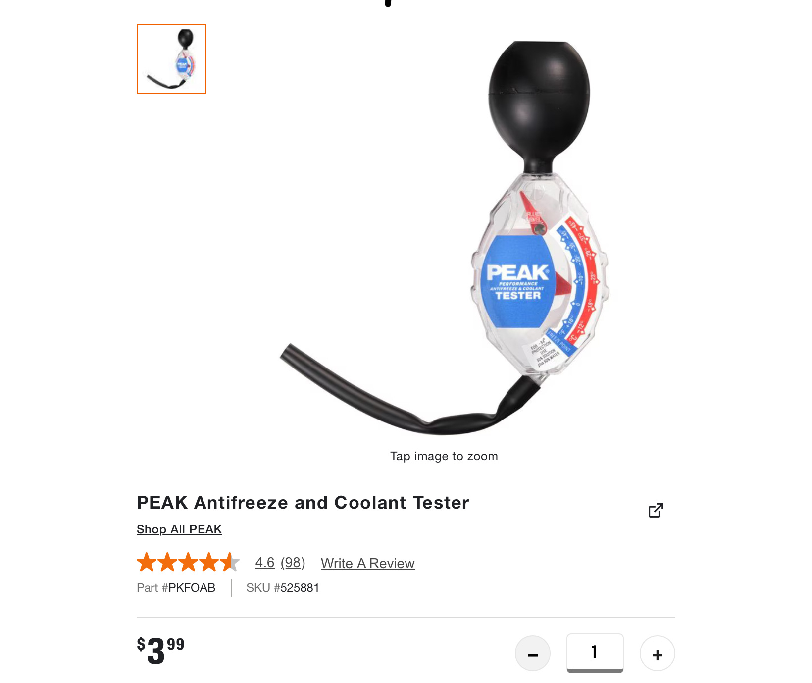

    I would take a small sample of the fluid in the tank to get an idea of the freeze protection. A simple antifreeze tester like this is close enough. I like the meter type best.
    Then check the fluid in the container.

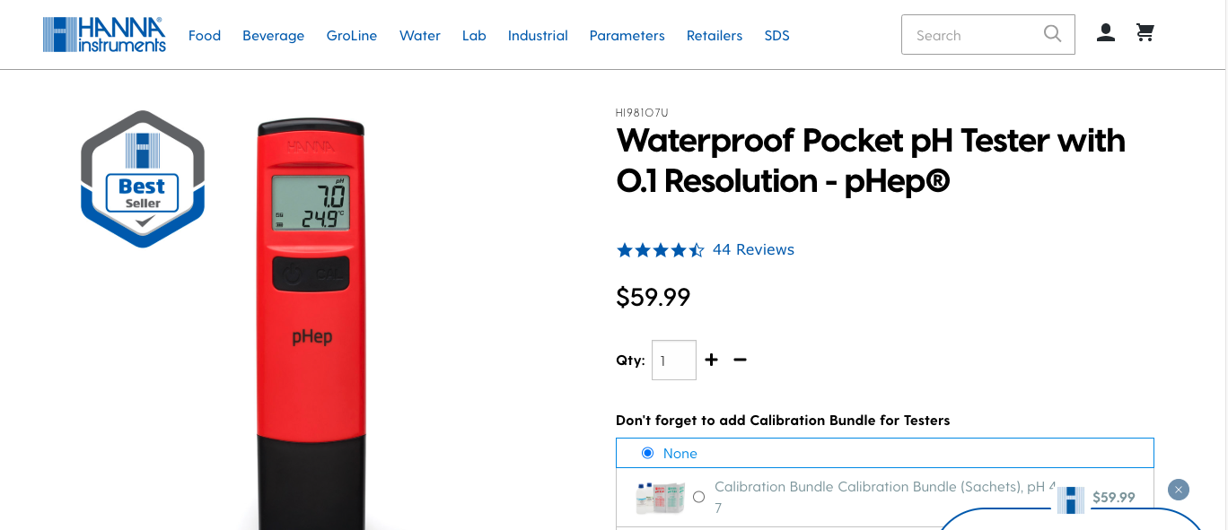

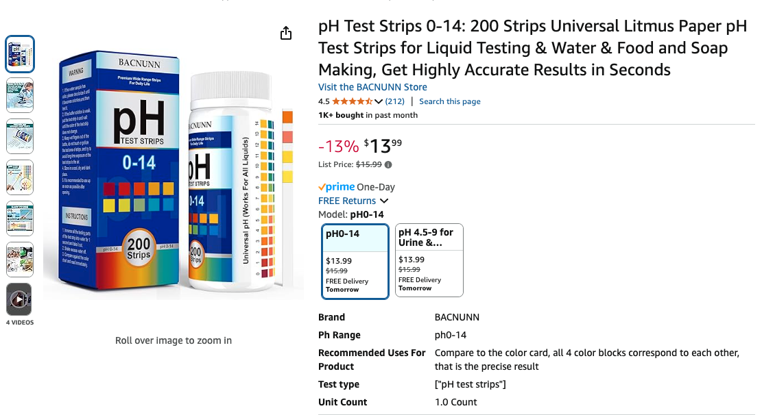

    The best test for the condition of the glycol is a Ph meter or Ph test strips. If you determine which % you have, download the data sheet for Ph range. If it drops below 7 ph it may be time to flush it out and start over anyways.
    14 years old is getting up there. But it depends how it was installed. A clean or dirty system for example, If any O2 has entered the system.

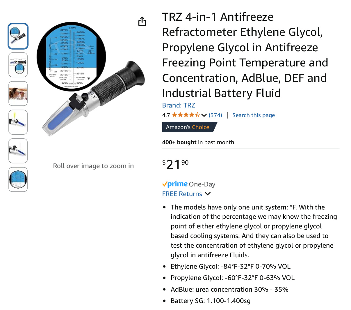

    A refractometer available on amazon will tell you the concentration.

    thanks guys for the help. The tank is testing around 7. I will contact a plumbing/heating company in town and look at having the system flushed so we can have a new starting point for the maintenance.
