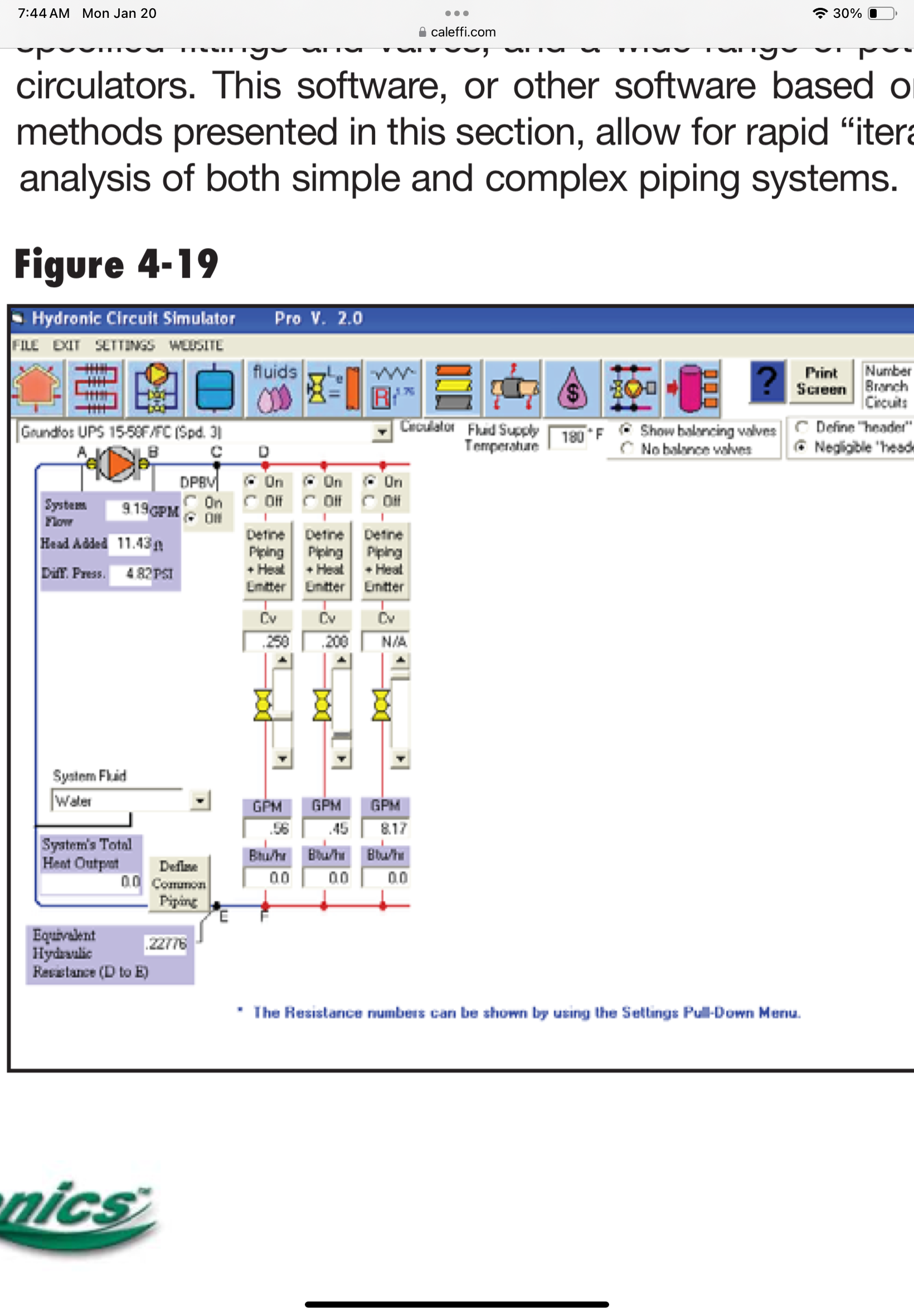

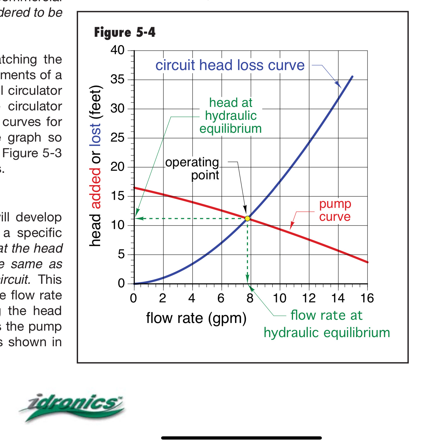

    the readings of flow on m many of the small ECM circs is a calculation, not an accurate flow measurement. I believe power draw and rpm are used. I have seen as much as an 80% discrepancy when measured with lab quality, certified flow measuring devices.
    The type of fluid, and air in the fluid stream can throw off the numbers.
    Some circulator models and brands have small flow sensors mounted in the pump body. They use a vortex shedding technology. Those too can be a little inaccurate.
    If you can develop an accurate system curve, lay it over the pump curve, you can nail down an accurate operating point and get a better idea of the actual flow rate to use in that equation
    A module in the HDS software can develop the OP, and an find example of a long hand calculation in Idronics 16

    @HotRod What software is that you have in the screen shots? Caleffi's?
    hot_rod Posts: 28,708
    Hydronic Design Software
    Find it a www.hydronicpros.com
    There is a free demo version, it is Windows based only
    The pump database is being updated also
