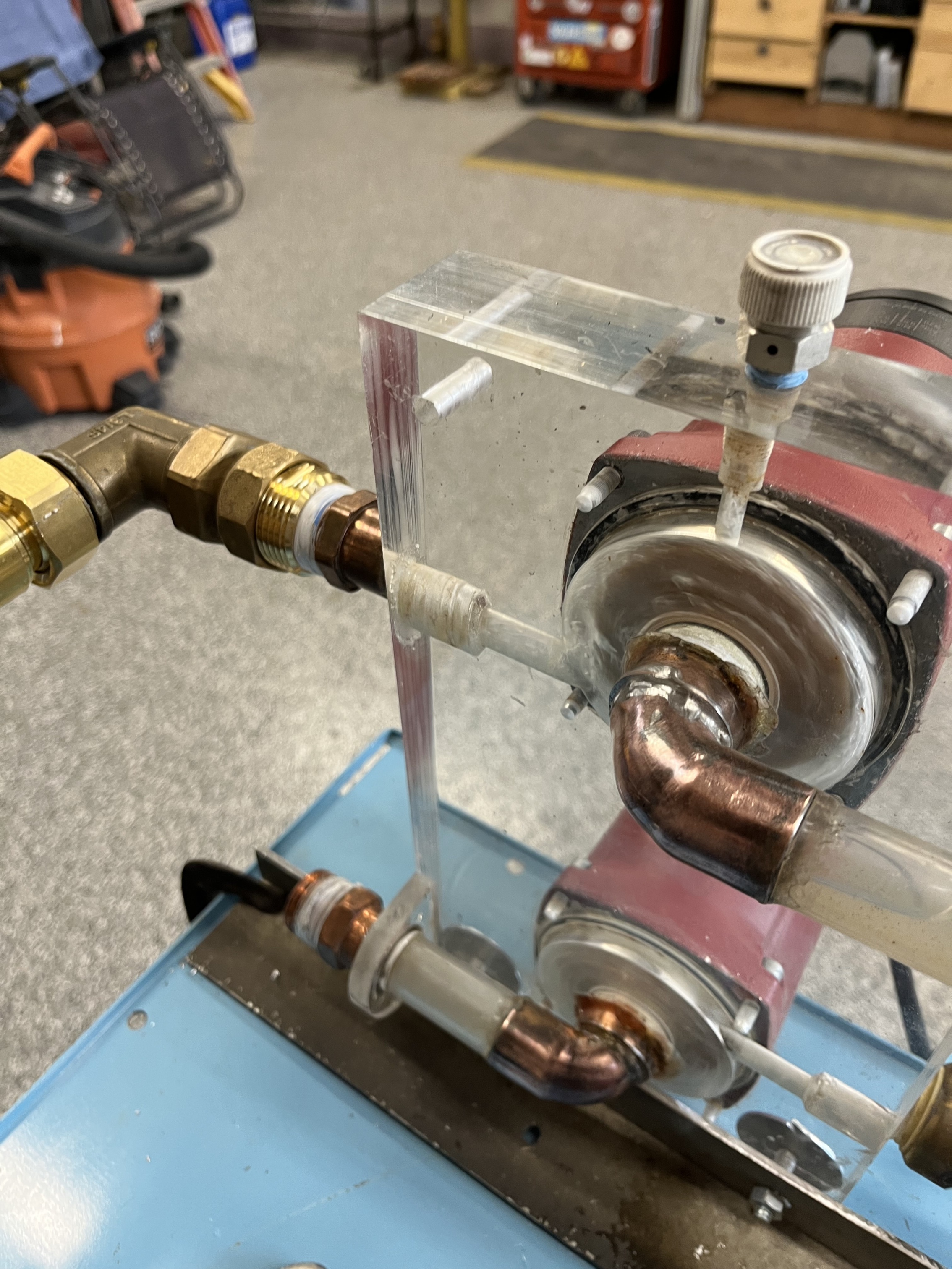

    some of the ECM will try to purge air out by revving up the speed for a period of time. If you have air pockets in the pump volute itself, that doesn’t always work so well
    I built these clear plastic pumps to observe how air gets trapped in the pump volute, occasionally
    The check valves in the pump bodies can also trap air in the pump so the pump will not flow properly until it can pop open the check to send the air to a purger
    Notice I added small bleeder into the pump to demonstrate the air removal better.

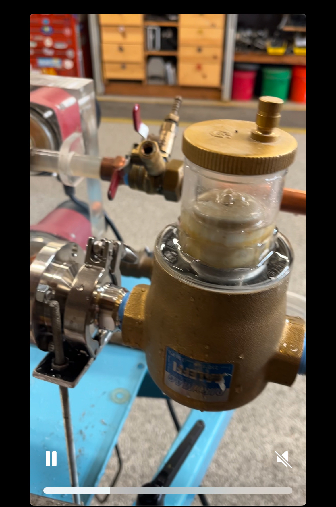

    Sometimes boosting the fill pressure a few psi will get rid of an air problem. The pressure increase squeezes the air pockets down so the travel to the purger better.
    I have some videos of this in action
