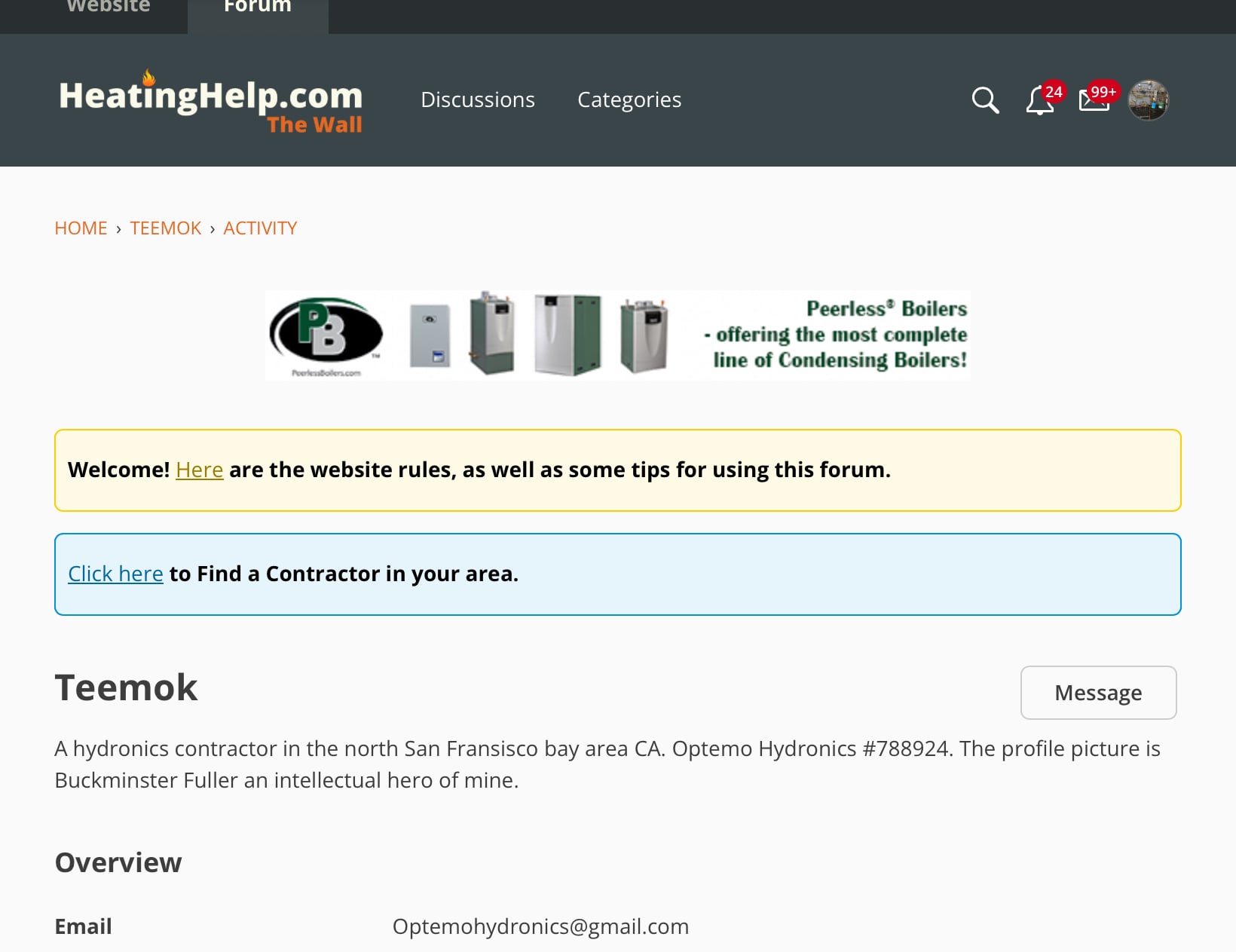

    hot_rod Posts: 28,699
    give a shout out to member Teemok He is a knowledgeable hydronics contractor experienced in your area
    Teemok

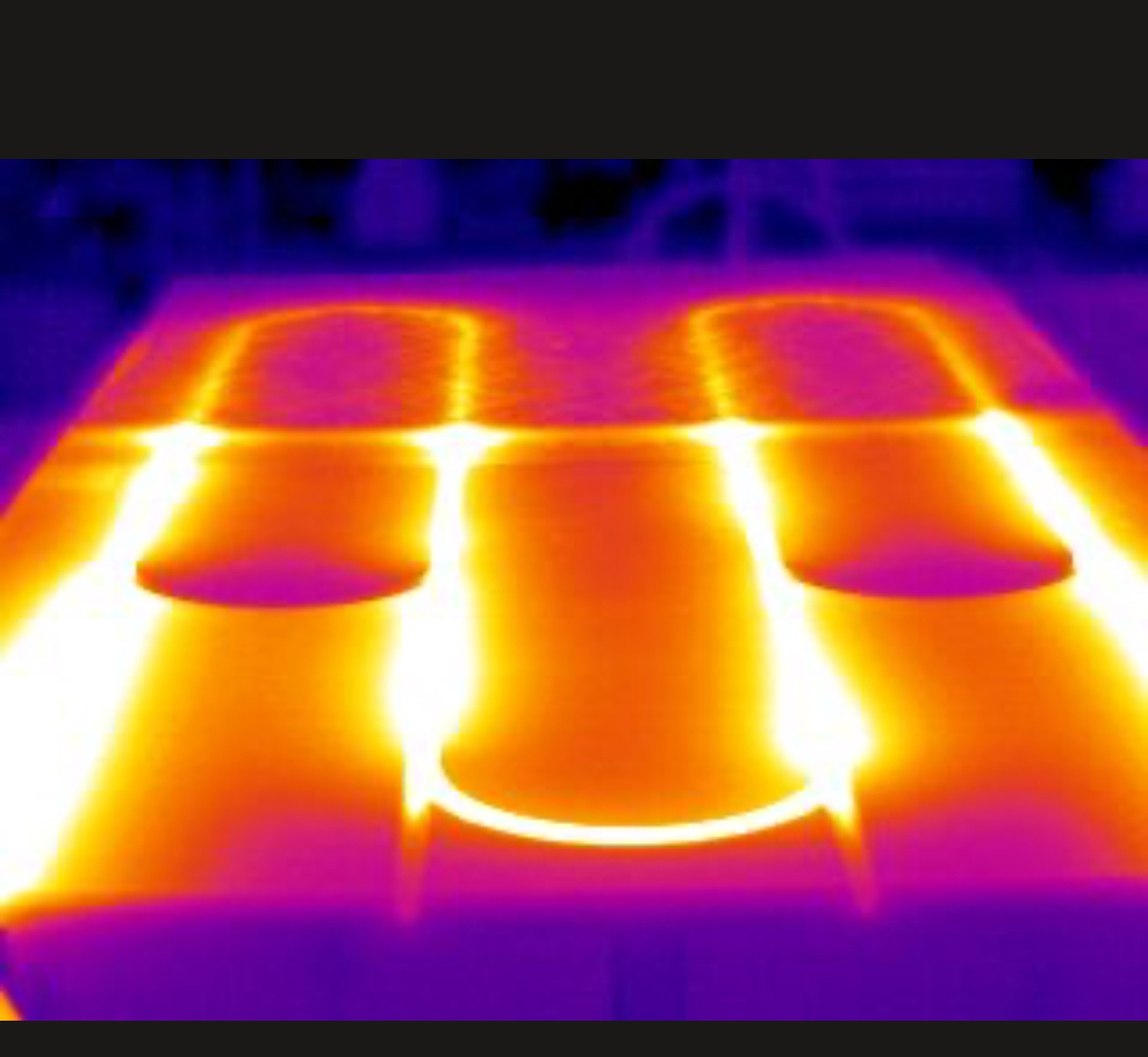

    Warmboard us a structural panel so it serves a double purpose. In some cases I think you can widen the joist spacing since it is 1-1/8” plywood, maybe save some framing bucks
    Noticed where I routered across the panel and cut out the aluminum layer. It shows the power of the continuous aluminum conduction
    The back 1/2 of this sheet has carpet over it

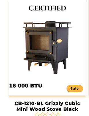

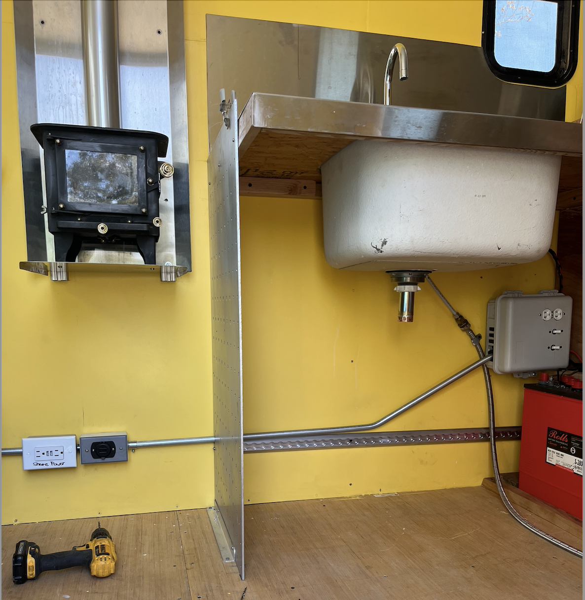

    edited January 2025
    Here is the woodstove I have in my camper. I heat and cook on it with scrap 2x4 wood, free at most any joibsites. The inventor developed it for sailboats, as he struggled to find a good quality stove for this own boat.
    It burns very clean with a bit of a gasification section in the design.
    It's about 12" square, takes up little room.

    That actually looks pretty cool.
    The picture says "certified," do you know if it is EPA-certified and UL-Listed? We can't install if it's not. Insurance company is even pickier.

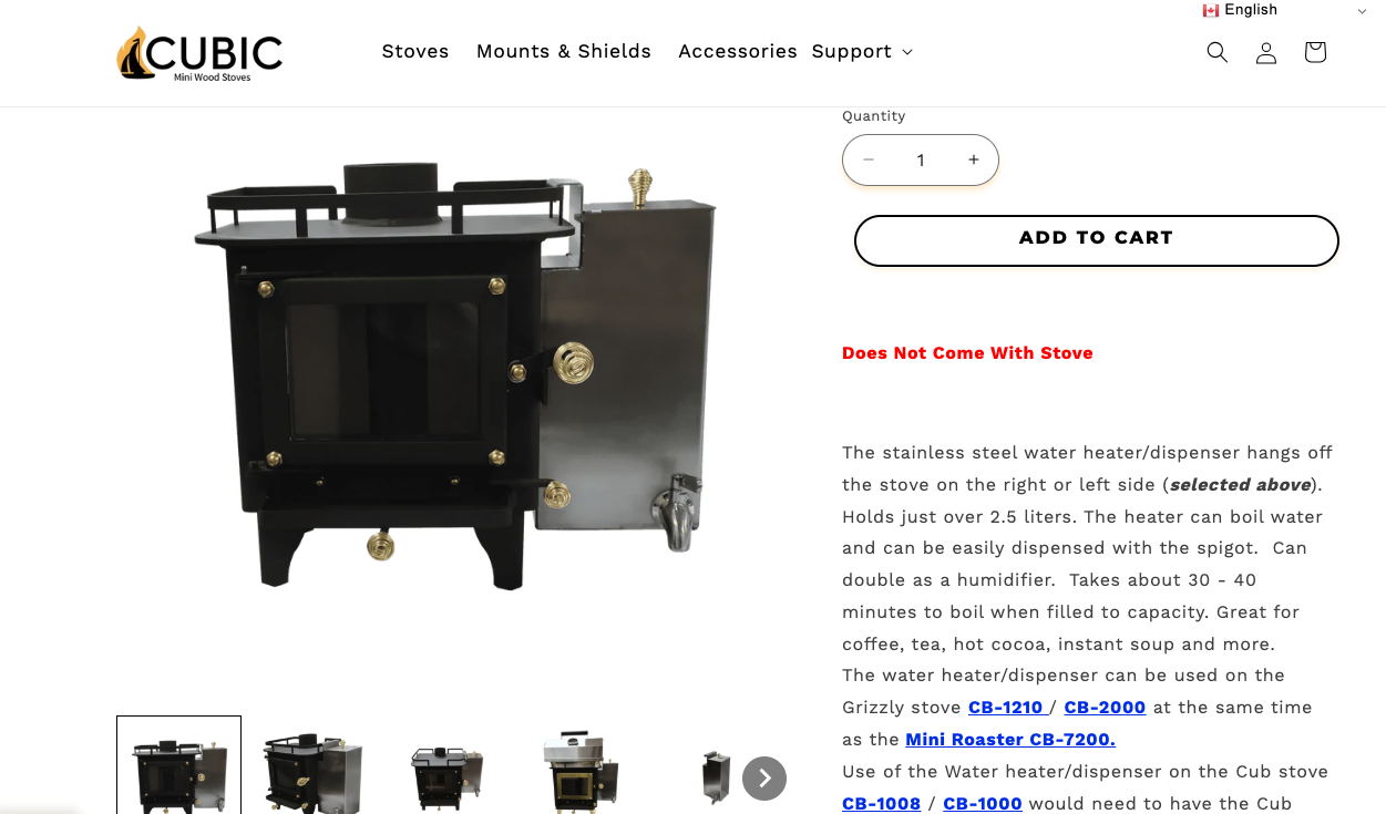

    "Much simpler and easier than trying to modify a heat pump DHW (with all its pre-programmed control algorithms) to this purpose."
    A heat pump water heater is completely unsuitable for space heating. It takes heat from within the conditioned space, it's like trying to build a perpetual motion machine.
    An air-to-water-heat pump takes heat from the outside air.

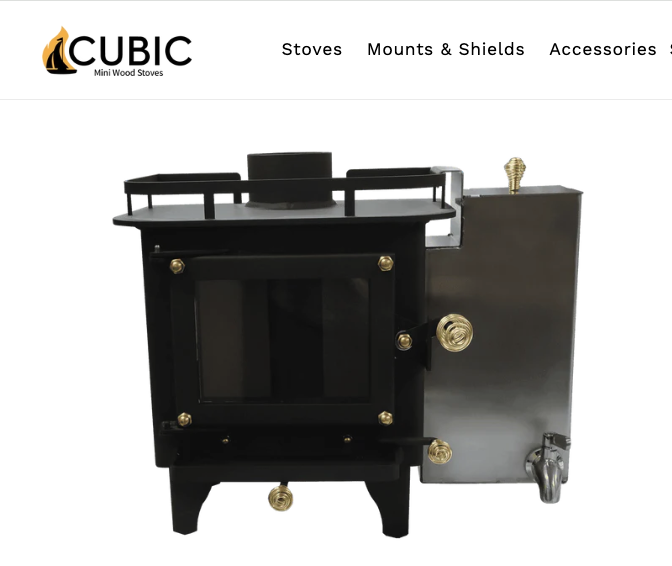

    I see they have added some accessories for the Cubic minis. A little water tank for making boiling water and a grill attachment.
    Mine has a pipe connection at the air intake. I guess it could get air from outside. I like to crack a window regardless. And keep the CO detector running.
    I have one of the heat motor fans also to help dry clothes in front of it.
    I visited the factory years ago when I was in Montreal doing trainings. Nice people.
  • Hi, I like that last photo. It's essentially a modern range boiler, with no pressure. Some old cast iron kitchen stoves had a similar hot water tank. Simple and effective 👍️
    Yours, Larry

    From the website it looks like the stove is UL-listed but not EPA certified.
