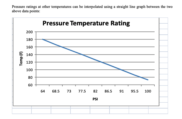

    The thing with PE or PEX tube is the tube can run higher temperatures as the pressure is lowered. The testing is done at 73°.
    So on this graph you see where the 150 crosses the temperature slope at 73°F.

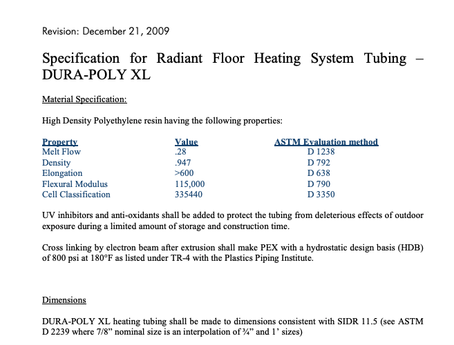

    Some posts back @DCContrarian posted this. I know it is not the correct vintage data. But a sheet like this for the tube you have may be identical? At least in the performance spec.
    I suspect they made a change in suppliers along the way.

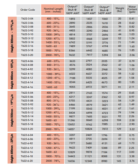

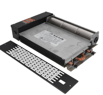

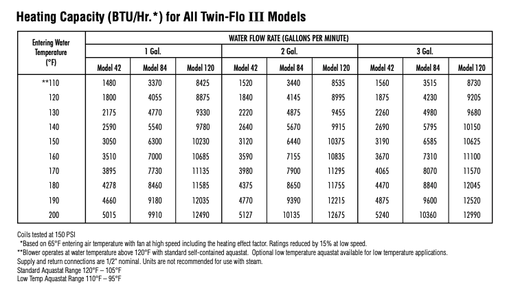

    If you do want to add supplemental heat, a small fan convector, 1 gpm flow, 19 x 12" will give you a lot of bang for the size and price.
    At 140°F you would need a $$ panel radiator about 2' tall 6-1/2' long to get the same amount of btu.
    Output spec attached for typical products.

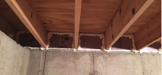

    Here is how I did mine. Measured the bays, cut the blocks, left a small gap to squirt the foam around it.
    Use the minimum expansion version spray cans, the "big gap" cans tend to push the foam blocks out, and the cans don't last as long.
    A hand saw cuts the foam easily, or a hot knife. It can be done on a table saw or with a circular saw, but it makes a mess. And the blades can grab if you are not careful.

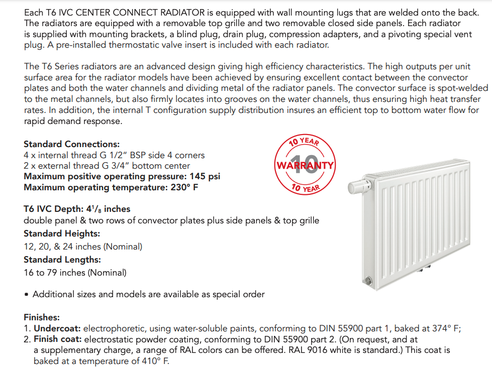

    It is a finished basement with a drop ceiling. I saw in previous replys the mention of a panel radiator? Will they work with my current 140*F or do they need 180*?
  • ColdHouse
    ColdHouse Member Posts: 109
    I just looked one up and found this:
    Technical Specifications:
    • Dimensions (H x L x D): 24" x 36" x 2-3/4"
    • BTU Output @120°F: 1,389
    • BTU Output @140°F: 2,237
    • BTU Output @160°F: 3,145
    • BTU Output @180°F: 4,104
    • Water Content (Gal): 0.76
    • Max Operating Pressure: 145 psi
    • Max Operating Temperature: 200°F
  • PC7060
    PC7060 Member Posts: 1,862
    yes, at reduced BTU/ft from 180F but still very nice heat at 140F. My house runs low temp through radiators with max of 120F SWT and is very comfortable.
  • tim smith
    tim smith Member Posts: 2,935
    can’t do panel radiator with non barrier tube in system, you will regret it. Panel rads are pretty much all ferrous steel. Rust out.
