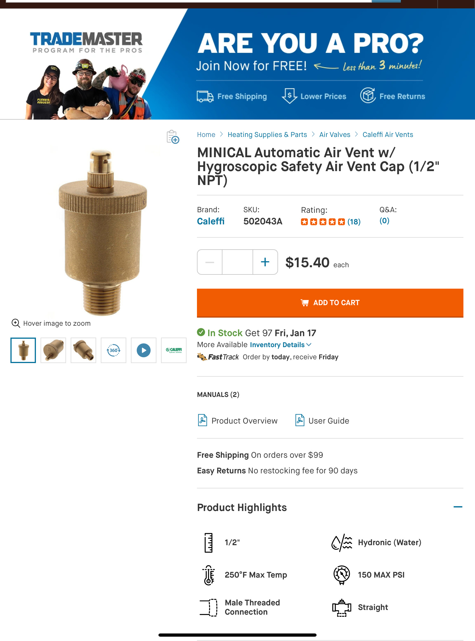

    i am trying to buy a new airvent from supply house but i am not sure which one it is. I have cleaned it a bit and took some pictures, can you let me know which model/make is it ?
    i thikn it is this one:
    https://www.supplyhouse.com/Taco-400-4-1-8-Hy-Vent
    hot_rod Posts: 28,705
    that looks like an 1/8” vent. Here is a good option.
    If you wanted to change the fitting below, this 1/2” model has a safety cap that would protect against leaking if the needle valve inside fails or gets scale under it.
  • In that location the air vent is a 1/8" HyVent. and can be replaced with any of the generic air vents. Taco, Maid-o-mist, Caleffi 502610A. and Honeywell Braukman even has them. It is a pretty standard Supply House part that is often replaced on a regular basis. I would replace at the same time as the tank service because both require draining off the pressure. Maybe not the entire system, but you need to have no pressure on the boiler when you swap them out. I have done both those jobs "On The Fly" (expansion tank, relief valve, air vent and other items) by just getting the boiler pressure to zero and having the replacement part ready with pipe dope and a quick hand. Minimum water loss.
