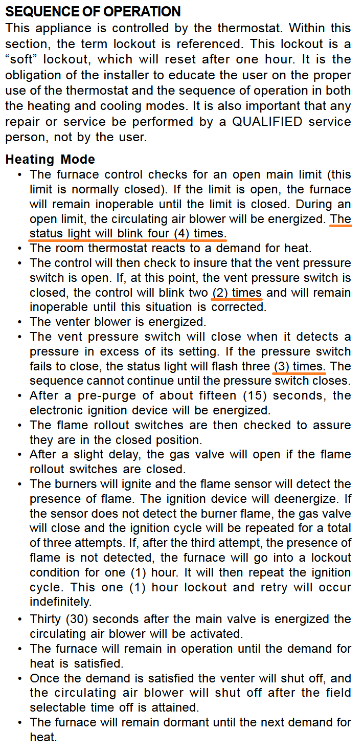

Looking for some confirmation of my suspicions of an issue I'm having with our furnace. First, my specs:
Janitrol Furnace: Model: GMNT100-4B
Honeywell Zone Controller: Model: HZ322
I am having the issue where the furnace will follow this cycle sequence intermittently (2-5 times a week, maybe more!) I notice this when I am home in the evenings and during the night, but it could be happening quite a bit more during the day.
Actions Description:
Induction = Induction Fan
Burn = gas ignition and burning
Blower = fan blower running
My assumptions and this is where I need help diagnosing:
  1. Gas valve regulator failure
  2. Motherboard failure
Any help and direction would be helpful. I plan on calling a professional in my area to do some, if not all, of the work necessary. I can replace a few things, but I prefer not to work with black iron/natural gas.
Thank you!!

  • Good morning. I am resurrecting this thread again because we're having somewhat of the same issues we had last January, but now with a twist. All of what I am about to describe occurs intermittently, because sometimes the furnace will operate normally for a time.
    We have two Sensi Wifi Thermostats, one upstairs and one downstairs. What we have noticed over the past few months is that when a zone calls for heat, the induction fan turns on, the glow plug will initiate after a few seconds up to a minute or two, but the gas will not ignite. This will happen for about 5-10 minutes and then the induction fan just turns off, yet the thermostat (and zone panel - red) is still orange (calling for heat). It will stay orange for quite some time with no response from the furnace.
    We've also noticed that when both zones are calling for heat, the furnace won't do anything sometimes at all or will go through the sequence I described above. We have cleaned the flame sensor in attempt to make sure that isn't the culprit. The condensate pump is functioning properly and there does not seem to be any water in the pipe from the condensate box. So, I'd like to get a little more of an idea as to how I can focus the HVAC technician in an attempt to weed out the problem possibilities. OR, maybe it is something that I can just replace and fix DIY.
    Any help would be appreciated. Thank you.

    Assuming the call for heat from the HZ322 is valid and consistently getting to the furnace, I would want to know if the furnace is locking out. If so why ?
    No hour lockout delay, I'd check the call for heat from the HZ322.

  • HVACNUT and 109A_5, thank you both for your responses. Looking into what you both suggested, I will be limited on what I can check. I won't be able to check the volts on the gas valve and static pressure. I'll have to leave that up to the HVAC Technician. The lockout theory though sounds like that may be closer to what we are experiencing. There aren't any flashing lights though on the HZ322 at any point. They are always solid. I will take off the front panel on the HZ322 to monitor if there are any error codes that are displayed on the screen. I didn't see any last time this happened, but maybe something is coming up this go around. The lockout description is a very plausible theory that I will present to the technician.
    Thank you again for your help!
    109A_5 Posts: 4,759
    The flashing Status light (or LED) is for the furnace and you may have to look through a small clear plastic view port to see it.
