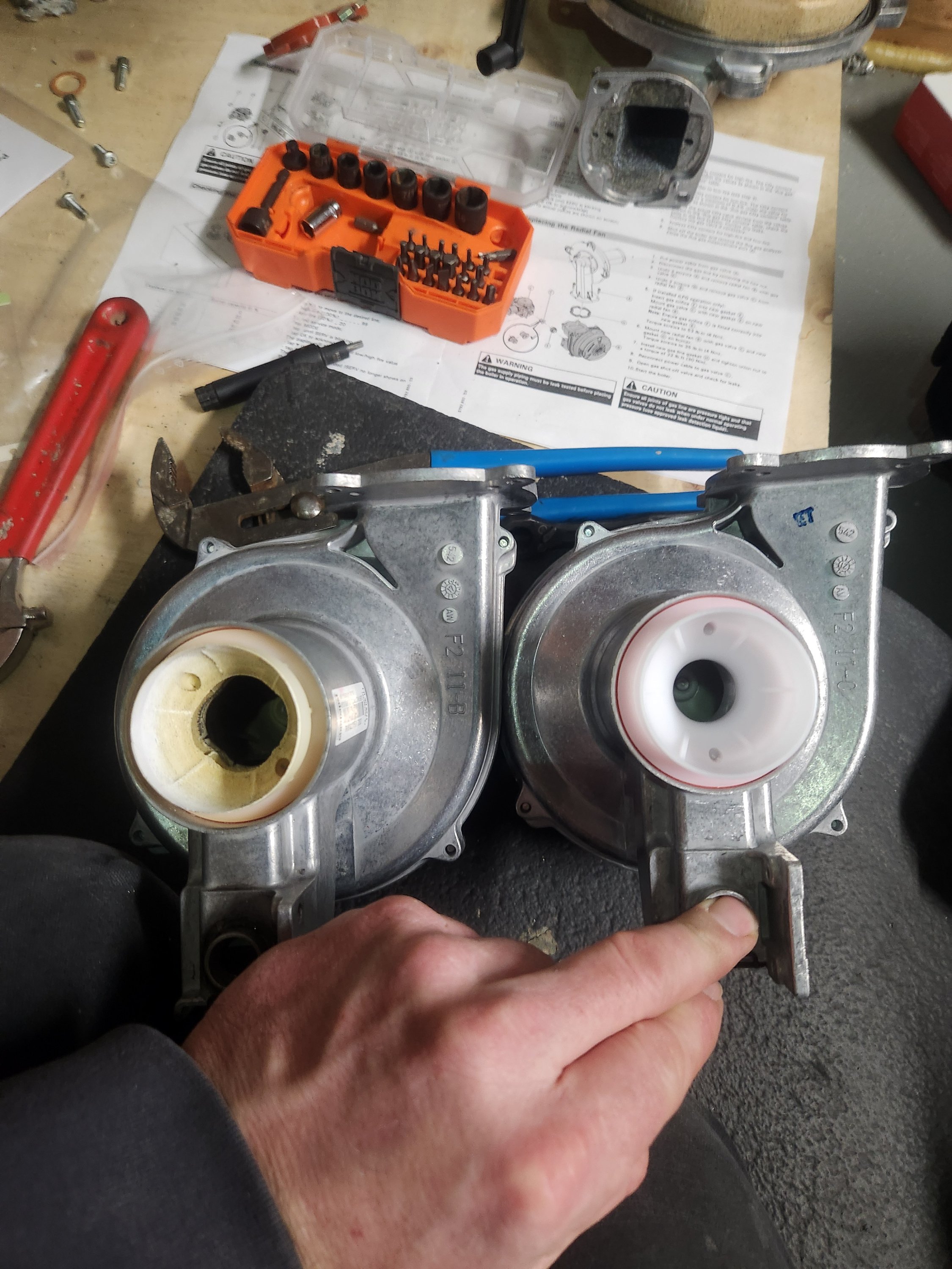

We have a Viessmann Vitodens 100-W propane furnace and the Radial Fan NRG118 air intake port deteriorates to the point where it drives F4 errors and has to be replaced. Also noticed fouling on the it's burner interface flange. Seems like the burning propane flame is somehow backing down the input channel which I can't imagine is intended. Please see the photo's below.
Any thoughts on why this is happening would be greatly appreciated, we are now on our 2nd fan replacement in 6 years!!!
Thanks, Paul

    It's flue gas recirculation. the flue gasses are re-entering the cabinet and being sucked in to the fan. From my estimation that is really extreme. I've seen at least a hundred jobs where there is considerable flue gas recirc on these boilers and never seen the venturi wear down like that, seen plenty of the "paper" style venturis break down. In the bottom left of the inside of the cabinet there is probably a big brown or black spot like rust sort of. The cure is to separate your vents, the intake should be pulling in fresh clean air only and be separated from the exhaust, not just to manufacturers minimum separation it needs to be separated enough that it doesn't recirc.
    If you really think it's the flame getting sucked out of the fan you can always pull the burner and have a look. My guess is that its not pretty in there! The burner should get pulled out and everything cleaned and put back to factory spec annually (every other year realistically.)

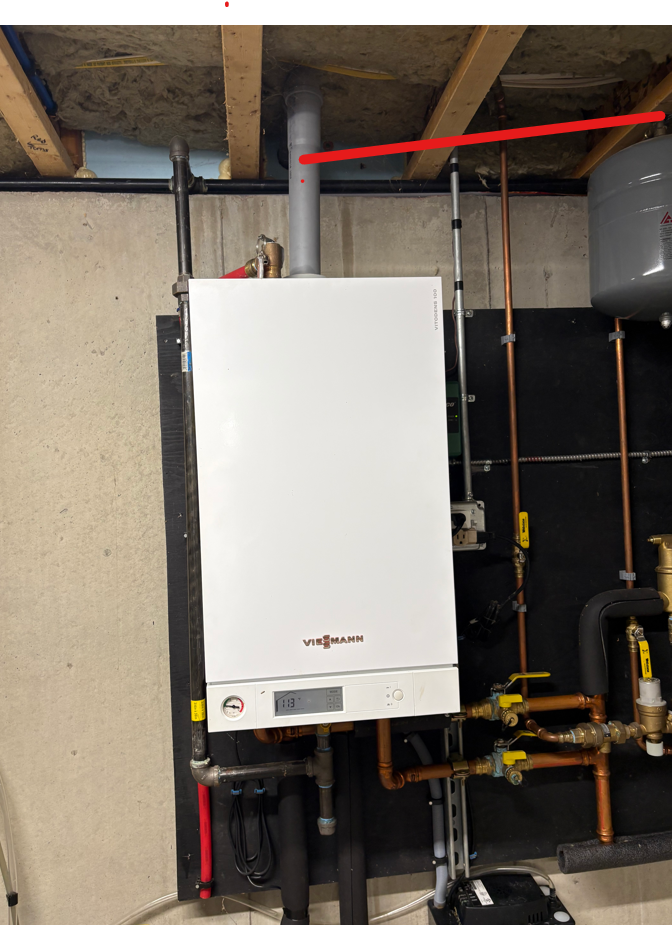

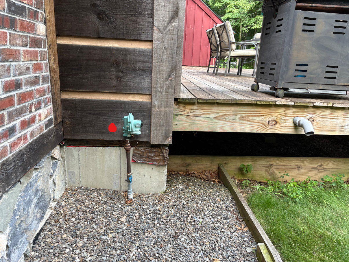

  • Hi @gibbs05, @GGross, @mattmia2, @kcopp, @Alan (California Radiant) Forbes,
    Here are some pictures of the furnace. The intake is just the hole in the top and the exhaust goes out the wall and through several deck joists so can't be moved if the condensate pitch is not proper. Unless the exhaust is leaking where it leaves the furnace, I don't see how it could be recirculating exhaust… not sure how to tell if it is leaking. Thanks for any suggestions, Paul

    that looks like a long outdoor run, how long is that deck/run? any concerns about condensate freezing in what looks like might be a flat run? and freeze plugging the run?
    Where are you? How cold do you get there?

    It dose not look like there is much if any pitch on the vent.
    Should be 1/4" per foot.

    I'm considering rerouting the exhaust as shown below reducing it's length by a good 4 feet. It will also keep all but the very end within the house eliminating the possibility of freezing condensate.

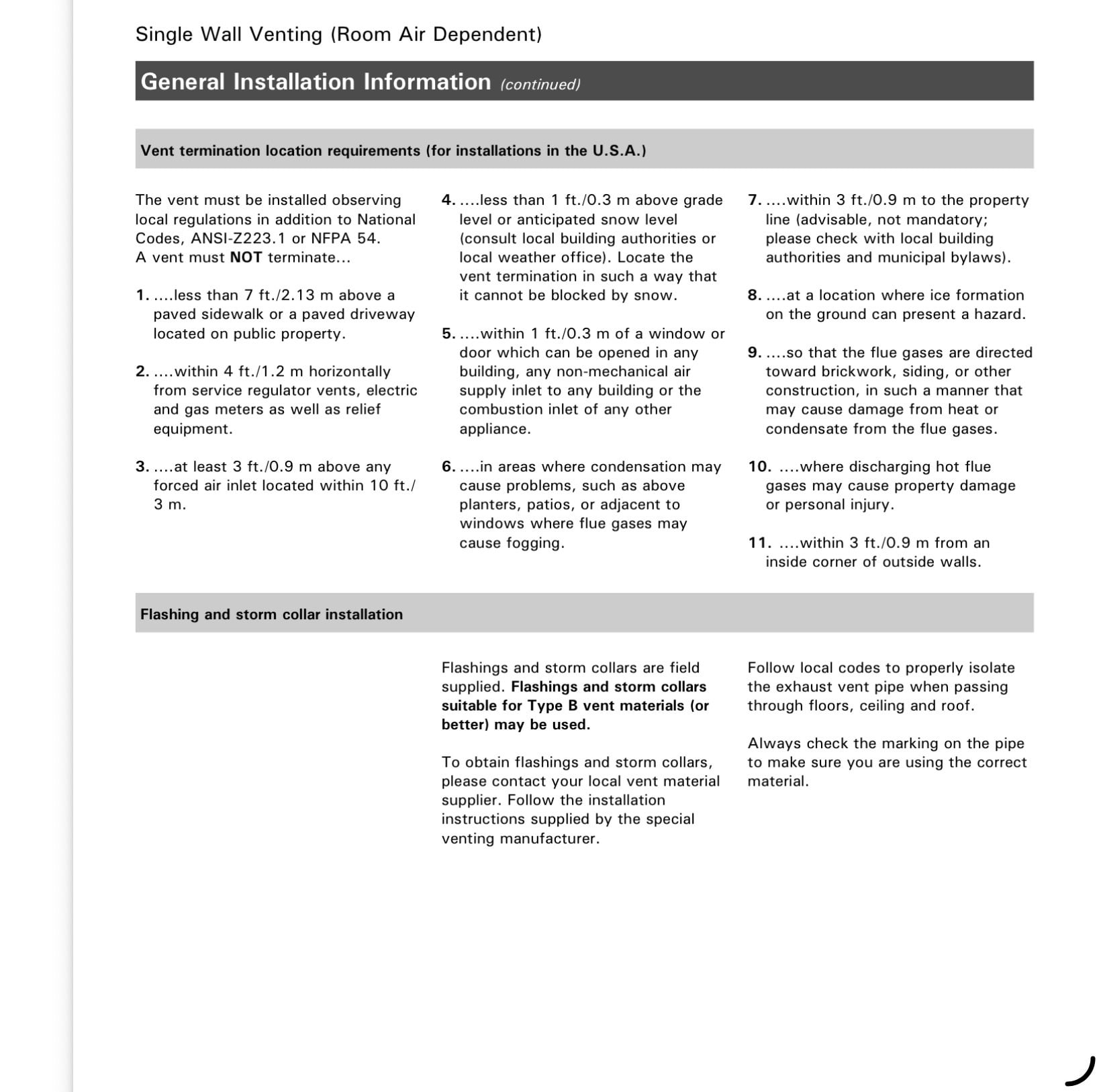

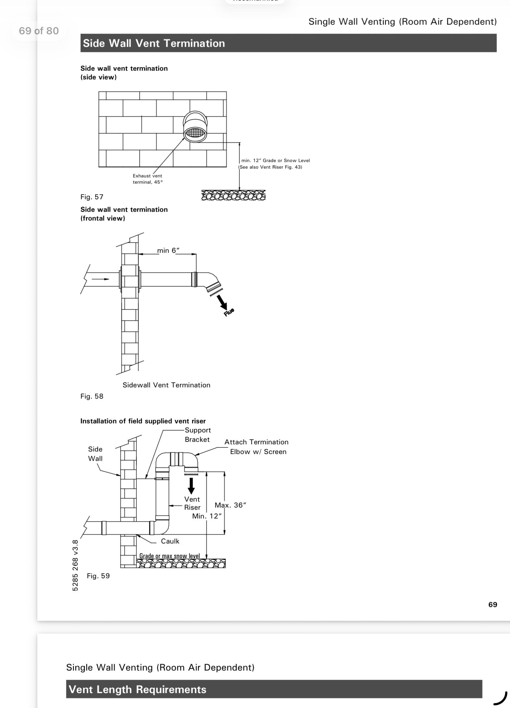

    Does anyone know if there is a code that the propane exhaust has to be further from the house?
    pecmsg Posts: 7,644
    read, understand and follow the manufacturer’s instructions
    hot_rod Posts: 28,769
    the code will typically refer you to the manufacturer’s installation manual for the venting installation and termination, etc.

    EBEBRATT-Ed Posts: 21,352
    The above posts by others are correct. no inside corners and not near a gas regulator or meter.
    I would download the instructions for you boiler and follow that.
