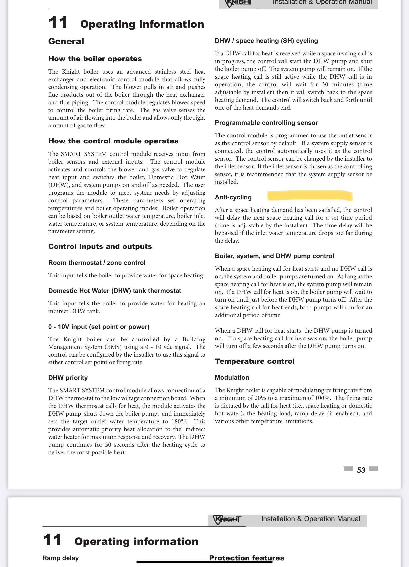

    resurrecting the old thread. issue is coming up again. last time it ended up (most likely) being issue with propane regulator upstream. started happening again this year. so, is there a way to limit the firing rate to some number below 100%? the reason why i want to do that is to keep house warm until technician gets here, which might be few days at least if i'm lucky…
  • lkhelp
    lkhelp Posts: 38
    I'm trying just to keep house warm until tech can get here and fix the underlying issue… is there a way to lower the maximum firing rate below 100%? thank you!
    edited December 2025
    look at the manual and the installer menu items. i'm sure there is the option in there.
    check the vents on your regulators, if they ice over then the regulators for the propane won't work right.
    you can also have too much drawdown from a tank for its size and the ambient temp and it can't boil off enough propane to cover the demand.
    lkhelp

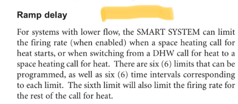

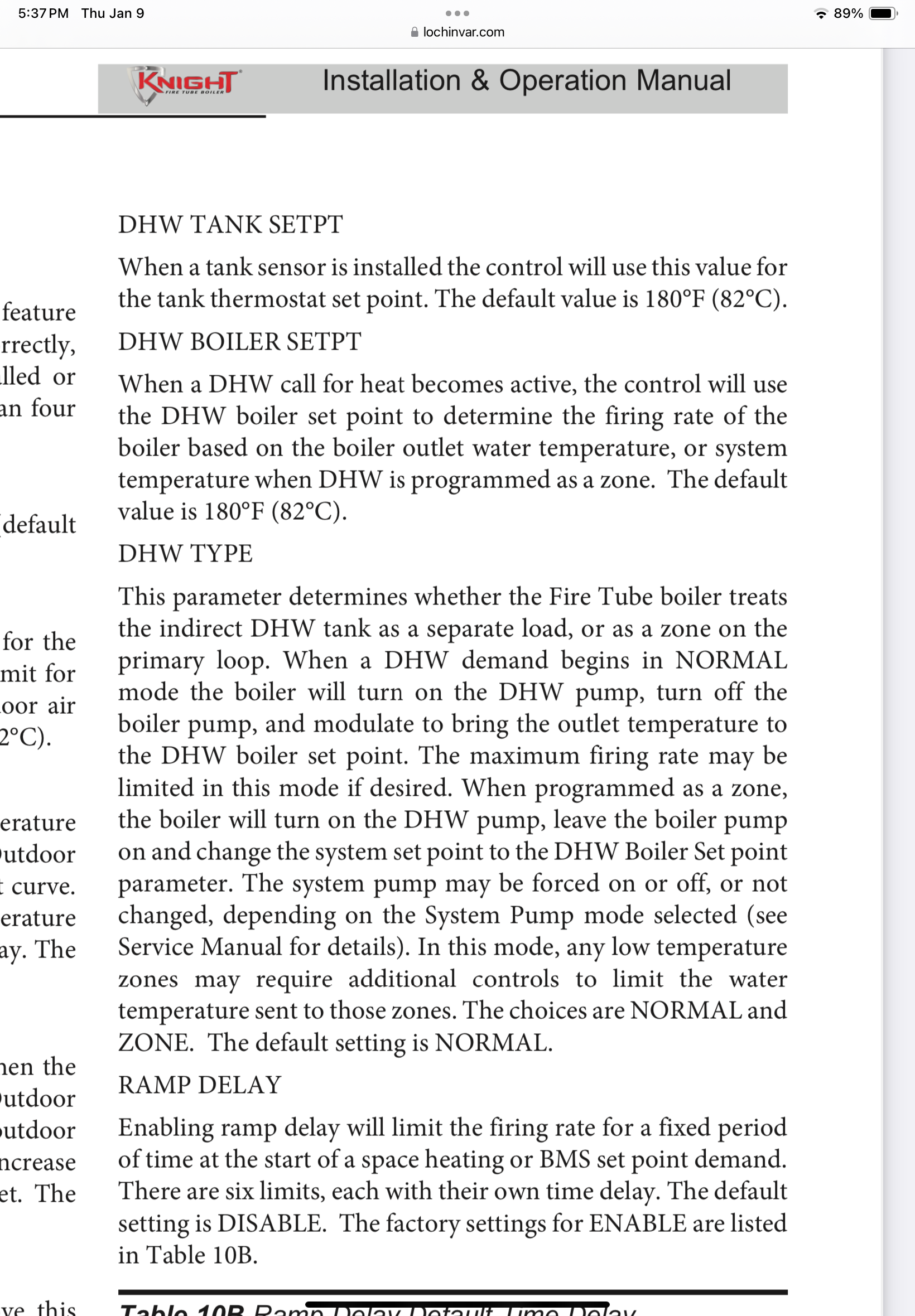

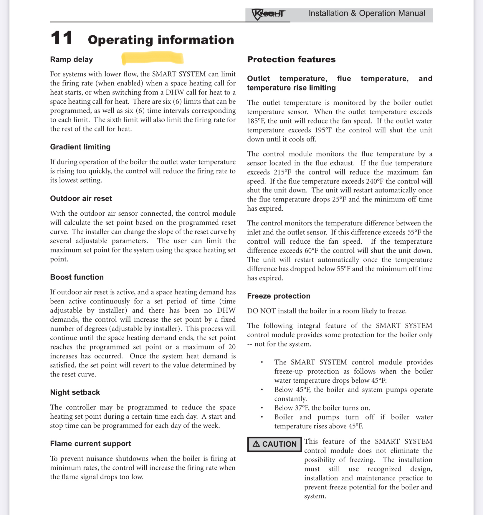

    hot_rod Posts: 28,708
    From the manual, the ramp delay allows you to limit the 6th final ramp output.
    So maybe start with 5 minutes on each step, put the last one to 50% or whatever you want to limit the max firing rate to.step 1 10%, step 2 20, step 3 30, step 4 40, step 5 50% and whatever you need on step 6, maybe 60%
    This first
    https://www.youtube.com/watch?v=6WTdTwcmxyo
    The password to access to the installer access comes from this song. 5309
    It is easy to get kicked out of service mode, until you get the buttons sequence memorized, so the song keeps the 5309 in your head, to jump back in.
    In this section you will find the ramp delay parameter. The factory default once you enable this parameter are 15, 30, 45, 60, 80, 100% 2 minute on step 1, 1 minute on the rest.
    You could leave the time intervals and just change the ramp %. End up on step 6 at the % you want.
    Page 60 of the I&O manual explains the settings
    Page 25 in the Service Manual has a graph showing the ramp delay setting intervals. I made notes right on this graph of my settings
