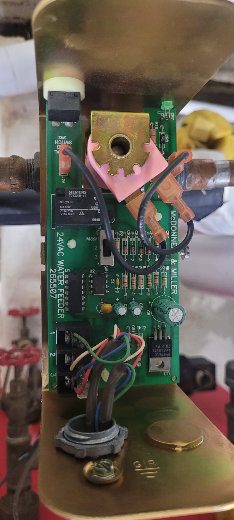

    Silkey Member Posts: 25
    edited March 2025
    Just cleaned the Wye filter in the Autofiller, hit the manual feed button a few times, and opened and closed the manual ball valve a few times. Hopefully this cleared any debris.
    Opened the Union after the Autofeeder and that seems to be the source. The manual shutoff doesn't have any unions.
    Does the whole unit need to be replaced? First glance is $300.
    Steamhead Member Posts: 18,803
    The valve assembly on that feeder can be rebuilt. If you tell us where you're located, we might know someone who can do this.

    Intplm. Member Posts: 3,129
    Im not sure but does that unit have a 'Dwell time" selector on it? Doesn't it have some dip switches that could be selected and possibly correct what's happening?

  • Long Beach Ed
    Long Beach Ed Member Posts: 1,843
    If the valve isn't closing tight, a rebuild kit should solve your problem.
    delcrossvmattmia2
    mattmia2 Member Posts: 17,902
    Looks like a slide switch but if it isn't calling in the first place that won't help.
