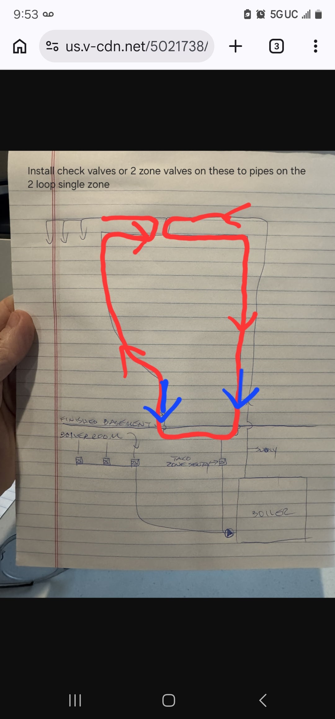

    Sorry I have no way to post a diagram but it's a typical split loop zone as far as I can tell: The supply from the boiler leaves the utility room and continues out in to the finished basement. The split loop zone in question has two returns that come back to the boiler room from opposite sides and head toward the new zone valve. After replacing the zone valve, I refilled and purged the air out of the boiler. When I turned it back on with that zone off and only the second floor zone turned on, the pipe from one side of the split loop warmed up slowly and then went past the point where it would normally flow down toward the closed zone valve and continued on toward the other side of the split loop and heated that pipe!?

  • Hey Hot Rod, sorry for the delayed response, long day. Believe me when I tell you that there’s not a bubble of air left in that system, it’s completely purged. Below is a sloppy diagram of the split loops zone in question.
    I can’t access any of the piping in the finished part of the basement but was considering splitting the two sides of the split loop with a second zone valve and thermostat

    hot_rod Posts: 28,699
    you want to avoid bullhead tees on hydronics. The flow is very unpredictable. Use the run and branch of the tees as shown in my chicken scratch.
    Ideally the pump on the supply of the boiler after an air purger and expansion tank, "pumping away" from the expansion tank.
    I like ZVs on return to prevent ghost flow. One shutoff/ purge valve on the return for ease of start up purging

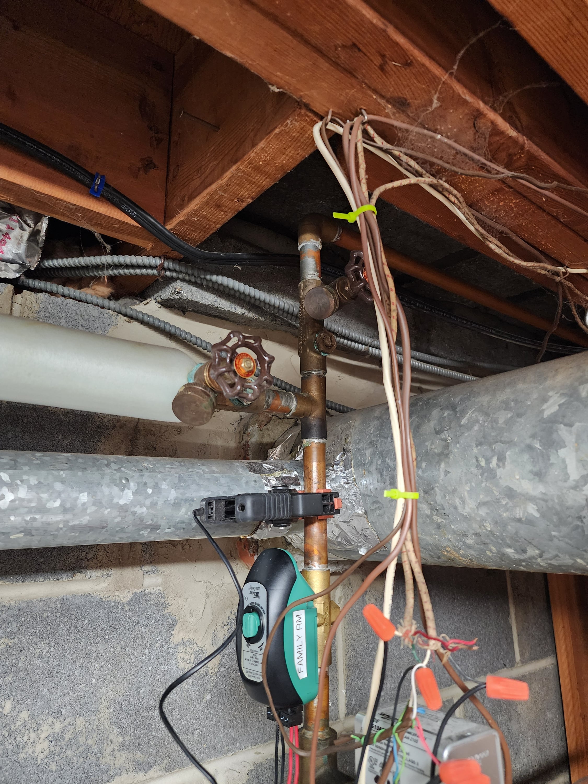

    Picture of actual system at this residence. Confirmed ghost flow not going back to boiler. Flow is going thru the loop. Solution is install 2 check valves on the return loops.
