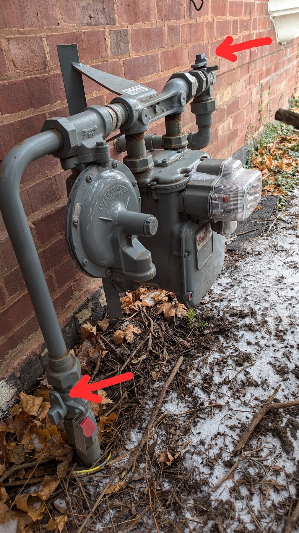

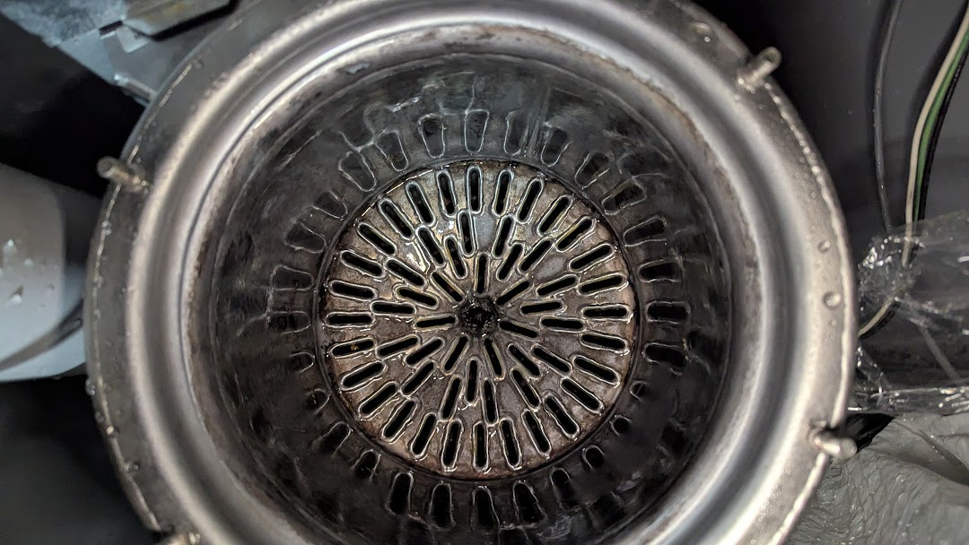

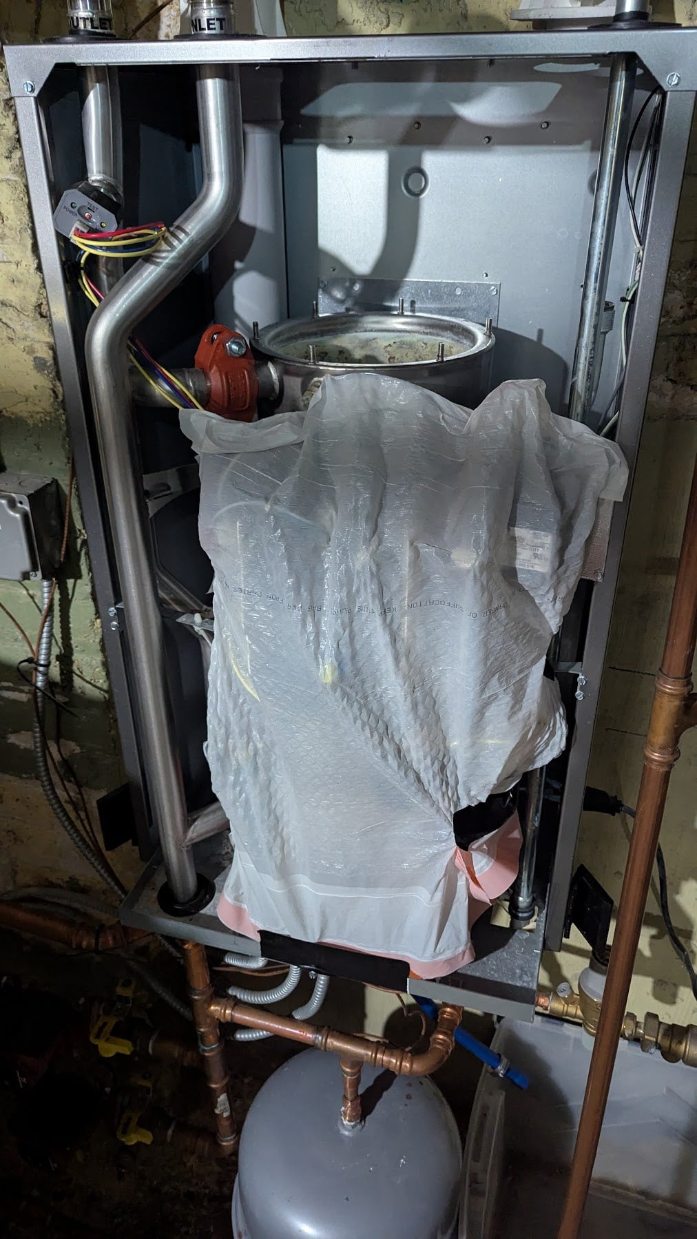

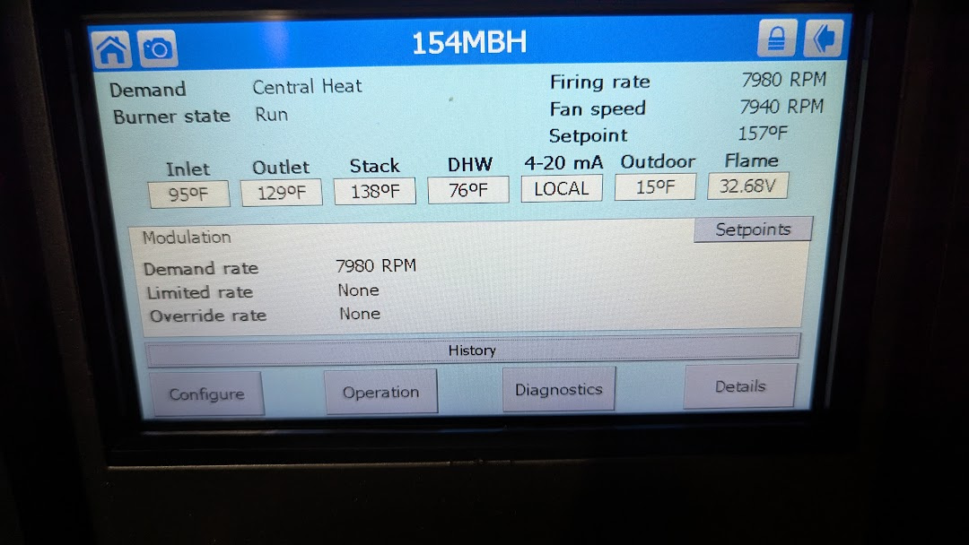

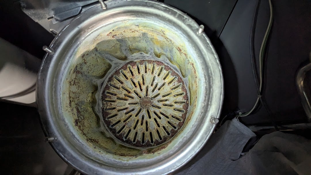

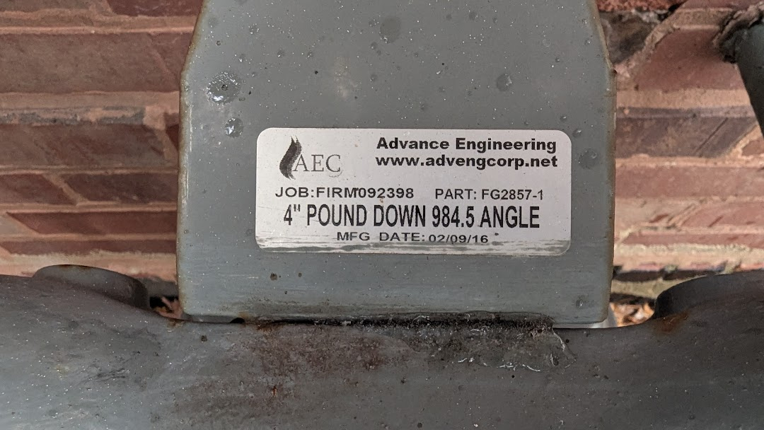

    Thank you for your input! I arranged to clean the HX this upcoming weekend but the boiler made other plans. At 11pm last night (15°F outside in Chicagoland area) I got a notification from my HomeAssistant integration that the thermostat temp had dropped beyond the lower limit (69° -- temp set at 70 with .5° swing). Same error alerts and lockout 109 but this time when trying to start up, the flame sensor would show proper ignition for ~3-10 seconds then dropout. No bandaid adjustments helped so I made a cup of coffee and got to work (following THIS instruction set and THIS video).
    After careful disassembly and thorough cleaning of all components I am relieved to say that by 4am I had it all back together and the system fired up immediately. With testing the manometer now reads ~6.5"wc at full modulation! The display is showing the flame sensor value at a steady 32.68V (not sure why as volts) when before it jumped around the 22-25V range. Lastly, I dialed back the throttle screw to its factory default and made an appointment for a combustion analysis for Monday.
    Below are a few pics of the before/after as well as the gas meter on the outside of the residence. Are the arrows meant to be adjustable to address possible supply issues? As a relatively new homeowner I'm very curious about all these systems I've been blindly unaware of; thank you all again for the insight!
    109A_5 Member Posts: 4,203
    Just FYI " The gas is supplied from the street and there are no regulators on the line making adjustment not possible. "
    This is the regulator.
    Hopefully when its all tuned up you will be problem free for a while. Curious, when you get the combustion analysis done how close were you.
    Your Red arrows point to the On-Off shut off valves, they are just On or Off.
    The flame sensor voltage is probably just the voltage drop across a fixed resistor, if you knew the value of the resistor you could calculate the current. The value of the current is more typical with other heating equipment.
