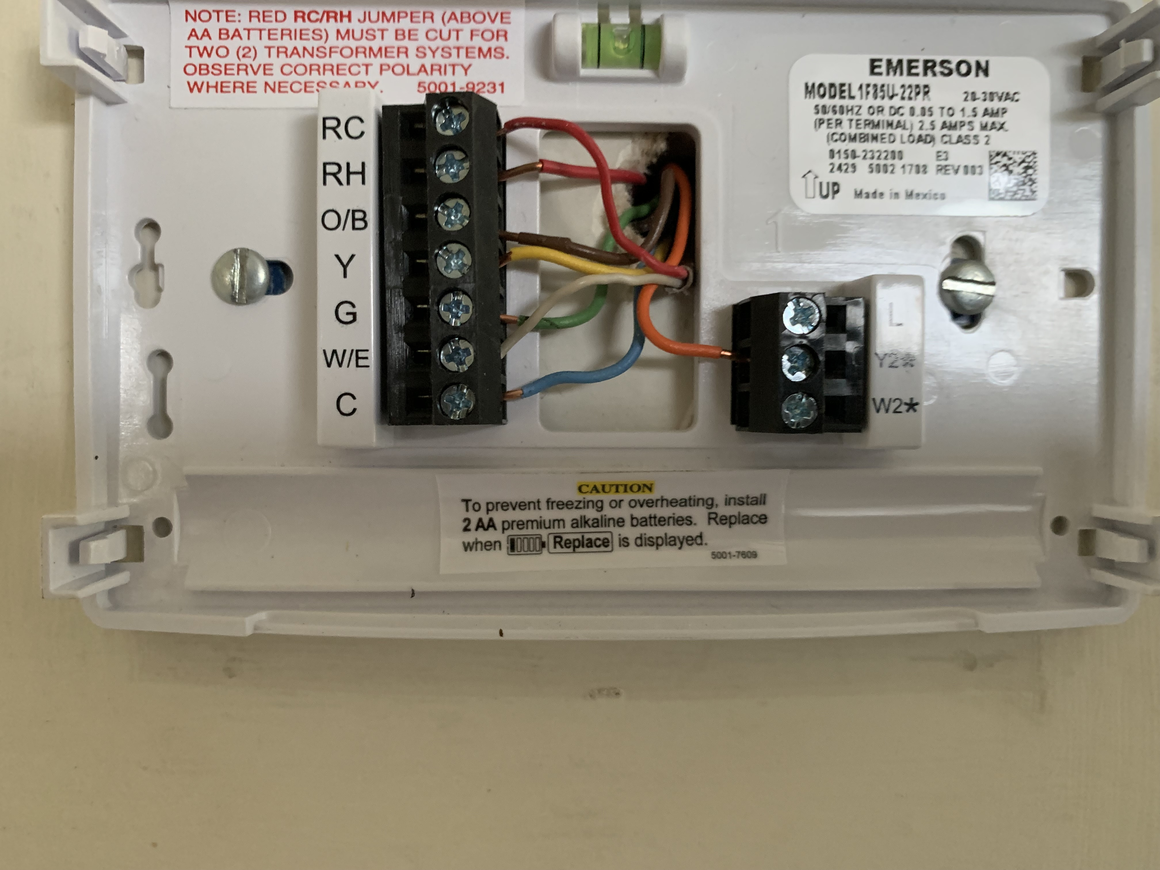

One of my customers added forced air to an existing radiant system and the contractor installed one thermostat to control both systems, the radiant being the “Auxilliary” system.
The problem they are having is when they just want the radiant heating, the FAU comes on as well.
Is there an installer setting that could correct this?

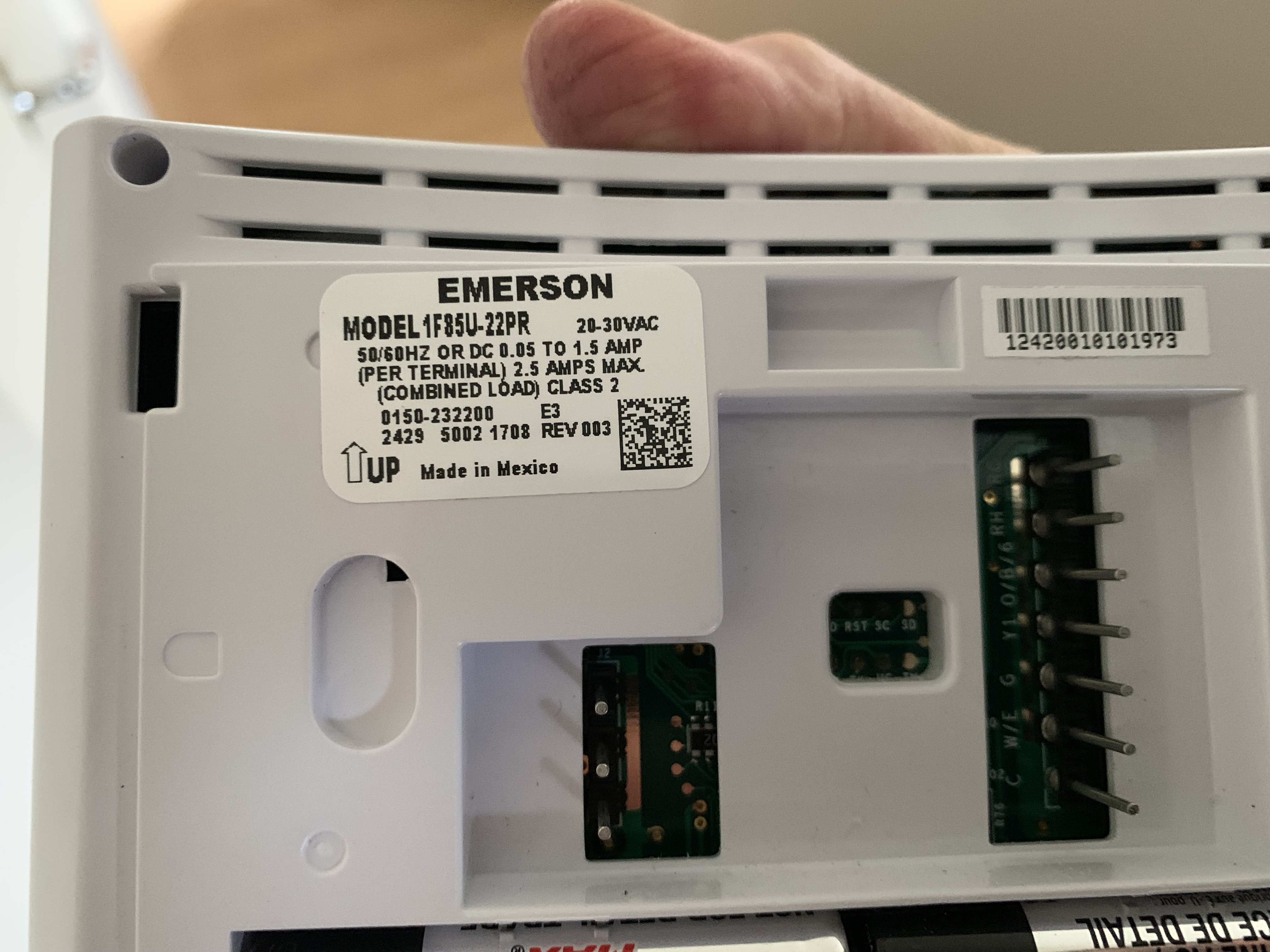

    Looking at the manual, it appears that this thermostat cannot operate the two systems independently. The "auxiliary" system will engage when the setpoint is 3 degrees above the current room air temperature. At that point, the FAU would engage. I do not see any possibility of operating the two systems independently.
    Of course, if they don't push the recovery too far, the FAU would not engage.
    HVACNUT Posts: 7,846
    It looks like a heat pump. Unfortunately any thermostat set up for heat pump, the auxiliary can't become the primary.
    One option would be to program the thermostat for 2 Stage AC, 1 Stage Heat. If the reversing valve is energized in cooling, jump R and O, or Y and O at the condenser. Then of course the radiant is the only heat source, and that's probably not why they purchased a heat pump.
    Seperate thermostats might be the best way. There's obviously no floor sensor, so if the radiant thermostat is at 70°, the heat pump thermostat could be set to 69° or lower.

    You could use a 3 pole relay to disengage the G & Ys when the radiant heat comes on.

    I think @ratio has the right solution. If you want floor heat priority, you can also move the floor heat to W1 and the air handler to W2 and Aux. You would still need a normally closed relay to de-energize G when W1 is on.

  • @EdTheHeaterMan They want door #3
    From what everyone has said, I think the easiest solution is to have two thermostats. There’s a closet behind this one and it would be relatively easy to mount one in there although it won’t get the same airflow.

    If they don't want to use the heat pump for heating at all, just set up the thermostat as conventional & jump the reversing valve and the compressor call together, or just tie the reversing valve on to the R to avoid the sounds it makes when it throws. I think someone mentioned the same thing earlier, but this is all my idea.
    EdTheHeaterMan Posts: 13,052
    edited December 2024
    Remove Rc Rh jumper
    Wire heat circuit to Rh and W
    Program thermostat to AC only in the installer menu 05
    That should give you the result you want. No special relay or wiring needed.

    Unless it's a B valve, you're going to want to energize it…
    I didn't think of that. By switching from HP on installer menu #5 to AC, the O will not energize in cooling mode. That can be fixed by connecting both Yel and Org wires to the Y on the thermostat. @HVACNUT might call that a MacGyver adjustment.

    Was the radiant thermostat a ts87 or can you send a picture of it?, if it is still laying around somewhere
