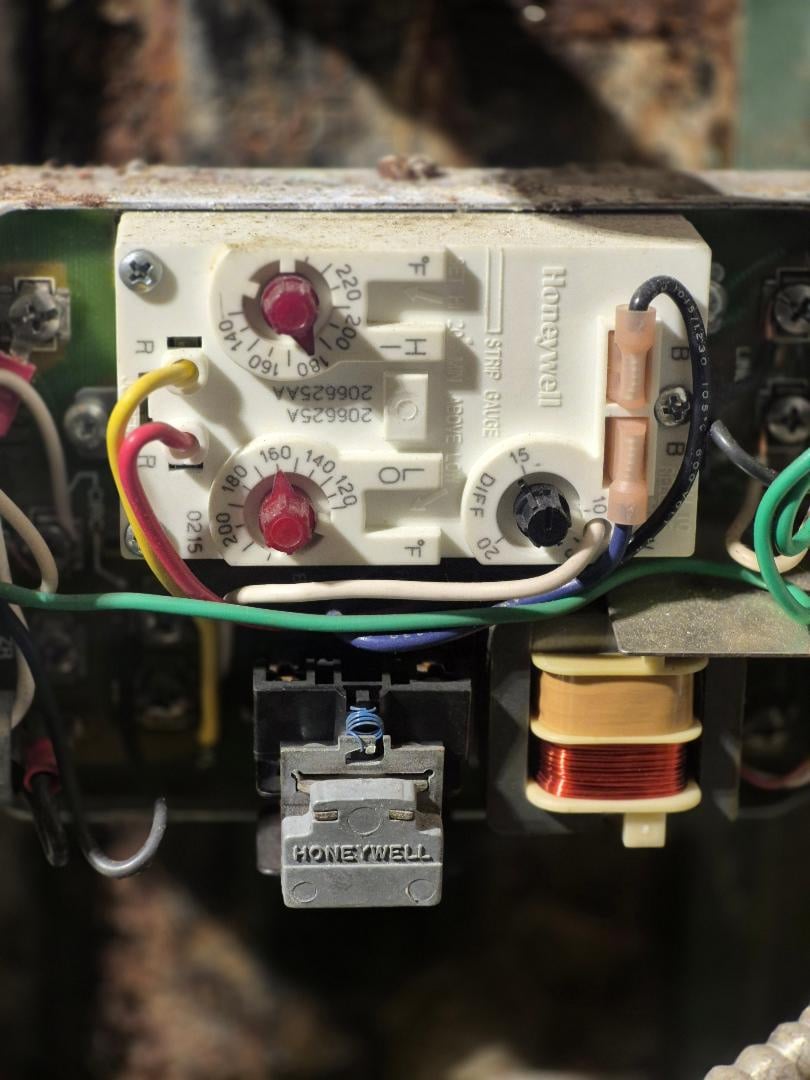

    Im having the same issue in PA. I have New Yorker Oil boiler also. I need it to stop cutting on to maintain the hot water. I already have an electric hot water heater. I need to know how to stop the hot water also. I need help also

    Which aquastat do you have on your boiler? Newer ones you can change the settings. Older ones you can either get a modern one, and take advantage of newer features, or modify the existing one (not recommended). Or you can get a high limit only aquastat.
  • leoking
    leoking Posts: 2
    This is a picture of the Aquastat I have. Should I get a newer one?
    HVACNUT Posts: 7,784
    What model boiler? If its a steel boiler, you can set the HI to 160 and turn the LO down all the way. It will still fire once or twice a day, but its negligible. Upgrading the aquastat completely will offer better options.
