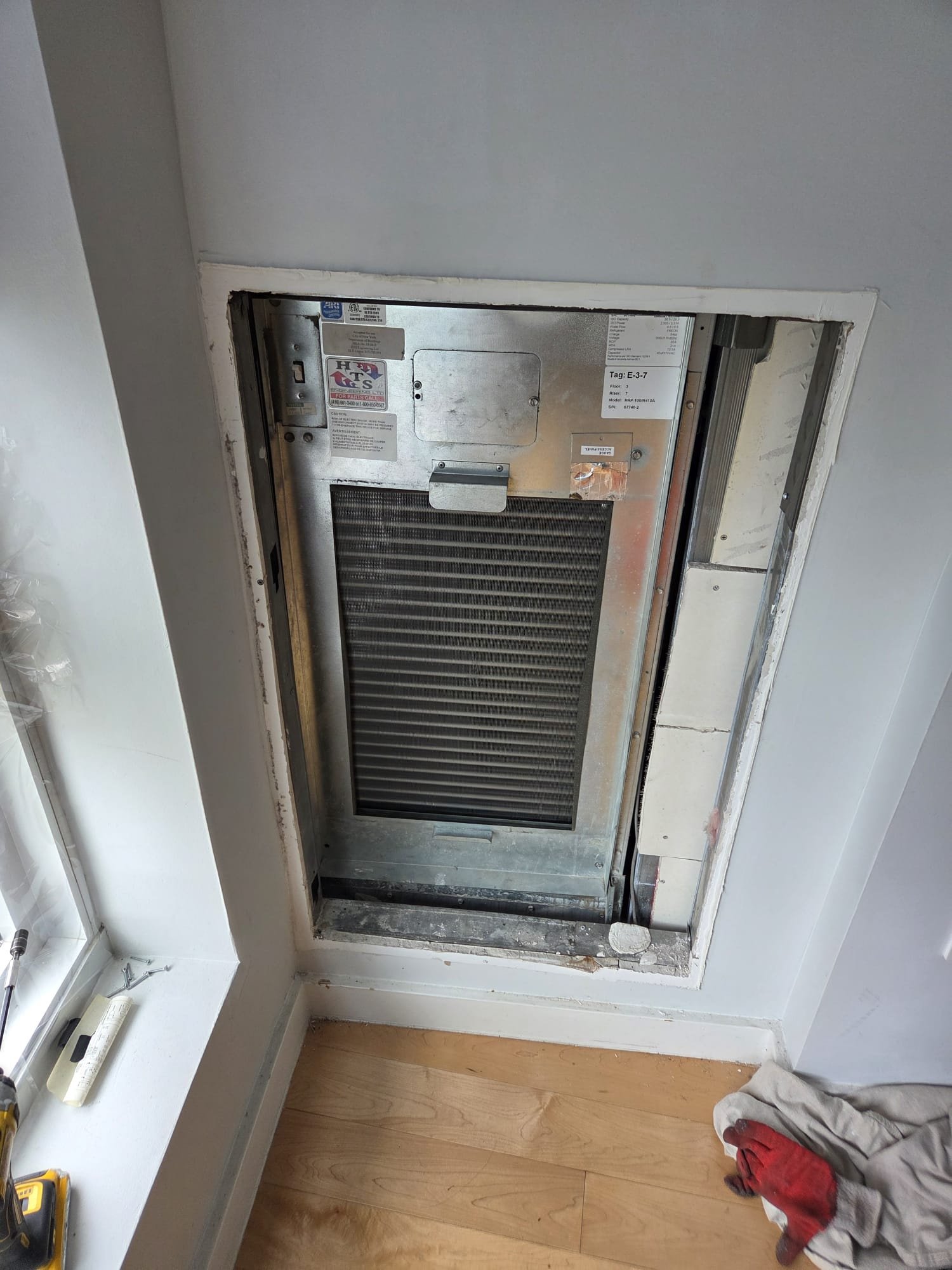

Any leads for a good HVAC company to service Water Source Heat Pumps in downtown Brooklyn? The company that the building recommends has good techs but is pretty poorly run (tons of no shows and last second cancellations). I've tried my regular HVAC company, but their techs don't seem to know anything about WSHPs and I don't really trust them to service our units.
